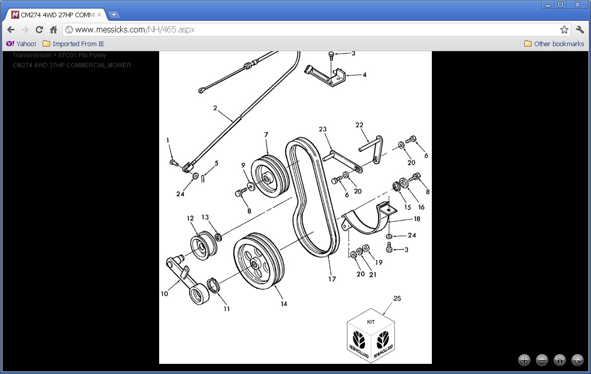

Hi, could someone please advise me of the correct size PTO Belts for Ford CM274 (Shibaura Motor) and maybe the mower deck belt sizes.

The PTO belt set for your CM274 is:
Set of belts: 0.66" wide x 42" long v-belt part no. 86527220 from your New Holland dealer for $40.58 per set. You can find full detailed drawings and the parts you need at messicks.com.
See item #17 in the illustration below.
BTW: You need to know the number on your mower deck because I think it is looked up by itself instead of as part of the main mower.

Hi Builder, Thanks for your email on CM274, good unit, no bearing problems in 18 years. Some belt slippage, no idea on value, too long ago.

Hi Jinman, thanks for info on CM274, very helpful, good website with lots of information, will try fitting the correct PTO belts and see how we go.
