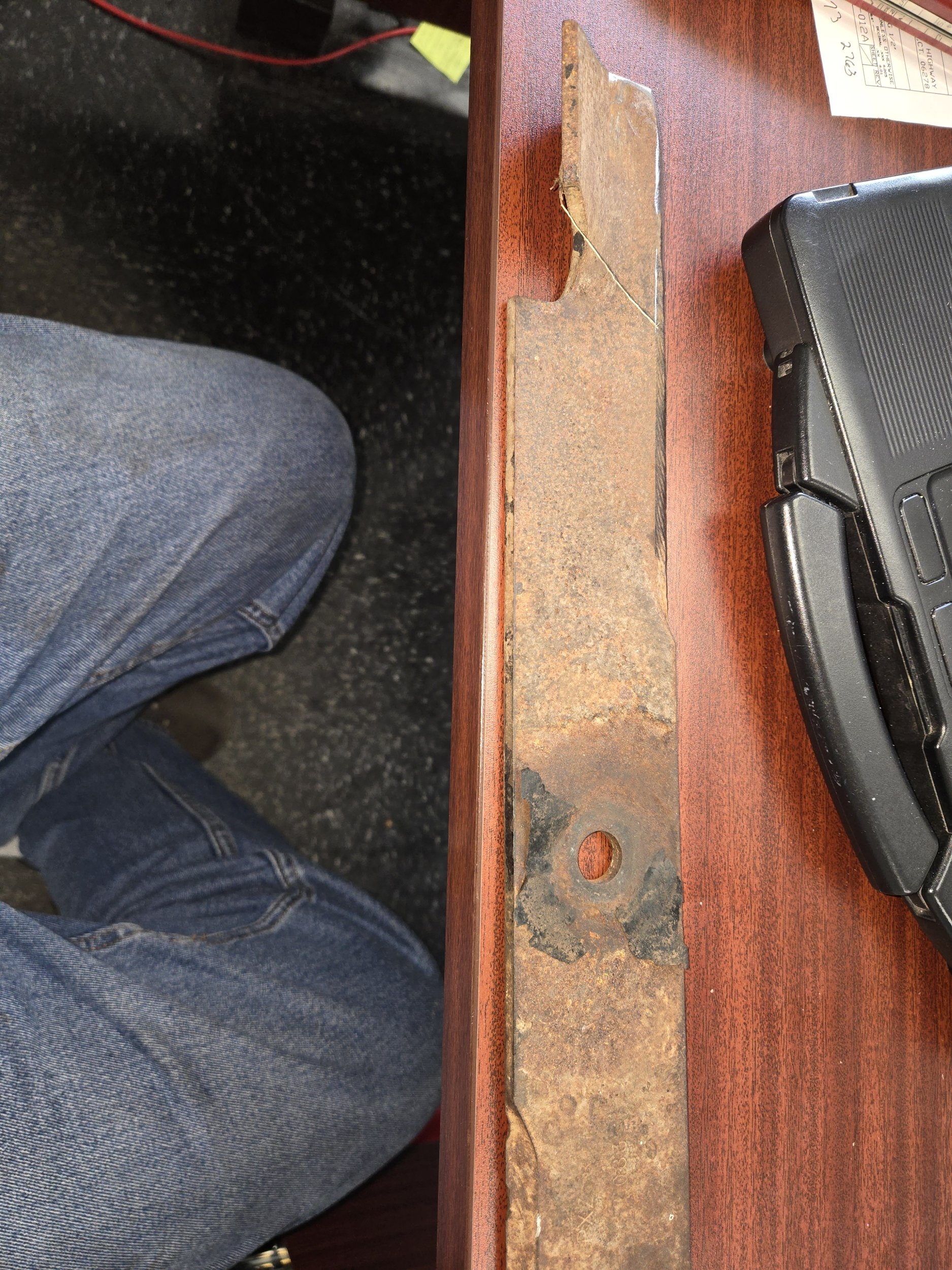

I am trying to find replacement blades for my new to me 930A. I have the blades with me, unfortunately the mower is 30 miles away. I thought this would be a pretty easy exercise but.... The blades I took off, when observing them from the bottom would cut in a counter clockwise rotation. The photos I have seen they would cut in the clockwise rotation. I know they are 2.5 inches wide, 20.2 long, and 1/4 thick. They have a 5/8ths center hole. Can anyone help provide clarity? A photo of the underside of their 930A? Tractor supply part number?

That deck is a lefthanded cut. I have one and use the Woods LH cut blades for it. I got a set from Stens and also Agri-supply. Hope this helps. Woods made this deck for Ford.
   / Ford 930A finish mower blades "60inch" #3
Went and looked at my notes. The Woods RM 59 deck parts are what I've been using. The original deck pan rotted out and found an IH mid mount pan that I welded the pto gear on and been using it for years now. In the process of replacing spindle bearing in one spindle. Only have the operators manual for it.
