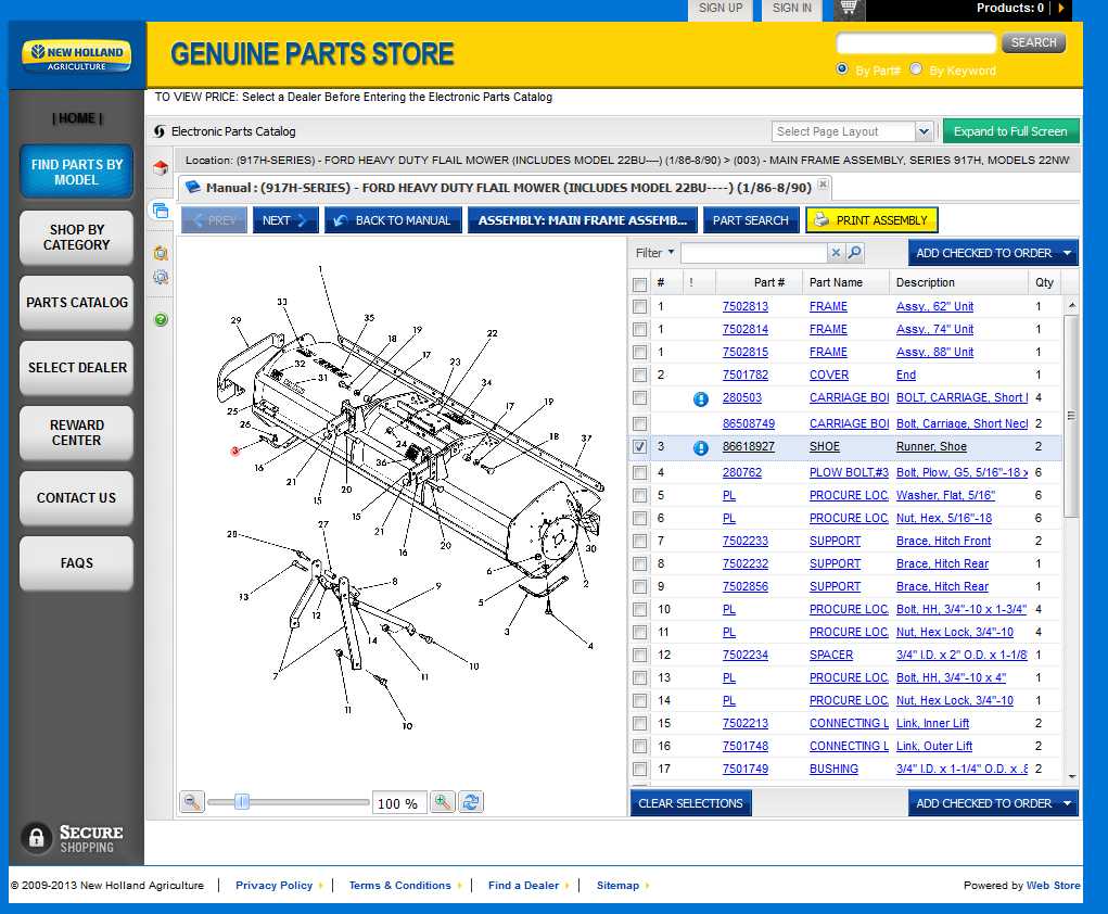

I can't help with an operator manual, but can with the parts manual. Operating is pretty straightforward, parts manuals have the added benefit of visualizing how the thing works. Go to the New Holland Agriculture website, click on Parts & Service - then New Holland Parts Search - then Search by MOdel. A search box will appear, type in 917L. Select 50", then No Description. Should be self-explanatory from there.
Don't know about the 50" L model, but to replace my 74" 917H with the current model (71" 918H) would cost ~$4500. I plan to descale mine with a soda blaster. It's getting cool enough now for that job, I'll let you know how effective it might be. Not sure, but I think the original color was yellow. If yours is green, that means its likely been repainted already. When I bought mine, it was orange. Simpler to respray it the same color. But I wouldn't recommend Rustoleum, as you must follow it with a clear coat - unless you can tolerate progressive paint fade. Go to a farm store and buy implement paint. No clear coating necessary, as it's typically formulated to be UV-resistant.

Was trying to figure out this afternoon if the pre-drilled holes toward the front of the side pieces are for some type of skid rail or other optional equipment. In pics on the net I have not seen anything installed on them so maybe an owners manual would show this information as well.
Again, follow the instructions I posted for the 917L parts list. They're clearly identified right down to quantity and part number(s). They're Ford/New Holland part numbers by the way, not Messicks.

Thanks, I have gone to the New Holland site twice and the parts list will not load on my computer for some reason. Thought something was wrong with the web site but it may be my slow DSL. I believe it will be easier to just to fabricate some shoes than to order some.
