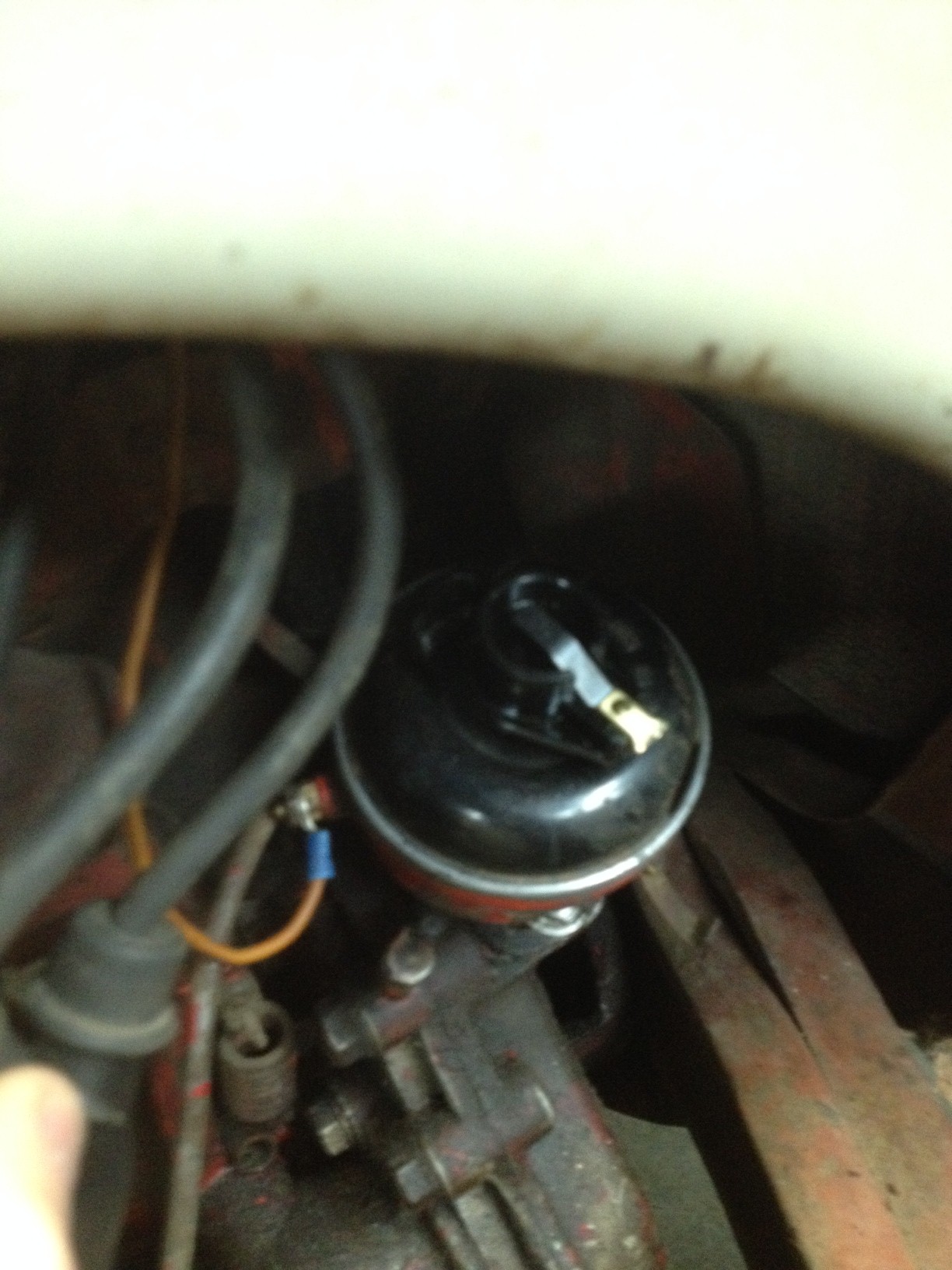

I dont quite understand what you mean by side play. However I found this just a little bit ago. I set the flywheel timing mark at 4 degress BTDC and took note of the position of the rotor button. The first picture is where it was the first time.
I then spun the flywheel all the way around again and reset it on 4 degrees BTDC. The rotor button was at a completely different place. about 90 degreess CCW of the first time. The second photo that I have attached is the picture of that.
what is causing this? How do I pull the dizzy to see if something is wring with the shaft that goes into the engine? Is it as simple as loosening the set screw and pulling?
There seems to be 2 different sets of timing marks. I marked one with a permanent marker, then turned the flywheel. Why would there be 2 sets of timing marks?
I also wanted to add that at both of the TDC marks the #1 piston is at TDC, BUT the rotor is at 2 different places.

   / Ford 8N wont start #9
i've heard of 2 different sets of timing marks..
lastly.. check to see the rotor fits tight on the shaft.. if not it will have lots of slop .. there will be a spring clip under there.
side play is inthe shaft the rotor rides on / controls the cam the rubbing block rides on.. etc...
