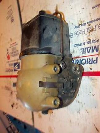

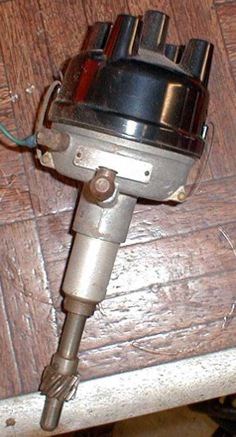

What the two distributors used in 8Ns look like:
