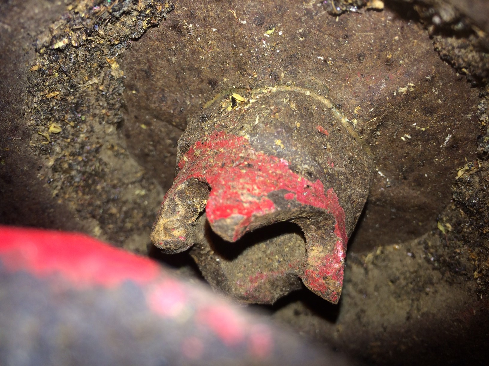

Well, I attempted to get a wrench on the bolt which fixes the pulley to the crank snout and the frame is too tightly positioned in front to do so. I was able to squeeze my iPhone in close enough for a few shots.
The bolt appears to accept a hand crank, but the curved edges are large enough that even if I could miraculously make the frame disappear, I wouldn't be able to get a socket over these edges to what feels like a hex-type connector aft of these curved edges.
The tunnel for the hand crank is way to small to attempt to pass a socket (with a long extension) through it, as well.
Will the whole front end need to be removed to get this pulley off? That seems extreme.

I'm guessing that if you get the pulley tight you're clicking noise will go away as well. Before I did anything I would gently pry with a pry bar and make sure the pulley is loose and not just bent. Is the pulley held on with a bolt inside the cogs for hand cranking?
   / Ford 8N crankshaft pulley wiggle and a clicking noise arising up front #9
My guess is that the pulley is slightly bent. That wasn't uncommon on the N's. As Soundguy said, the pulley is held on with a hand crank headed bolt. The hand crank notches are part of the bolt head. The bolt looks tight. If the bolt was loose, the grease and debris buildup around it would be broken or show a definite crack in the buildup. Besides, if it was loose, the pulley would only slide in and out, not wobble.
I don't think the pulley would be the clicking noise unless it is cracked. I would look at other things near the front of the engine, like the governor or the valve adjustment. Not saying this is the problem, but I would check them.
EDIT: I watched your video and the clicking sound I heard sounds like a valve out of adjustment. Hard to be sure from here though.
Mike
   / Ford 8N crankshaft pulley wiggle and a clicking noise arising up front #10
yup. the pulley is likely bent unless you can reach in and feel the bolt being loose. the old pulley are sheet metal.
look at water pump too!
