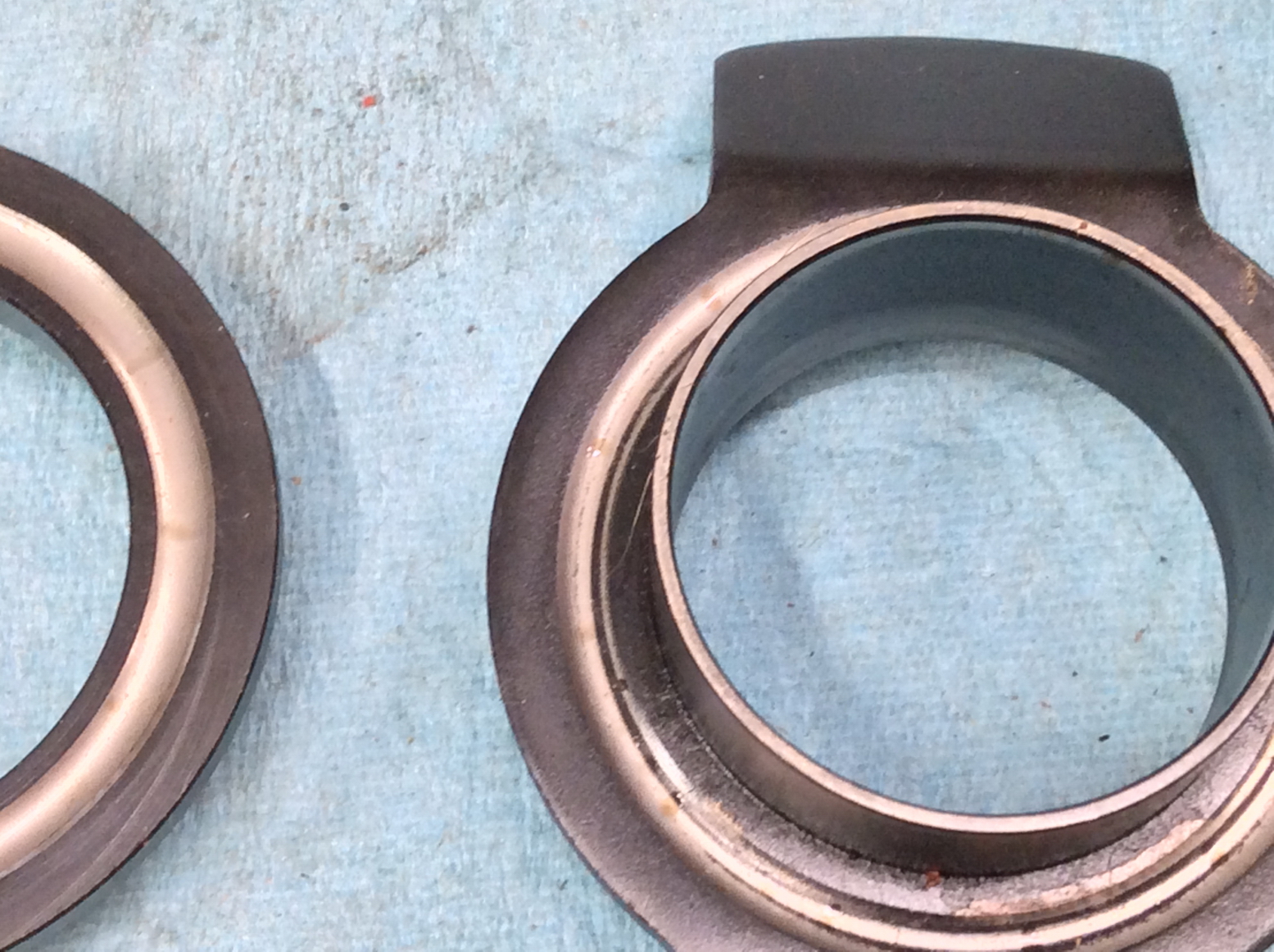

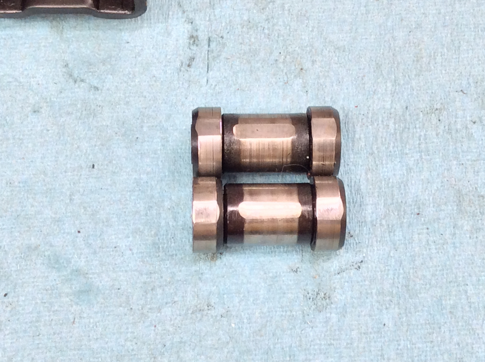

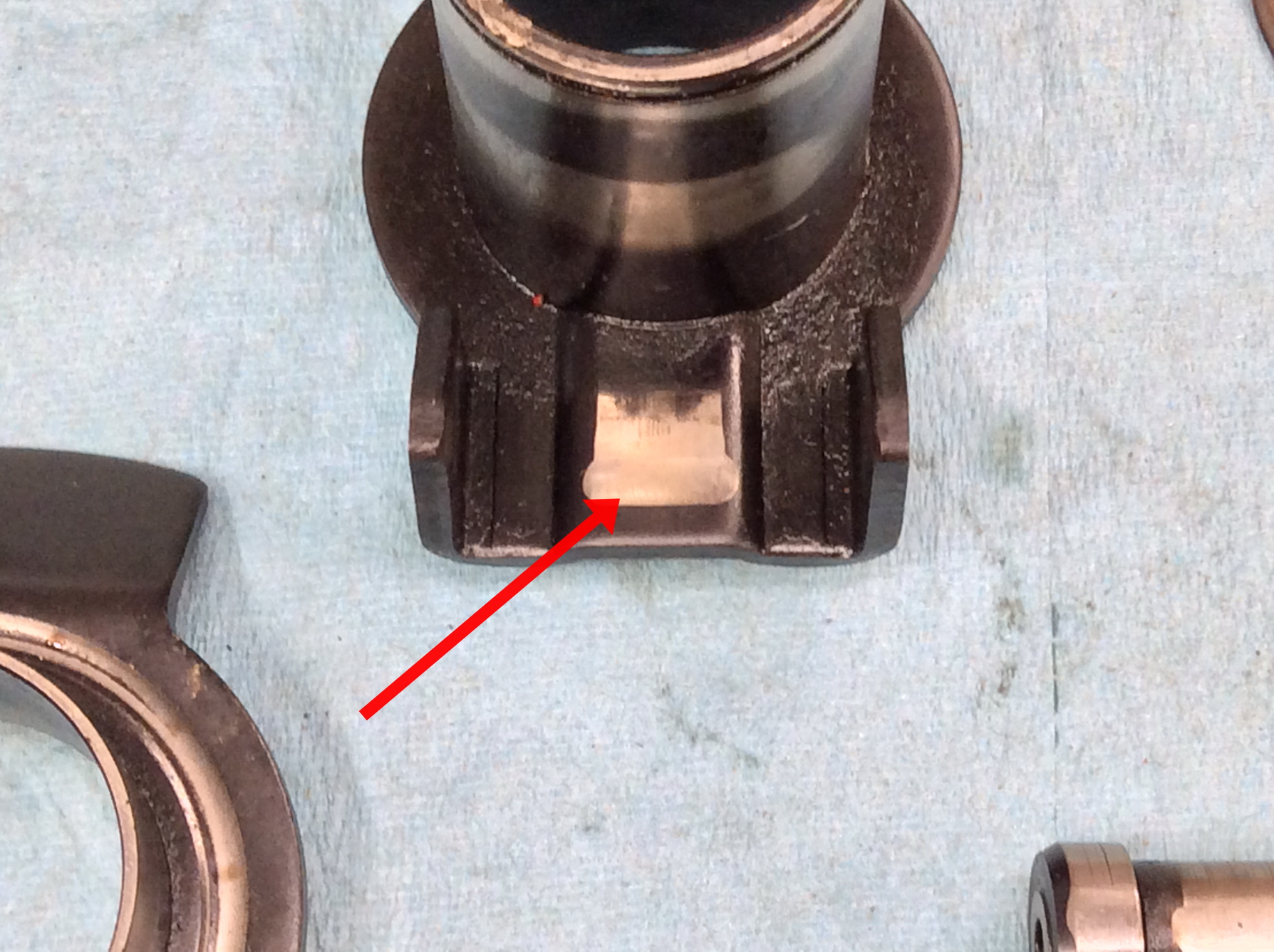

Post update.
I believe this is ultimately a governor issue because:
I unhooked the governor arm to carb linkage, started up the tractor and very gently manually increased the RPM with the carb, and the governor arm, with all linkage disconnected, never moved.
I have the governor removed and will post pics. The governor has many flat spots on the rollers and the bearing has really worn into the bearing contact surfaces.
The only thing I can figure is that maybe the governor was binding. The governor is compressed by tightening the crank pulley and I think it calls for 100 Ft/lbs, and I don't think it was that tight, but I also don't think it was loose enough for the governor to slip on the crank.
Bob W
