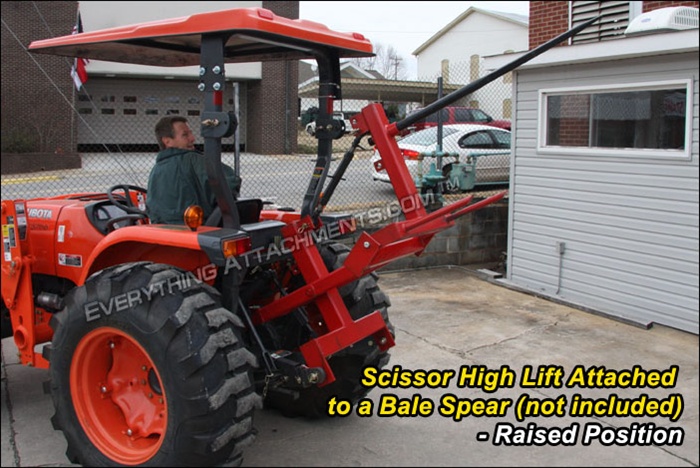

Here is one: Tractor 3 Point Hitch Scissor High Lift, Hay Lift #3F, uses #3F Bale Spear
It does set the bale spear back a lot and would need a hydraulic top link between it and the spear to be able to level the spear, to back up and leave the bale stacked.

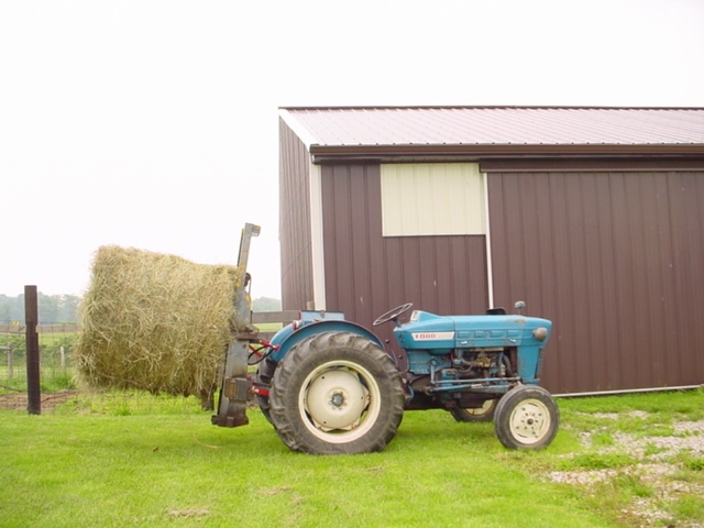

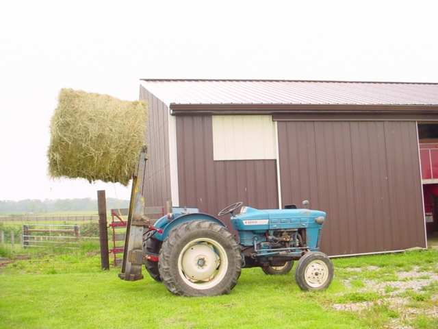

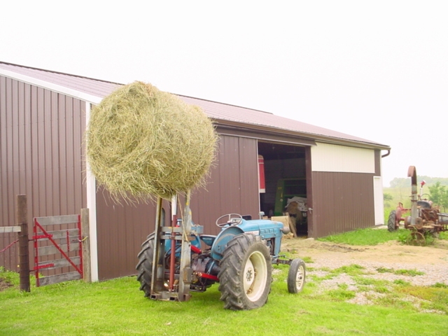

   / Ford 860 with scissor lift? #7
Or maybe find someone with one of these to give you a hand.
Kirk

I dont think the 860 has enough hydraulic power to do that with the 3PH.
In order to double stack bales, you need your 3PH to lift about 3x's higher than normal. That can be accomplished with the scissor mechanism as shown, but at a cost. To lift 3x's higher, you can only lift 1/3rd the weight.
A 860 was rated somewhere around 1200# lift capacity. So 1/3 of that and your at 400# capacity, take off the weight of the unit and bale spear......Unless your bales are 250-300# or less I dont think its going to work.
I agree with soundguy, look for a 3PH forklift. I have seen them in my area from time to time in the $400-$500 range

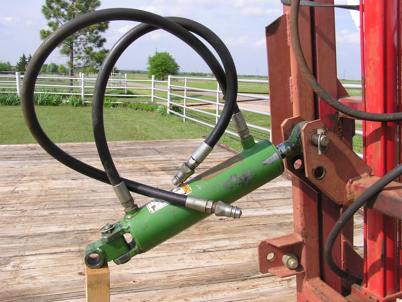

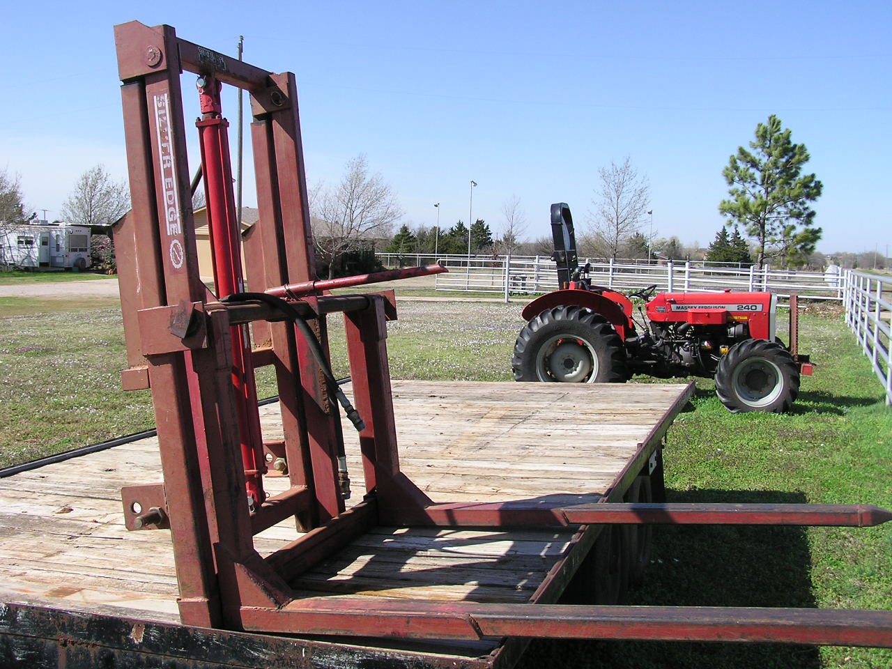

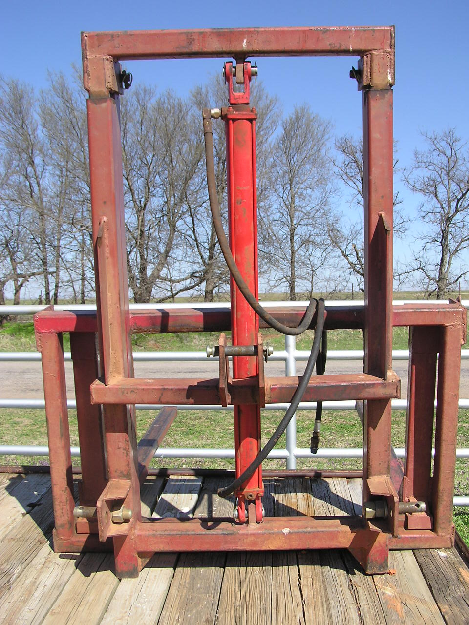

I found a few pictures of the pallet jack I converted to make my bale lift. Lift capacity of the lift itself was 1,000 lbs, so felt it was suitable enough to lift the 580 lb bales my Deere baler makes. I already had dual remotes on it for the hydraulic top link. I kept the forks for it, and still use them occasionally.
If you can find a lighter 3 pt. forklift, as others have said, I'd go that way. Most I've seen around here were pretty heavy, made for 100 hp+ tractors. Or, if you're handy with a welder and can find a small junked forklift, get the mast from it, and make your own.

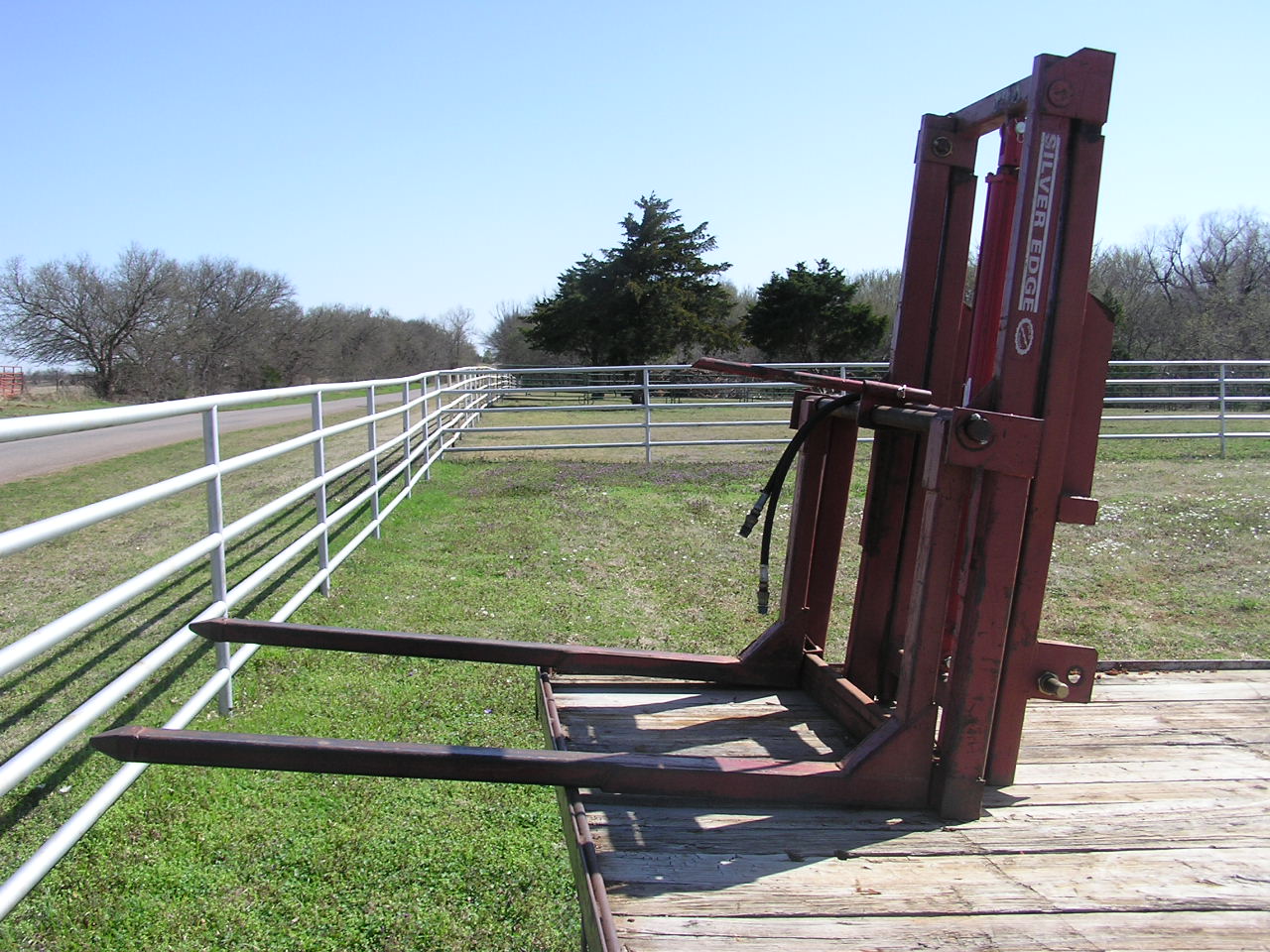

   / Ford 860 with scissor lift? #10

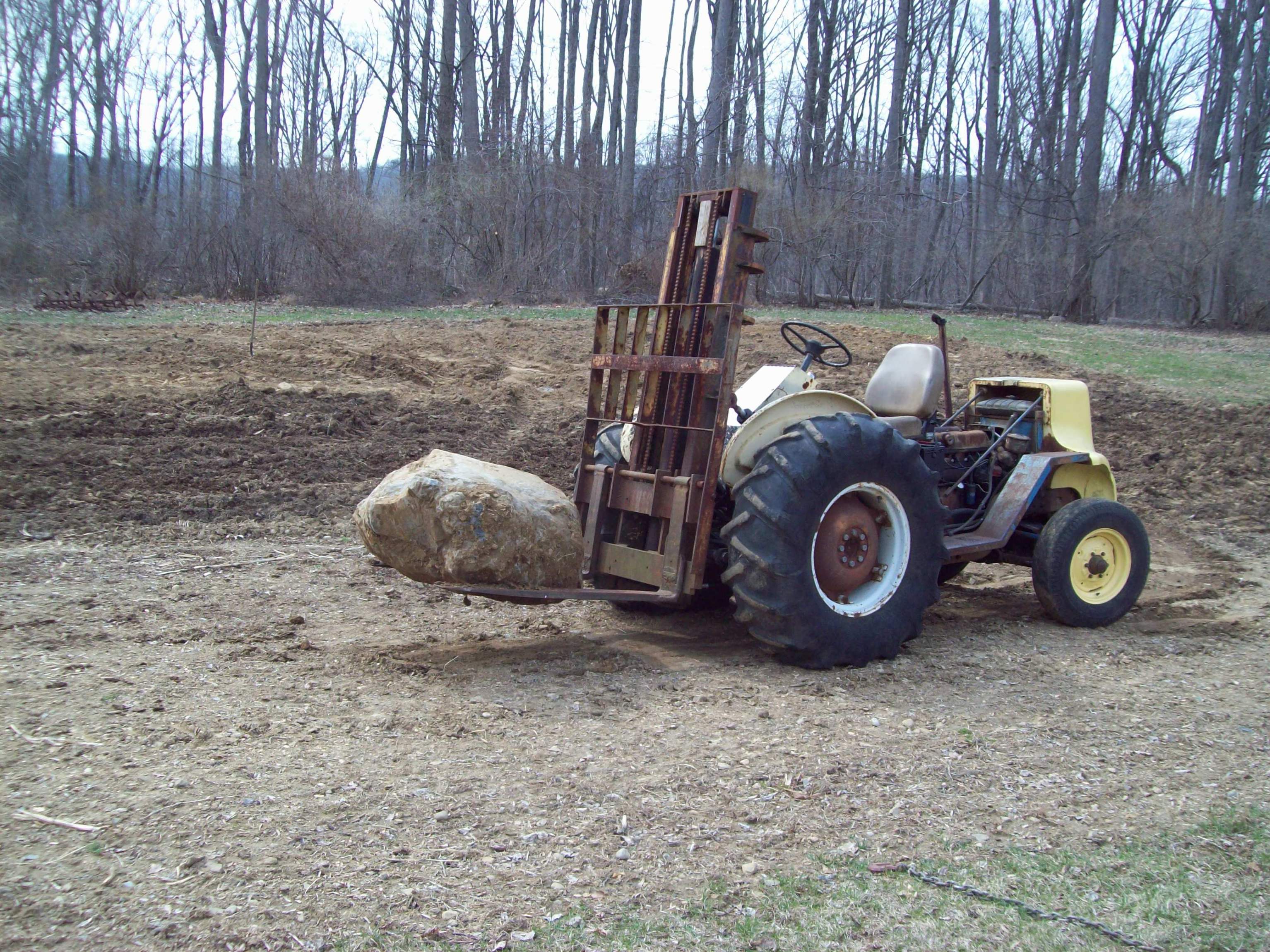

Bought this one at an auction, back when I had a tractor.
