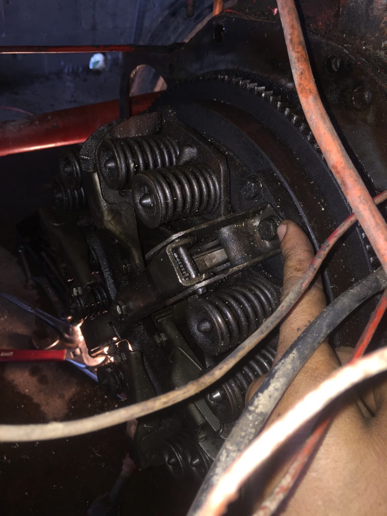

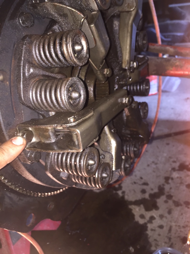

With summer break upon me (joys of being a teacher), I was finally able to break apart my ford 860 with dual clutch. Here is what I found, the two bolts indicated in the pics were either loose or had fallen out. It seems that since they were in this condition, the fingers that they were attached to, were not able to engage or disengage the clutch. Am I correct in saying this? Or do you guys think this was the problem at all. I would hate to put the thing back together only to find that this is not the problem. Image1464820344.752328.jpgImage1464820359.511485.jpg

In my experience this is the point where you put a $ value to your time. Why are the bolts loose or falling out? This is an unusual thing to happen on a properly repaired machine assuming at some point in its life there was clutch work done.
The cheapest route is to clean the loose bolts with brake clean and also the holes and re-assemble using loctitite.
Remove the other bolts and do the same. Re torquing to spec.
However, why did the bolts come loose? When the bolts were loose did anything wear abnormally?
Is the pilot bushing/bearing in the flywheel loose resulting in vibration which loosened the bolts?
Is the flywheel tight on the crankshaft or loose causing vibration and a loosening of the pressure plate bolts?
What is the cost of a complete clutch assembly including release(s) bearing(s)?
If the clutch assembly was under $500 I would go that route to be assured of success as I need my tractor running especially in the winter and further disassembly would allow more things to be checked and verified..
If I did not need the tractor every day perhaps I would gamble on the quick, cheap route.
Good luck!
Dave M7040
   / Ford 860 Clutch Problem? Help!!!!! #10
........ the pedal linkage doesn't move it quite far enough.............
99% of the time it's worn clutch or linkage - but this Ford clutch has bolted-on release arms - loose bolts could definitely cause the symptoms you described!
After running loose for a while, the bolts & holes need careful inspection. Are all the threads still in good condition? Are the bolts long enough for full engagement? If damaged, the holes may need to be re-machined for larger bolts. If in doubt get a machinist's eyes on it maybe. Once it all checks out, reinstall to proper torque using new lockwashers and thread sealant. Good luck, Dick B
