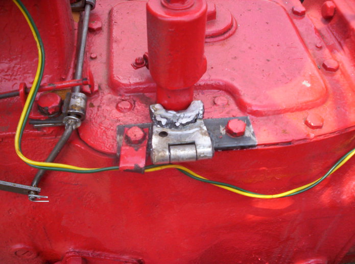

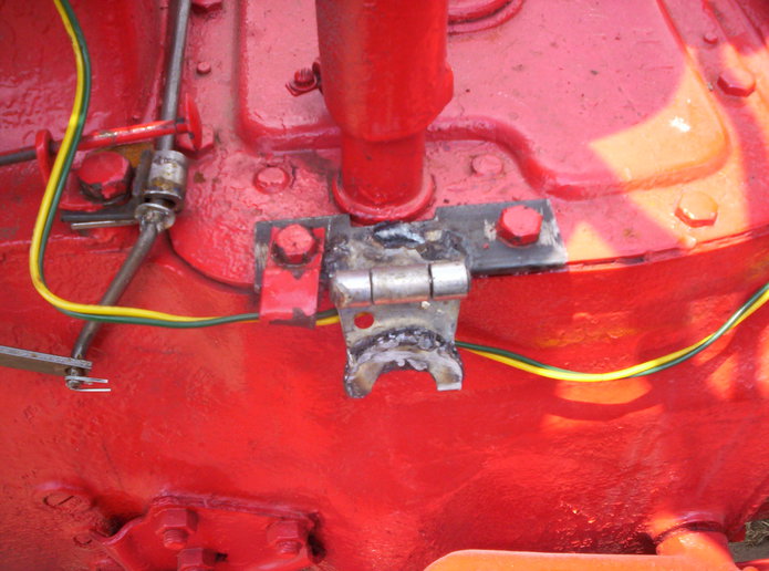

yep.. that 5 speed shift pattern is the same for all *5* and *6* fords.
up with 3/r makes a nice semi-shuttle (unsync) for loader work.
if you don't like 4/5 you can make a flip over lockout using a door hinge.. flip in place then you are limited to the 2 top gates..
i did mine with a piece of a hinge and a washer.. some drill and welding and grinder work. took 5 minutes maybee.
