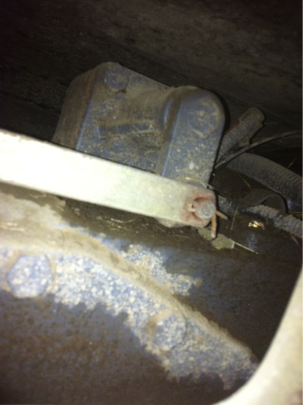

Top cover of 12x12 in worshop today, sorry about angle had FEL fitted so space v limited

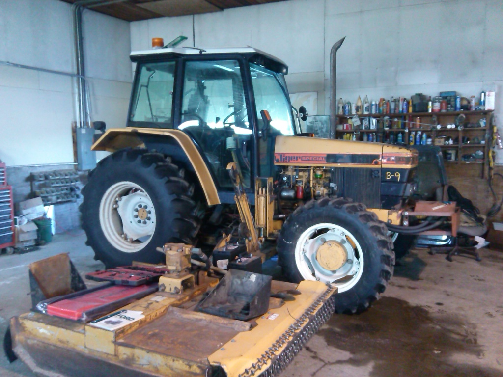

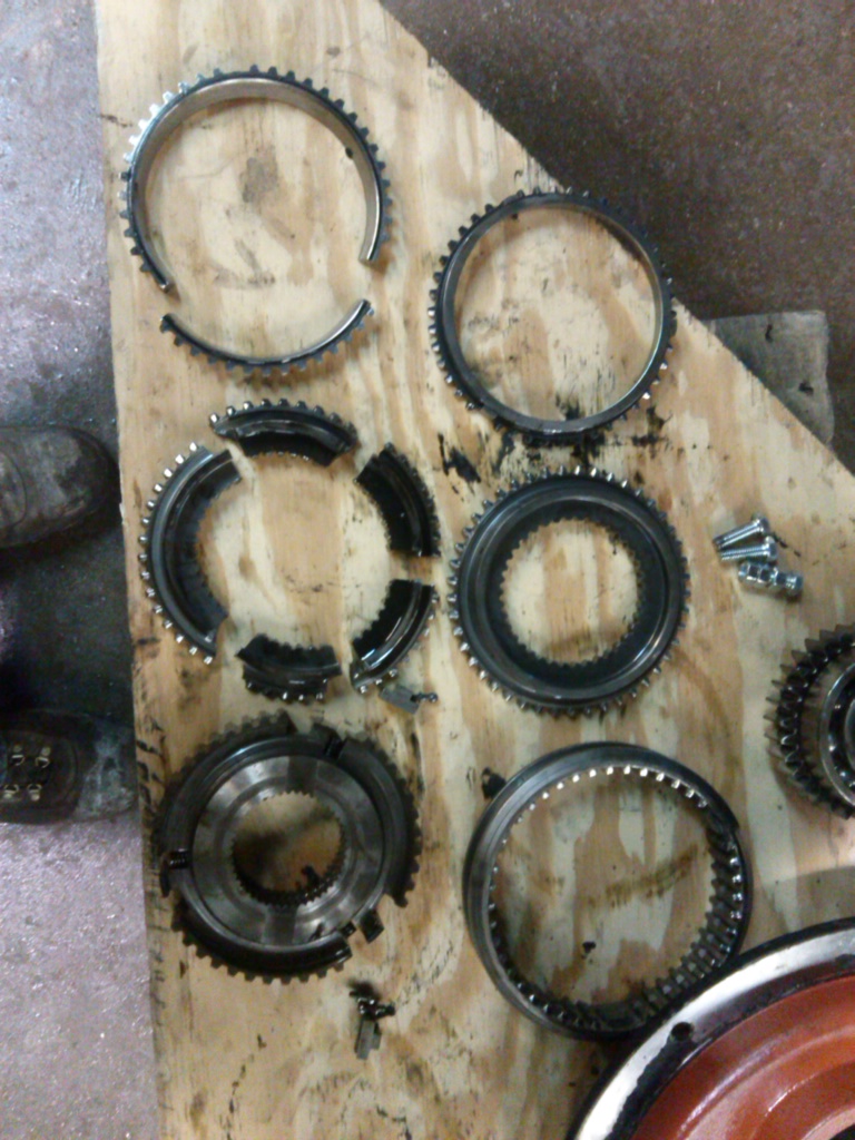

Well finally had a chance to get at the 7740, finished getting it apart last night and this is what I found. Lucky it didnt come apart further I guess. Hasnt been a horrible project so far, the tiger mower deck and brackets get in the way a little bit, but its all doable with them in place. Got the parts ordered and will hopefully start to put it back together next weekend.
