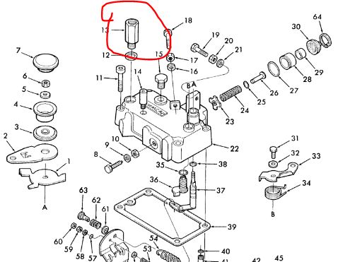

Which type inj pump(inline or rotary)? If rotary check to see if check valve outlined in red is stopped up.

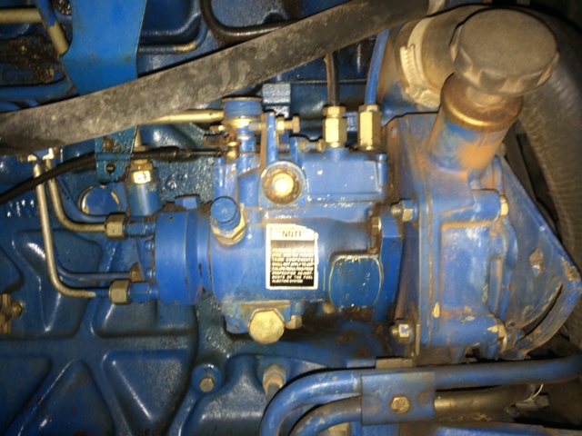

Tx Jim, here is a photo of my injector pump. To be honest, I haven't dealt much with these injector pumps so you will have to confirm what I have. I'm thinking it is a rotary???
I pulled the valve this evening and checked it. There wasn't any trash in it. Looked clean. The ball and spring operated freely. Any other suggestions?

   / Ford 7710 won't run #5
I would suspect the lift pump. Are you using the hand lever on the side of it to prime the injector pump? If so, does it pump well or weakly? Also, check the engine oil, does it smell strong of diesel fuel and thinned out? When those lift pumps go, they can let fuel into the crankcase. Also, if the has the cable operated shut off, make sure the cable is pushing the lever on the injector pump all the way back like it is supposed to.
