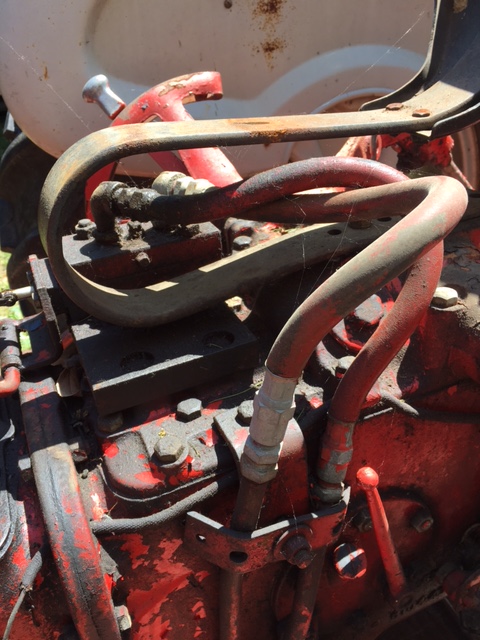

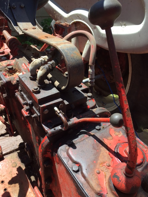

Gents,
Hoping to not spend another Winter where I'll be tempted to use this beautiful Dearborn model 19-3 snow plow again.
Plan is to put the plow and all it's periphery up for sale, to be replaced with a proper bumper to help keep us from even thinking about putting anything back out front again, lol
Ok, so the question I have is: How do I remove the hydraulic lines from where they attach where the lift lever is just in front of the seat and plug or cap the tappings in that valve block (nomenclature?) so as to not cause any damage to the pump or anything else in that valve block?
There aren't quick disconnects, so I'm guessing I could just use pipe plugs for what looks to be 1/2" NPT? I'm just concerned about blowing anything out internally if I plug those tappings and someone moves that lift lever with the tappings plugged.
I guess another approach would be to eliminate that lift lever and vale assembly altogether, but what the heck would I replace it with?
Sorry for the elementary grade question, problem is I've only ever known this tractor to have that plow mounted up front even when the tractor was being used for bush hoggin.
Thanks fellas.
Mel
   / Ford 641 front hydraulics disconnect question #2
It appears you have a dual acting single spool valve that probably runs a single cyl up front..correct?
That's a nice 200-409$ option on your tractor.
Also looks lil short stub hoses come out of it and go to longer hoses. You can remove the longer hoses and add quick disconnects there.
Then when you need a remote... You got one.
And yes, alternatively, you COULD, just plug the ports in your valve block.
Yes, operating the valve with ports blocked will load the engine and open the relief valve much the same like holding the remote open against a cyl at max stroke.
The relief valve will protect the system for intermittent use. Thus accidentally kicking the lever won't hurt.. Holding it against relief for linger periods, however will heat the oil, and load the system needlessly.

Yessir that's correct, single cylinder up front.
Short hoses connect to steel tubing, steel tubing runs up under the chin where short hoses again connect at the lift cylinder.
Quick disconnects sound like the way to go, may never need a remote connection but... Lol

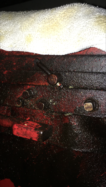

Any idea what this lever and these little 1/8" pipe plugs are for on the right side of the top cover remote?
   / Ford 641 front hydraulics disconnect question #8
the lever could be fast drop to use as single action.. the small plugs are probably just plugging ports where they drilled to manufacture the valve.
#9
Roger that, kinda what I was thinking about those plugs. The lever I figured must be for flow control but was still a head-scratcher. Thanks souNdguy :thumbsup:
