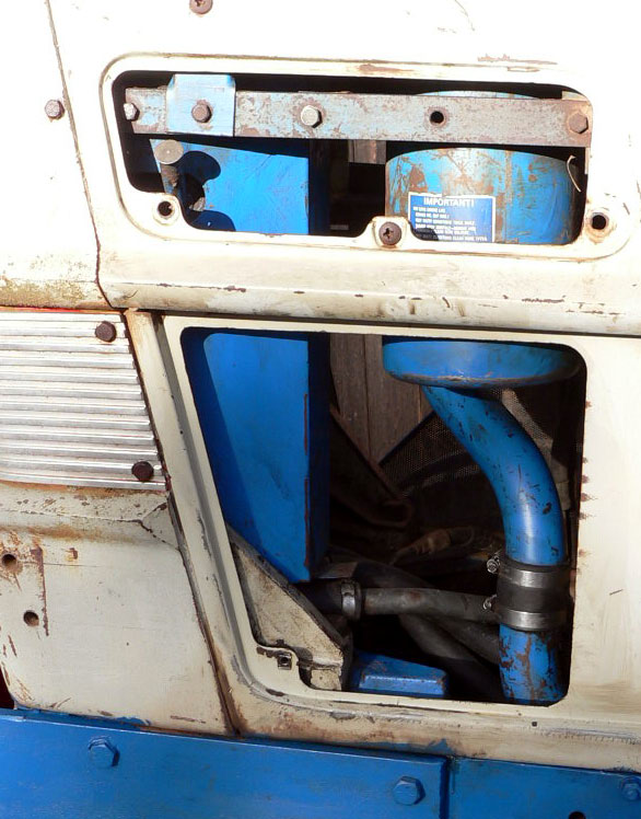

Yes, the local farm machinery dealers agree so I should be OK now for the actual lubricants.
The problem is identfying the correct fill points, especially the hydraulics. The 6000 is unusual because according to the drawings in the IT workshop manual it seems to combine the power steering system with the main hydraulic lines and the reservoir is most likely the one right at the front of the tractor (see picture), not somehere at the back where you would normally expect to find it.
   / Ford 6000 maintenance guide/user manual
Must have hit the wrong button before- picture is here now. According to the IT manual, the hydraulic filler seems to be where the dipstick is in front of the air cleaner oil bath, unless someone knows differently
What I really need is contact from someone who has/had a 6000 and provide specific details. Thanks anyway, Alan

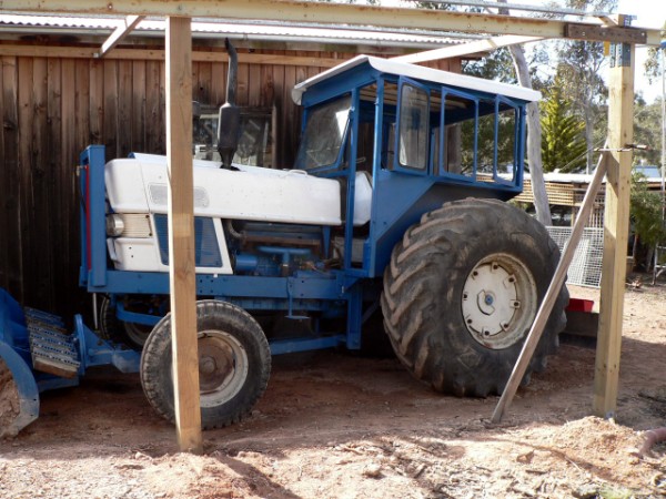

Just wanted to thank Dean Walker of Wisconsin in particular for supplying the information required, also others who contributed suggestions. The beast has now beem serviced - took /2 gallon of transmax in the hydraulic system - all now working well.
For interest, I also repainted the machine (wheels yet to be done) using the Septone brand of quick-drying enamel we have here. They cater to the tractor community with original colour matches like Ford Blue and Fergusson red etc
Put the beast back to work yesterday skimming the roads - all too easy
Cheers
Alan
