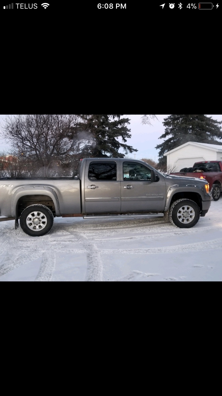

Well I found a smoking deal on a 2012 Denali 3500 6.0 today and bought it. It seems to go decent empty. Can’t wait to tow with it . I averaged 15.5 mpg on the way home all highway. Only thing that is annoying me is the steering wheel wood piece where your hands go? Any one else find this terrible and un comfy IMG_2479.JPGIMG_2480.JPG
