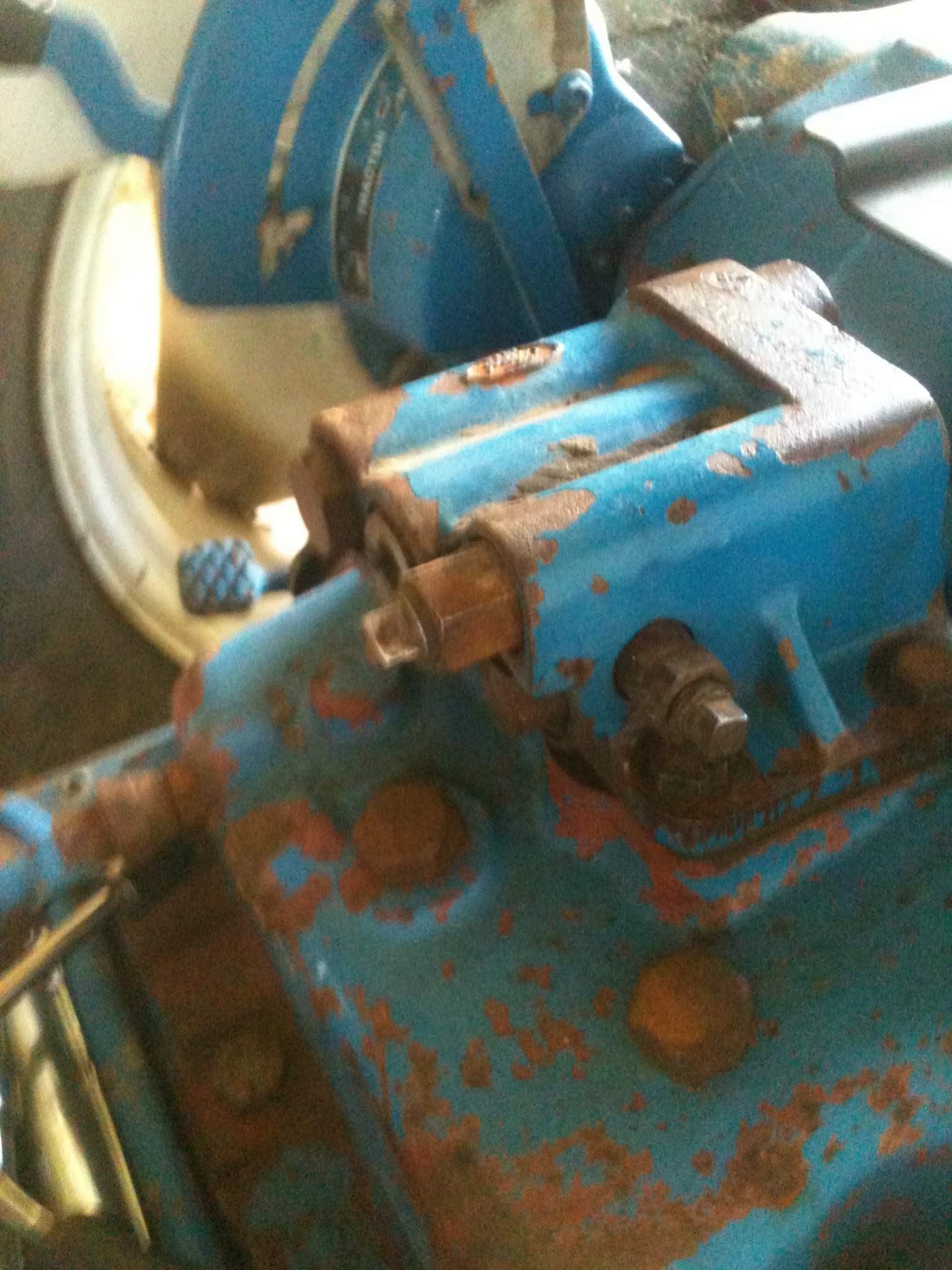

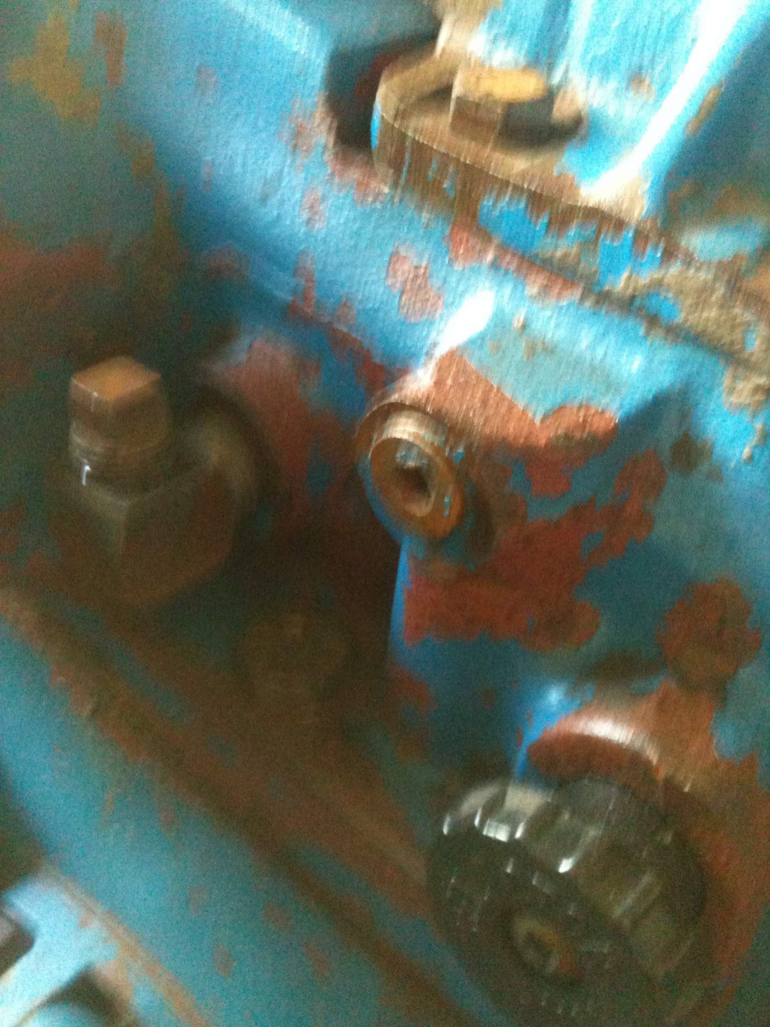

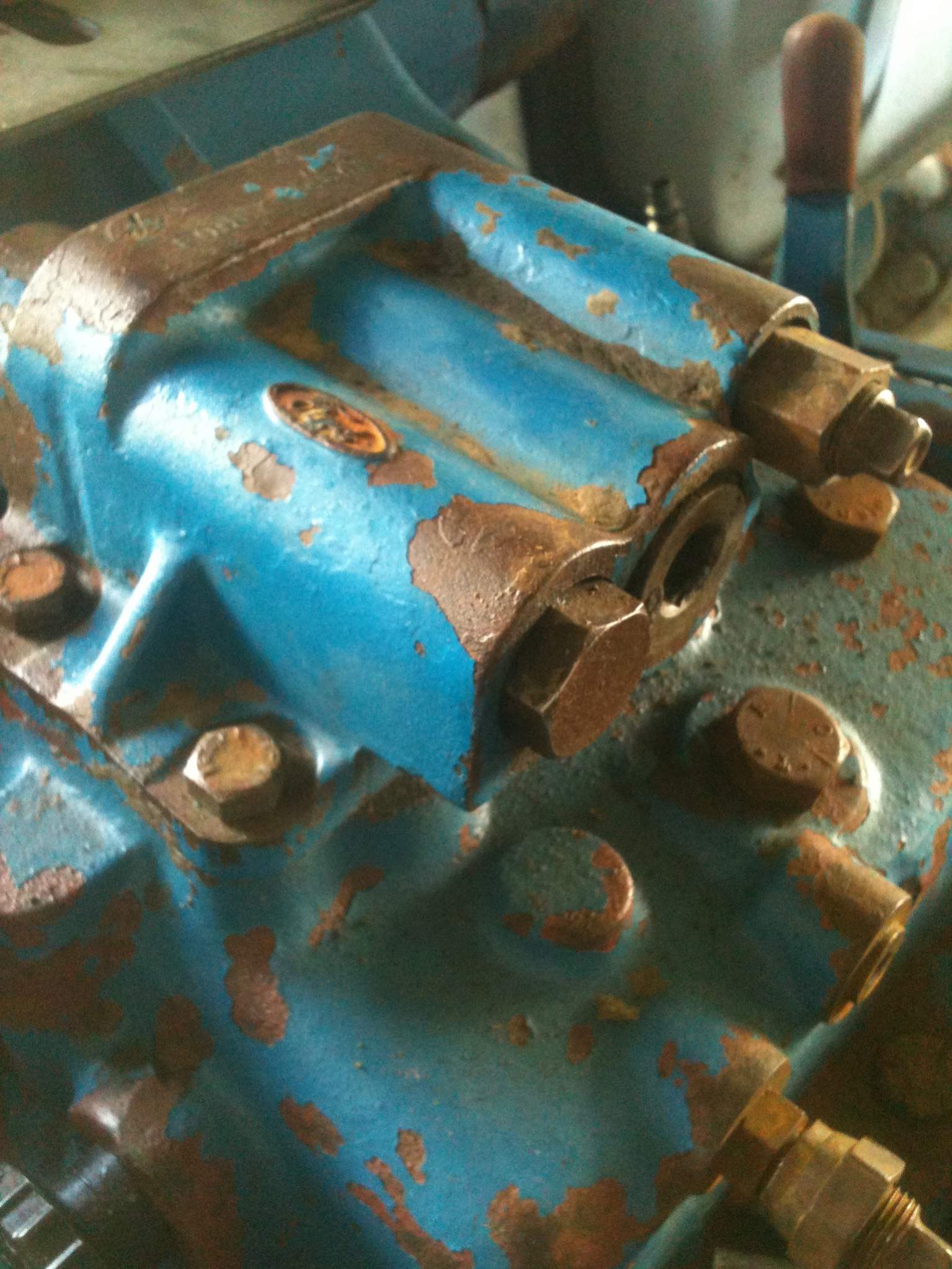

The tractor has had remote valves in the past,I know that by looking at valve under seat,the type hose fitting in the valve and plugs in those. I will say i have a repair manual in route. I need to install at least one remote valve on this tractor,after seeing New Holland prices there has to be another route for me to take.I am somewhat aquatinted with the Ford 1000 series but know nothing about the 10 series. Could i tap pressure from valve under seat to remotes run hookup lines to back, " Would enough pressure and volume be there" and a return back to sump. I would really appreciate any help you all could give.

Three pictures of valve under seat,i have more of tractor if needed. I need all the help i can get on this one. Thanks

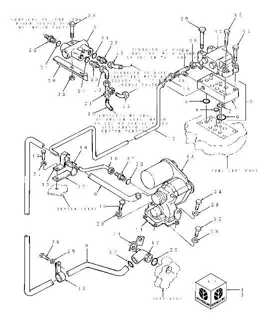

   / Ford 5610 ll #4
I forgot the parts page illustration.

I am having trouble finding a double { USED } valve setup for my 86 Ford 5610. Received my IT manual yesterday and you guys were spot on in your reply's. You guys and having a manual saved me BIG $$$$$$$. I also stopped by a NH shop, they had a NH 7610 in there with the same priority valve as my 5610. the 7610 had Hyd. hose " PRESSURE " run from priority valve to CCLS valve on the back with return line dumping in top of rear end housing. A small Load Sensing line came off the side of priority valve under seat to CCLS valve on the back. I know hyd. oil does not care what type line it runs through,metal or rubber line, but will that set up work,enough pressure,volume,heating issues,etc. ????? Also found a web site AGKITS.COM that has a HTC brand valve $786.49 with the same NH part number #81864874. The info on valve says its for the 10 series and newer tractors,valve only, no manifolds,etc. I have there tech dept. checking to see if this valve is CCLS, with port for the load sensing and do i have to have manifolds or can i run hose with quick couplers?? I need everyones input and experience on this project, Will this work,does anyone have experience with the co that makes the valve or valve it's self???? I will greatly appreciate any and all help. Thanks
