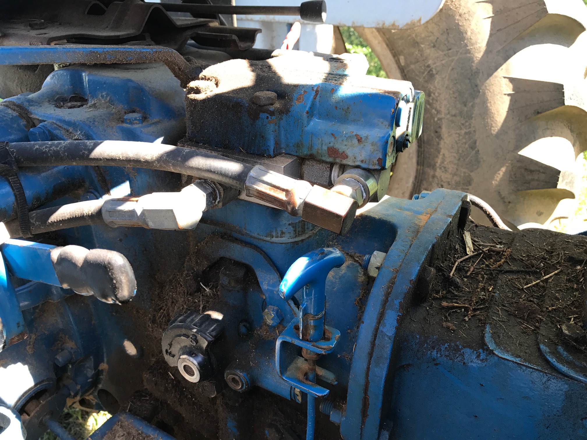

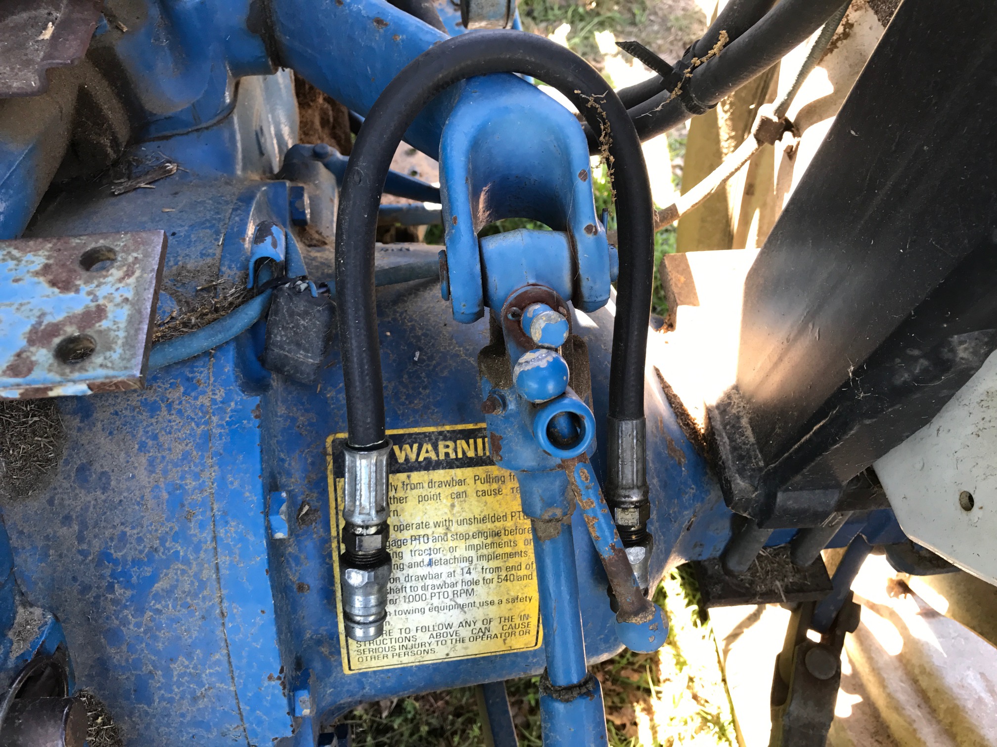

Here are a few pictures of what I did on my Ford 4610. This mod was done in the 1990's so not sure what may be available today. Nor if it works for your tractor. The hydraulic manifold is a Ford product PN-9613790. The manifold sits under the control valve. Pic 1 shows the connection for the remote. Pic 2 connection for FEL. Pic 3 shows bypass hose I connect to FEL quick disconnect when loader is removed from the tractor. This setup lets me work the FEL and 3 PH as needed. Hope this helps.
I know, tractor very dirty. Pressure cleaning is scheduled. Lol.
