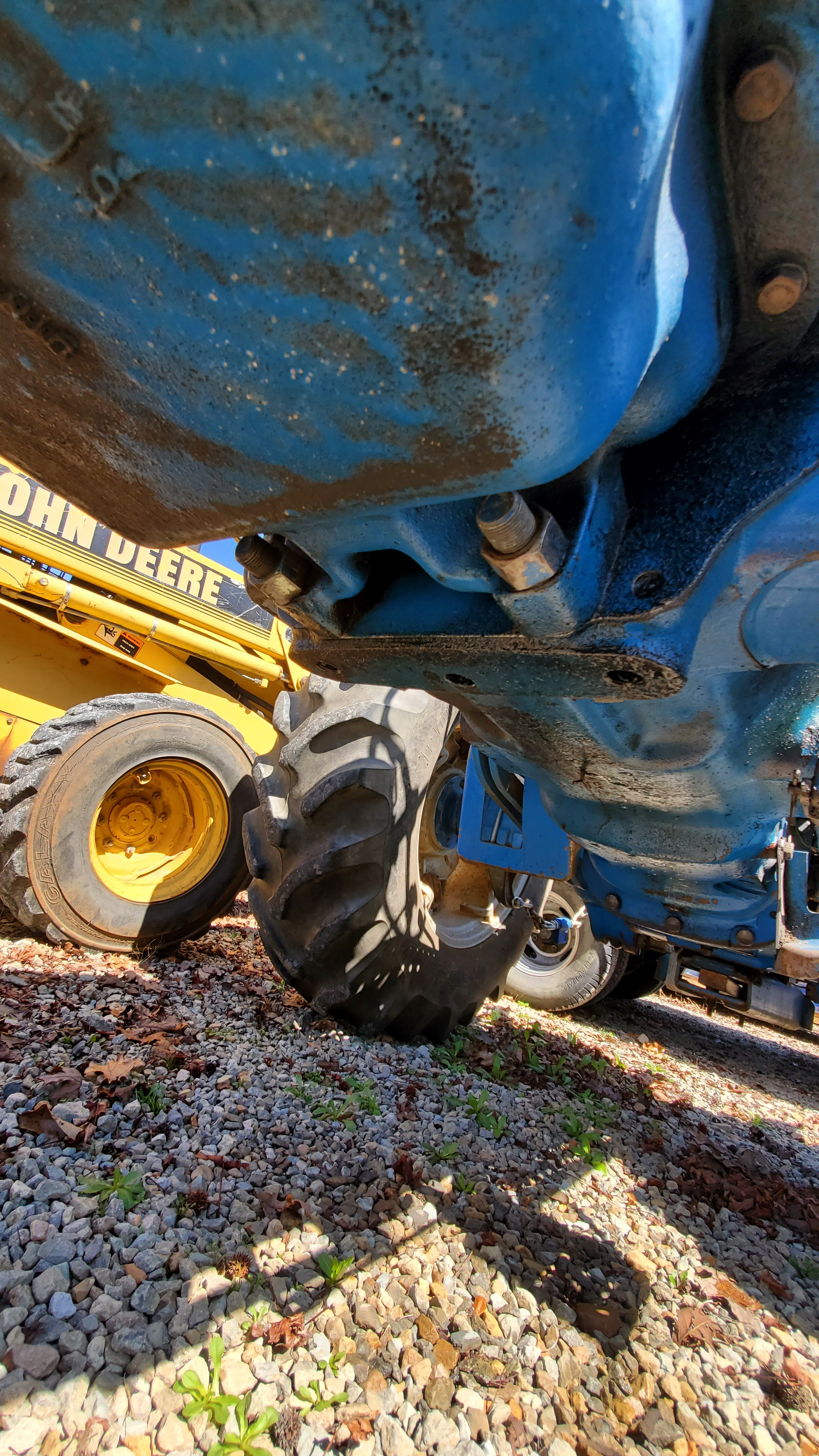

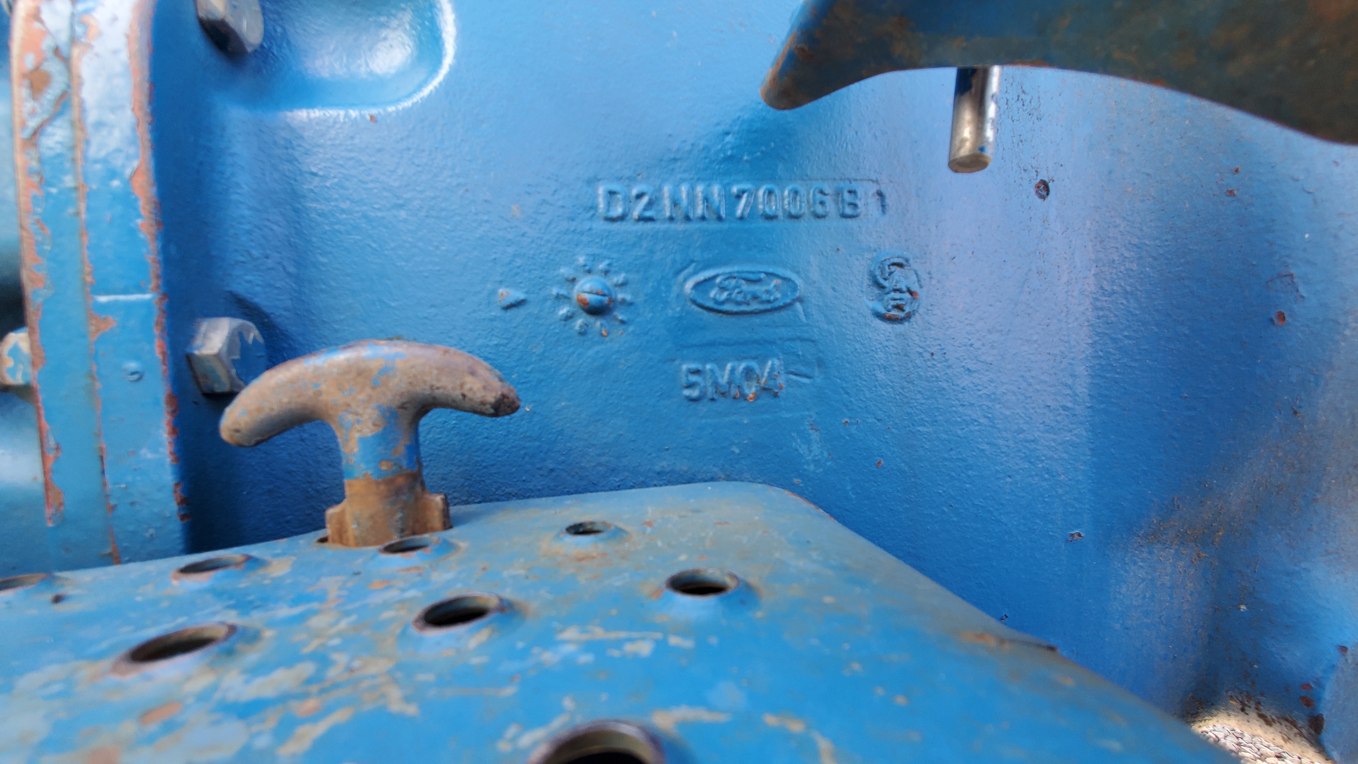

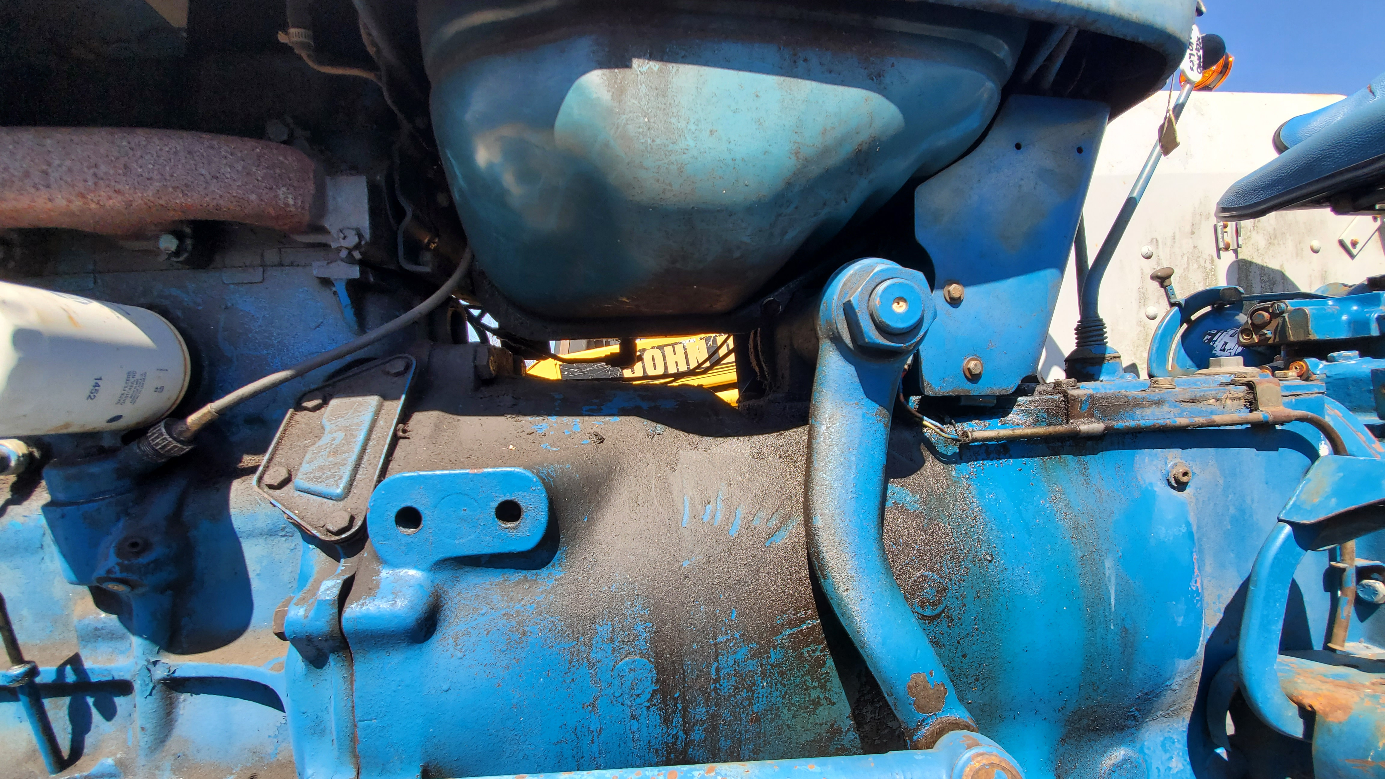

I have 46 acres that I am looking to buy a tractor to work with. 10 acres are planted with hay and the rest is wooded. I will be using the tractor to skids downed logs and box blade road and brush hog. Not sure if I will mess with hay as it was already planted when I moved here. I looked at a ford 5600 today and the hour gauge does not work. They put a new gauge on that shows 112 hours. The ignition does not turn the tractor off and none of the lights work. Other then that mechanically if feels good. Shifting each gear worked. I'm nervous about buying a tractor that the hour gauge is broke and don't know any history. It has a oil leak too. This will be my first tractor. The tires look newer and they are asking 6900 for it. Here are some pics of oil leak. Seeking any advice anyone can offer.

I'm new to tractors. I'm mechanical inclined. My work is hvac and I do all my own work on my personal vehicles. That said I have never tore a tractor apart. I test drove it and the clutch felt good and strong. I locked one wheel with brake and let the clutch out and it was dragging it In circles. The oil leak is what worry me. If it's a rear main seal then how long before it leaks into clutch housing and tears that area up.

I'm not sure if I'd even care too much about that leak, it's an old tractor, they all leak.

I’m going to assume that is the 4 cyl diesel engine. Those old Ford 3 & 4 cyl engines were bullet proof in my opinion. But, they are sleeveless engines.
If you have a cyl pit thru, you have the choice of going to a machine shop or a crate replacement engine. We used to op for the crate engine ($1000 per cyl back when we had Fords).
in regards to your leak, if it might be coolant, there is a freeze plug behind the flywheel that all the sludge in the block will pack up against and rust out. Either way, freeze plug or rear main, put a new clutch in then.
Those diesels never had ign shutdown, it’s the pull cable to the injection pump.
if you are really interested in it, pull the trans and rear drain plugs to get just a little out. look for metal, water, or sludge.
