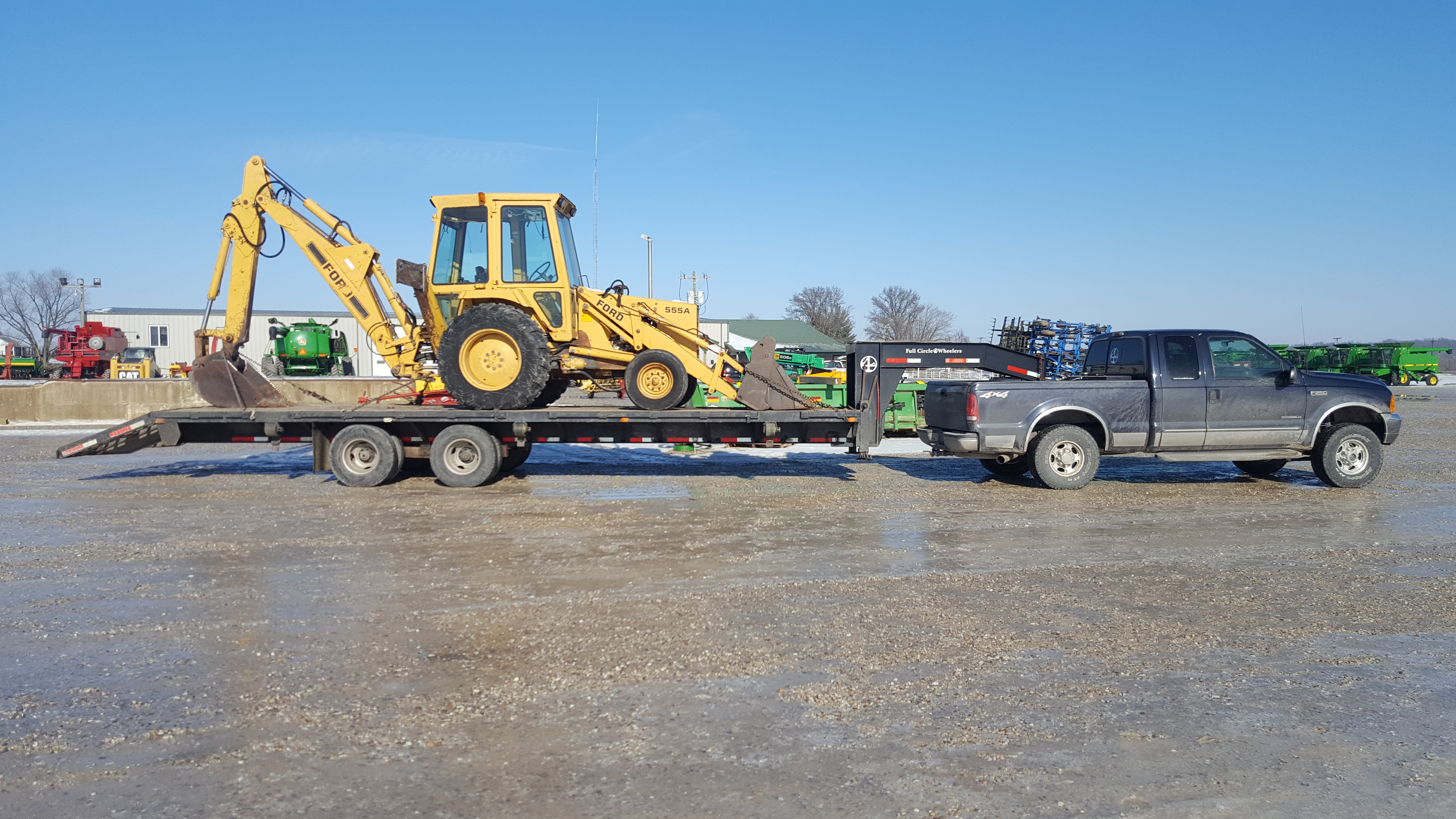

Last December I purchased a 555A for $6500. Spent $2000 fixing things I deemed necessary I've put 100 hrs on it. Very reliable machine. 4n1 front bucket, 15ft extendable boom, 24" bucket.
That is a nice looking rig.
