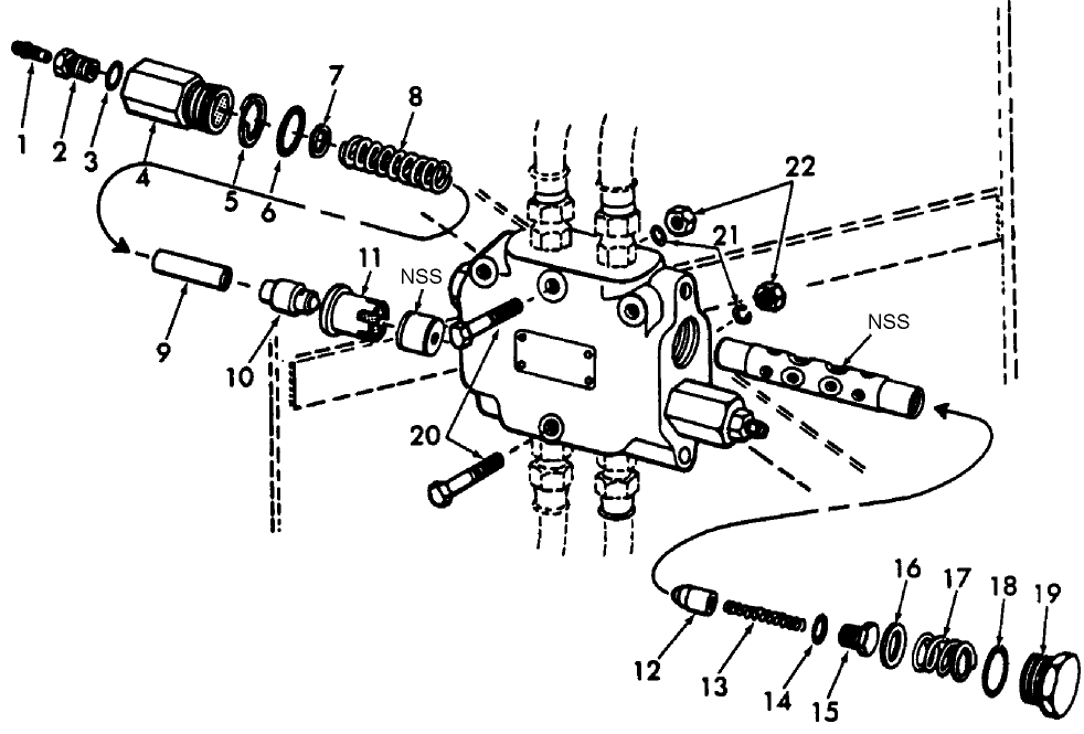

Did a quick look at New Holland Construction NEW HOLLAND CONSTRUCTION | BUILT AROUND YOU and found the below attached exploded view of the cushioning valve on the 550. Don't have a clue where it's located, but you can bet it's safely tucked under the floor pan.
Don't suppose you have a service manual..??
And if memory serves me correctly, seems ours had a spring loaded lever that would catch the boom when at about 60 degree swing that was linked to the swing lever. It would pull it back towards center, to soften the swing. Really aggravating if you run it all day. Smoke wrench took care of that...
If you use the link above, you can find your model, and find the exploded view of the hyd. assy's.
