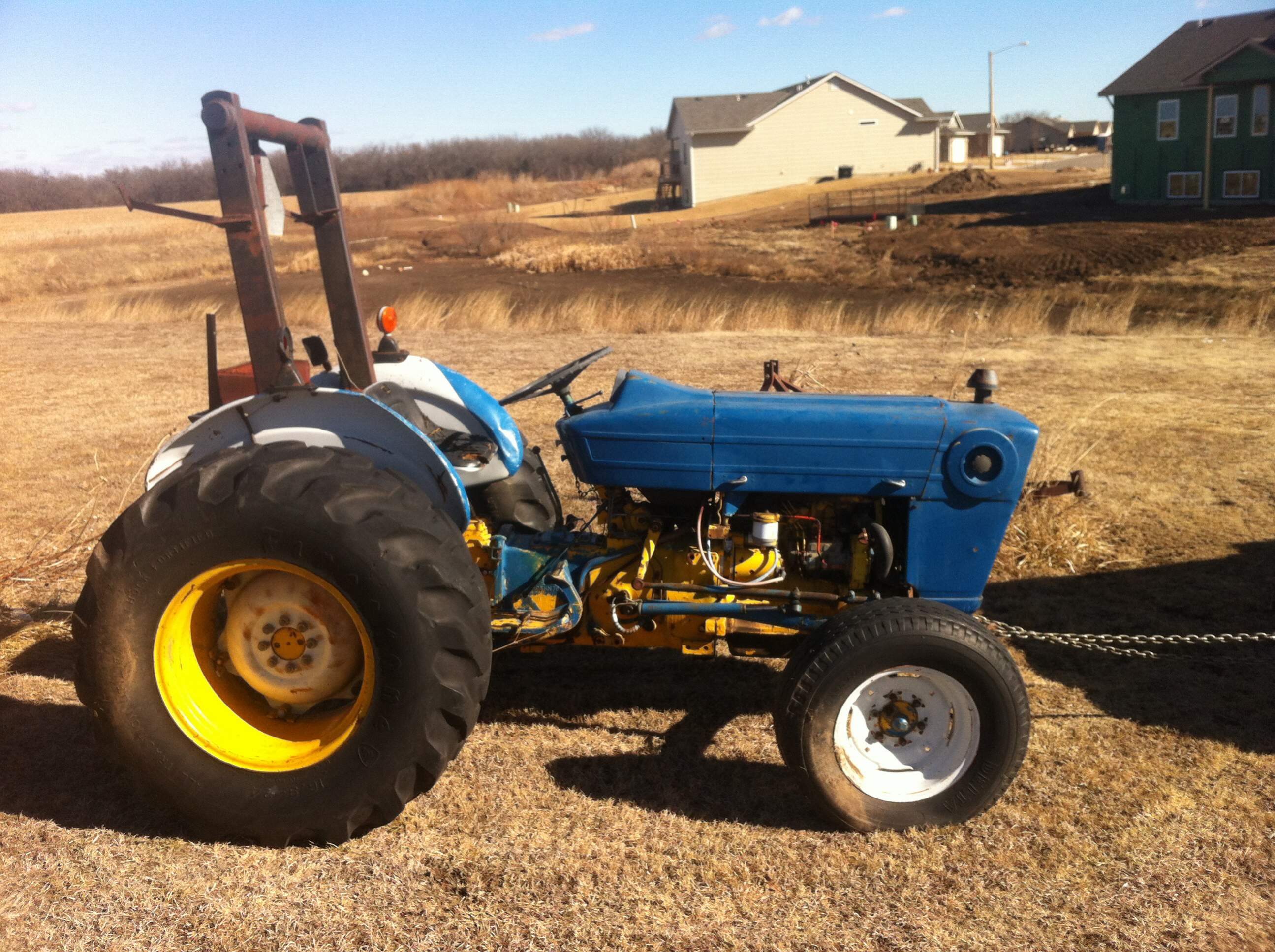

i need help as well!!! my model # under the hood is DL253C engine #8F21A # on the side of the block by the starter is D5NN6015G and the # on the axle is C5NN-4012D hope this helps because i cannot find anything on it!!!

here is a pic if that helps!!

Yours is a 531, I think low profile, 1978 year. I will look up tonight for whole description.

DL253C = DL2 is 531 model, design stage 2. 5 is Diesel horizontal exhaust. 3 is Live PTO. C is 8X2 Manual Transmission. Date Code 8F21A = 8 for 1978. F21 = June 21. A = Morning Shift.
It originally shipped as the model code is laid out. Many were LCG or Low Center of Gravity with very low profile tires like 18.4 x 16.1 tires on the rear and the front spindle being almost inline with front axle tube with 8.00 x 10 front tires. It is considered an industrial model, thus explaining the yellow paint on the chassis. The whole tractor was shipped in that color. It is equivalent to a 3 cylinder 4000 ag tractor. Hope this helps
