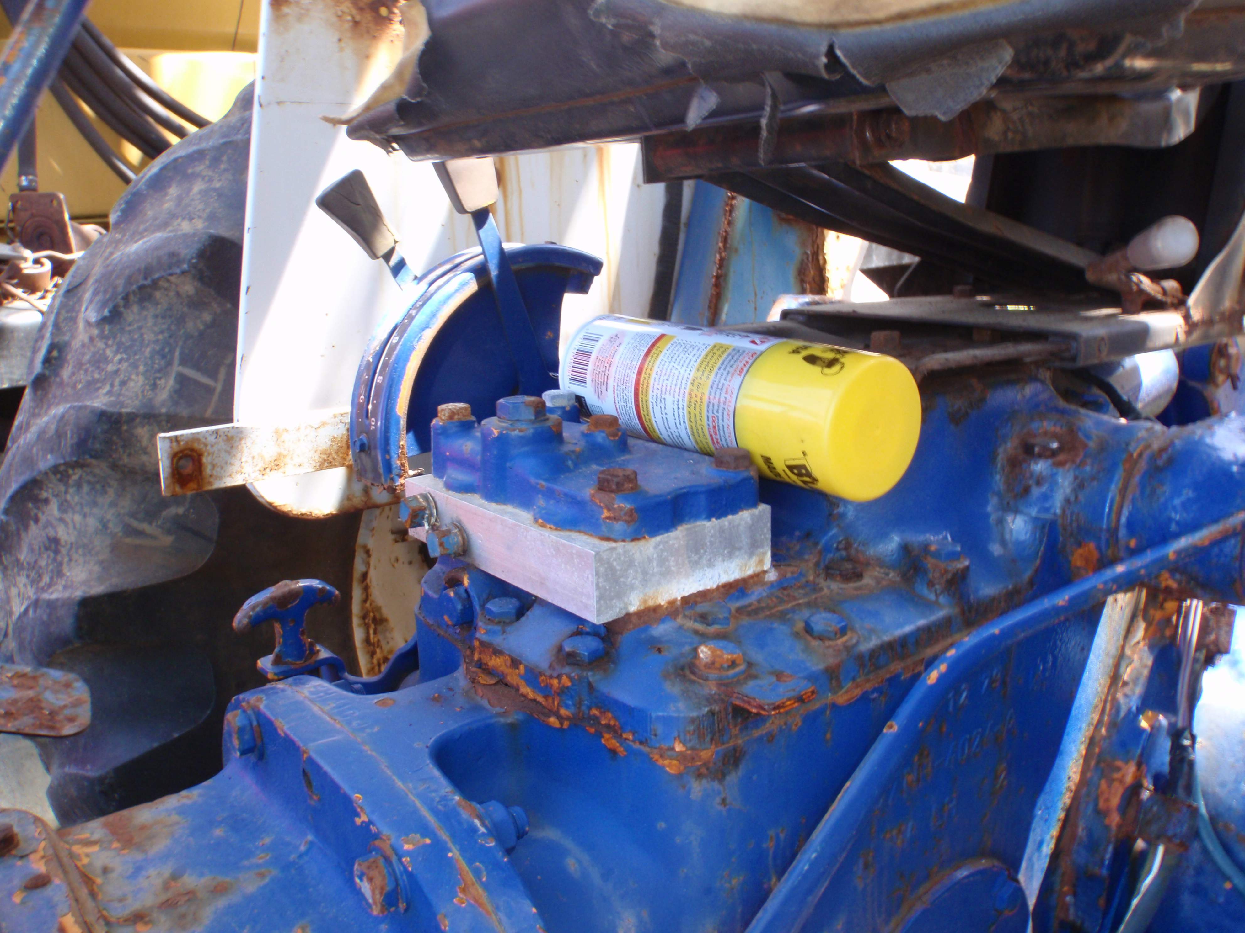

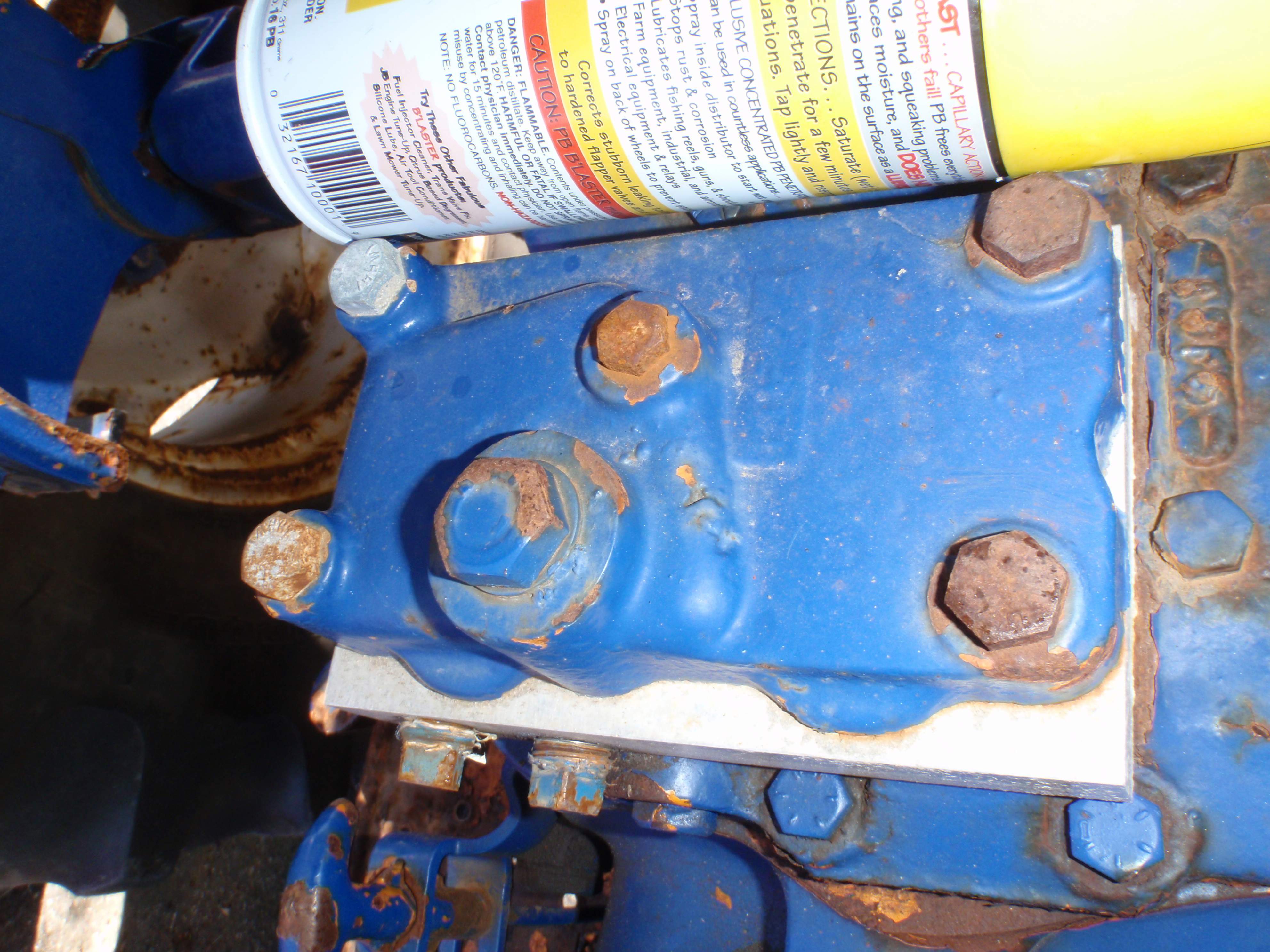

Hello,
My dad just bought a ford 540 industrial tractor at the local college auction and upon getting it home we found that the hydraulics do not want to raise, we think this might have something to do with this peculiar looking aluminum plate sandwiched in between the two factory pieces. it also appears that someone has robbed the remotes of the back, would that be the reason for the this plate?
pictures of how it is supposed to be setup would be greatly appreciated.
thanks,
Mills

The photos show a tapping manifold (the aluminum plate) installed on your tractor. It is used as a place to tap pressure oil flow for a power beyond style generic spool valve, and provide a port for the return Power Beyond flow to feed the 3PT hitch and any factory style remote valve, which you don't have, but could bolt directly on top of the tapping manifold instead of the blue accessory plate. Currently, you have no flow to the 3PT control valve due to the plugs in the tapping manifold. Either remove the tapping manifold and replace the accessory cover directly on the hitch cover with shorter bolts, or remove the plugs from the tapping manifold and loop a short hydraulic hose (rated for 2500psi minimum) between the ports. You need to do either one or the other of these modifications immediately, as right now 100% of your hydraulic pump flow is passing over the relief valve, stressing your pump and heating the oil needlessly. Not a good thing at all.

the pump is most likely shot by now if yall ran it with the plugs in that aluimiun plate that is a manifiol to run a loader are a control valve remotes, if the pump is not messed up all u need to do is remove that plate are take the to plugs out of it and built a hose to go from one into the other that plate was to send oil to a loader or control valve for remotes first then return to the other whole and which that supplied the oil to the lift top with them plugged off all u are doing is dead heading the oil pump

i would just remove the plate you hav on it and install the correct cover that bolts on and do away with all the extra head aches
