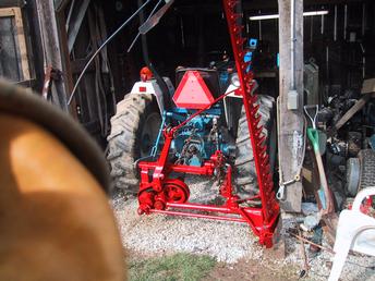

My dad found this mower for one heck of a deal!!! He wanted it for his lil BX24 but, descided it would be too much for his tractor. I have a 3203 JD and we "think" it should work well for my needs..ie. roadside maintenance, pasture work, general cleanup, etc.

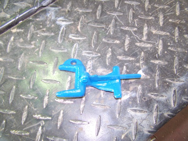

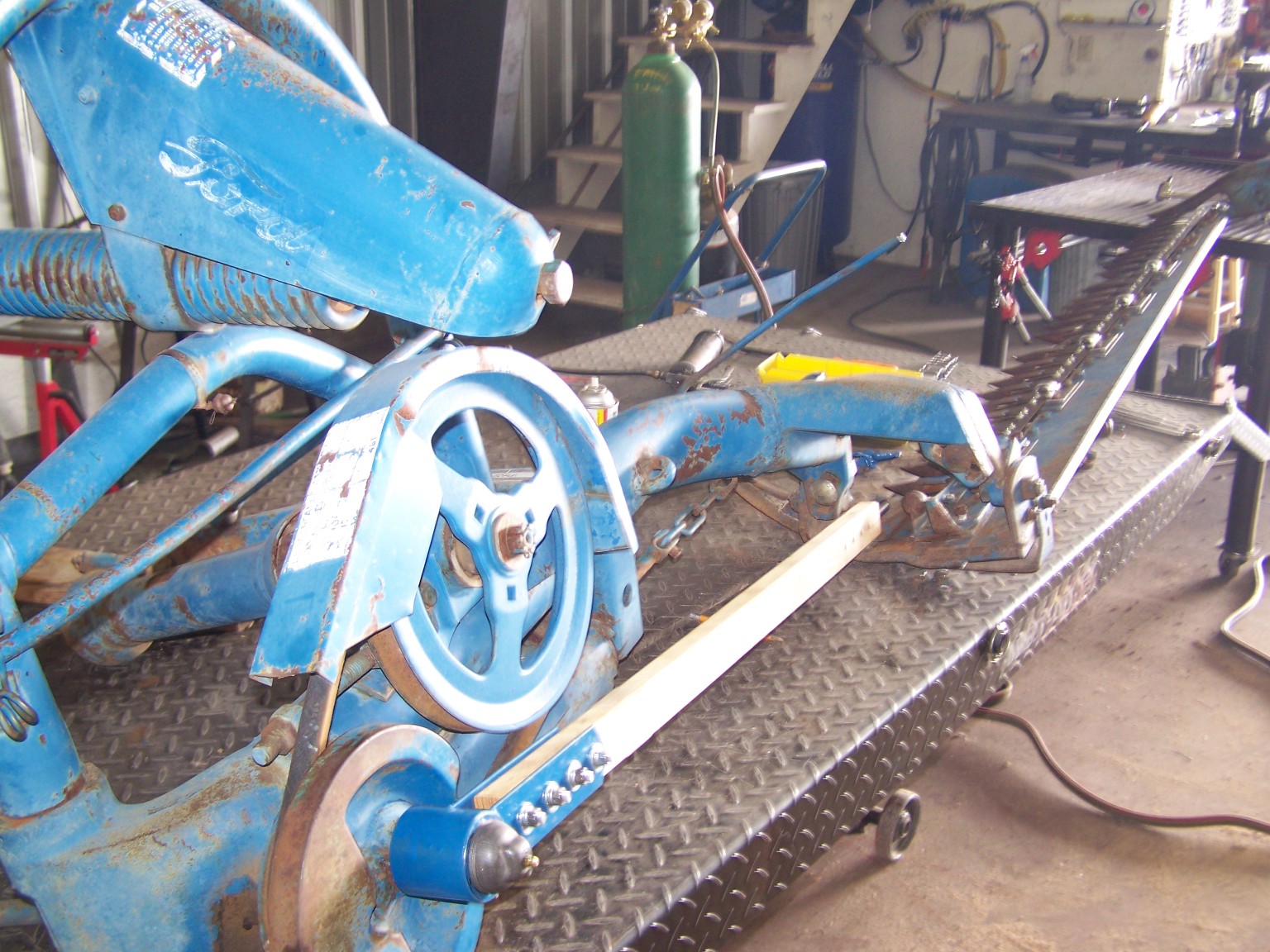

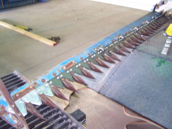

Now the ??'s begin:eek: When bought it had no pitman arm, straps, bearings, etc. So I scoured the net and bought new parts acording to diagrams I found online. I have already replaced all knife sections (minus the rivets, I used bolt kit as I don't have the rivet tool;)), new knife holdowns, wood pitman arm, pitman box assy, bearings, seal, etc.

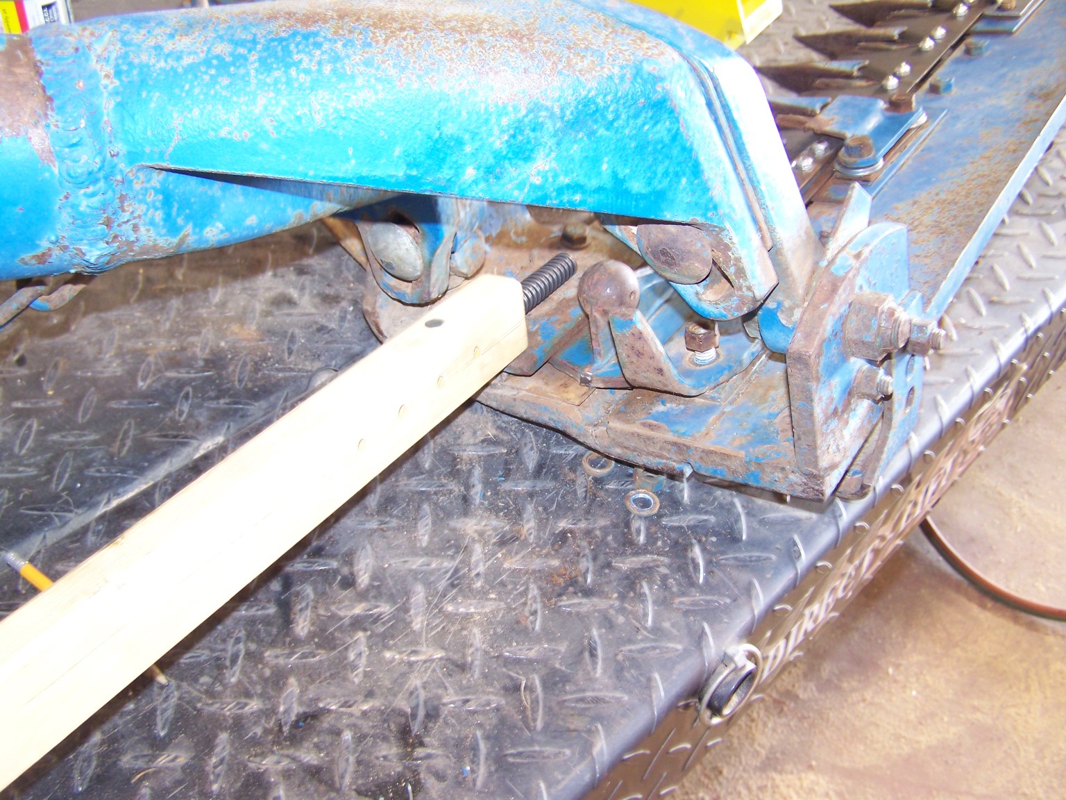

What I don't know is what the pitman "lever & tongue" part does and how it connects to the knife bar(pic #3)??? I have a couple ideas,(last 2 pics), but want to be sure!!!! I have owners and repair manuals purchased but waiting for delivery.
Thanks to all who can help!!!!!

I'll check mine tomorrow, but i'm voting for the second to last pic.

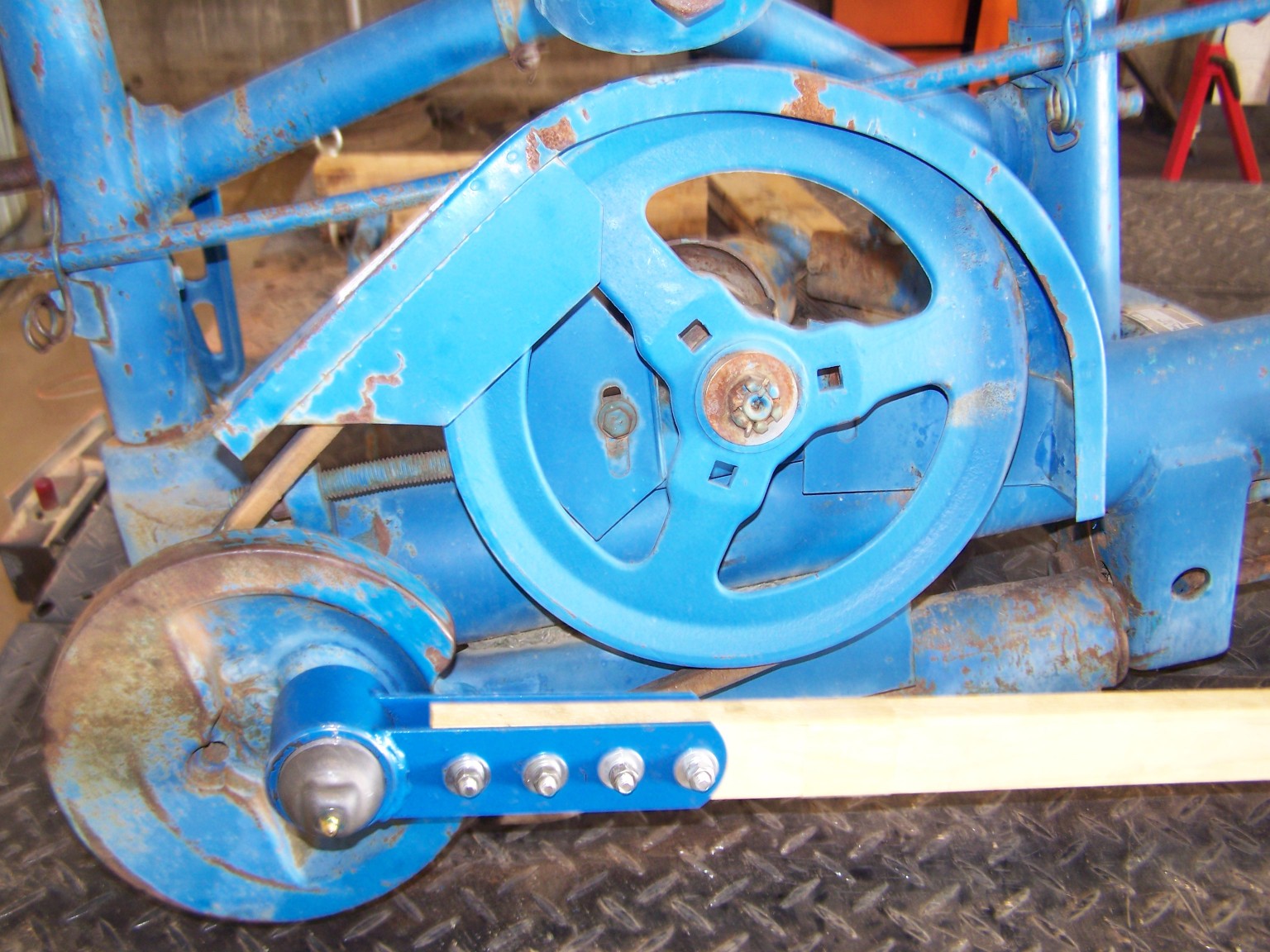

I had one for a few years back but it was 5ft and was to short for what I needed so I sold it. I picked mine up as an auction for $25. And it was in working condition just needed a pitman bar as the one on it lasted a whole 30 seconds and a coat of paint. Make sure you get a few extra pitman bars. Instead of buying them from the dealer I had my local saw mill cut me some out of ash. They lasted a long time. I just sold mine last year for $700 dollars.
Here is a website with older ford and ferguson equipment manuals that you can read online.http://www.ntractorclub.com/forums/manuals
Also another tip is to pour some oil on the cutter bar to make it run smoother and quieter.

1 other ??... what is the hole in the "ball" (where the 2 straps hook to, last 2 pics)?? Also, would one want to grease that ball to prevent metal to metal wear, or is that a non issue??
   / Ford 501 series 7' sickle mower ???'s #9
Any grease fitting threads in the "ear muffs"? I've had Dearborn and New Holland pitman-type sicklebars - the ball should definitely be lubricated or it will wear down. Pour a little bar & chain oil (sticks better) on the whole assembly now & then.
