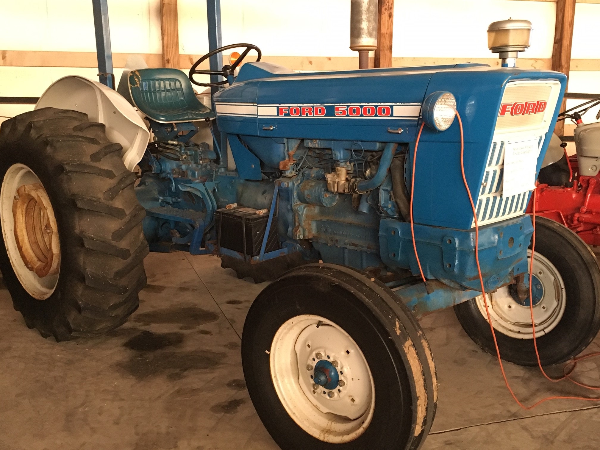

OK, I'm reviving my old thread, since I have purchased the gasket and rebuild kit for the lift cover.
I want to make sure I have the steps to pull it apart identified.
1) remove the seat (tips on getting in there? Not much room)
2) remove the hydraulic remote assembly
3) Remove the pin holding the top link arm
4) On both left and right, remove the pins holding the lower 3pt arms to the lift cover armsIMG_3841.jpgIMG_3842.jpg
5) remove all 13 bolts holding the lift cover in place
6) use engine hoist and straps to lift the cover off <--anything else need disconnected from the inside before completely removing?
I purchased the entire lift cover rebuild kit, but not sure what I'll find when I have it off. If any o-rings look warn or damaged, I'll replace them. My main goal is to troubleshoot the PTO spinning, when not engaged. Any tips for where to start?
Thanks in advance.
   / Ford 5000 Rear PTO spins even when not engaged
#16

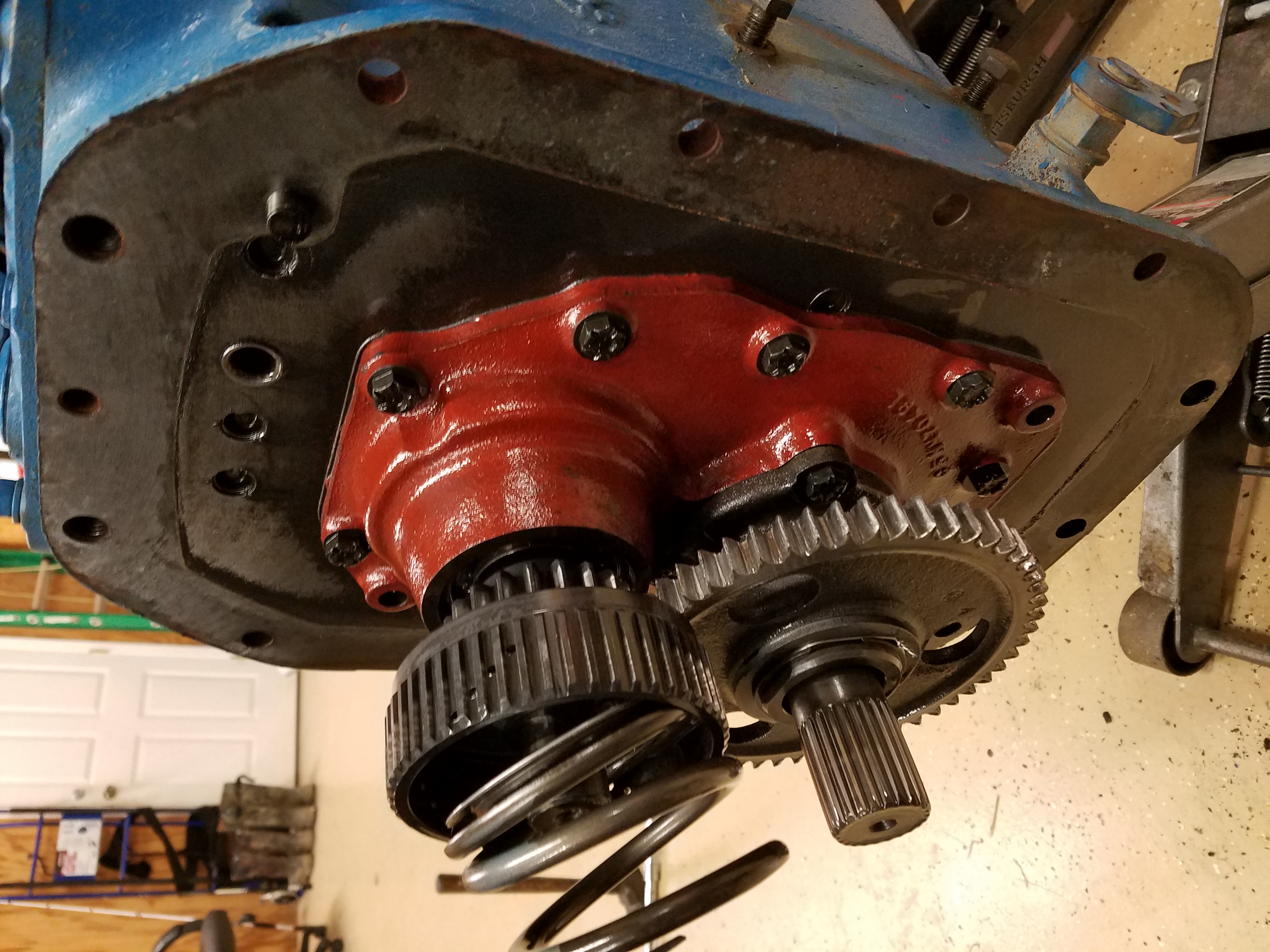

The tractor in the picture looks about a 71 or 72 I just went through this mine has a non adjustable shoe style brake the band didn't start until 72 or 73 later I think...
Most likley your snap ring has come out of your clutch pack and it allowed the main spring to not have enough force on the piston in the clutch pack to press the fluid back out when u disengage it so that means the fluid is staying in for longer keeping the clutch discs togeather and causing it to continue to spin after you disengage it.
I have pictures if u need them.
Take lift cover off and under the draft control the bracket that you hook your top link to, fold it down remove that cover and slide the shaft out the back of the tractor and remove the screw by your left foot step with the nut and when u take it out I bet the spring has pushed the snap ring an thrust washer into the clutch hub.
Tylertown...I know it's been a while but...PICs would be super helpful. Mine is a '72. I was told (incorrectly) by the original owner that it was a '70. But for sure it's '72.
-Tom
