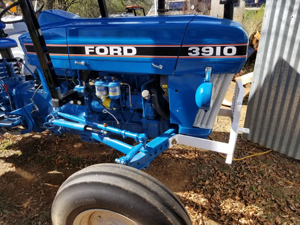

When I restored my 3910, I had the radiator out. It had the outer grill/screen, but the radiator was pretty packed with dirt. I had to soak the radiator then used a soft bristle brush to clean it out. It had an aftermarket temp gauge when I got it that always ran about 185-190 until it got two blades of grass stuck to it. It would go up to 200 and I'd stop to clean chaff off the front grill/screen. Now that I have a new stock dash and clean radiator, the temp rarely goes to the midway point--Way below the red zone.
Oh, and I had to replace the foam rubber around the radiator. It's there to make sure air flow is drawn through the grill/screen. That helps keep chaff off the radiator. A simple brushing can remove chaff from the grill. On my tractor, the grill is the screen.
