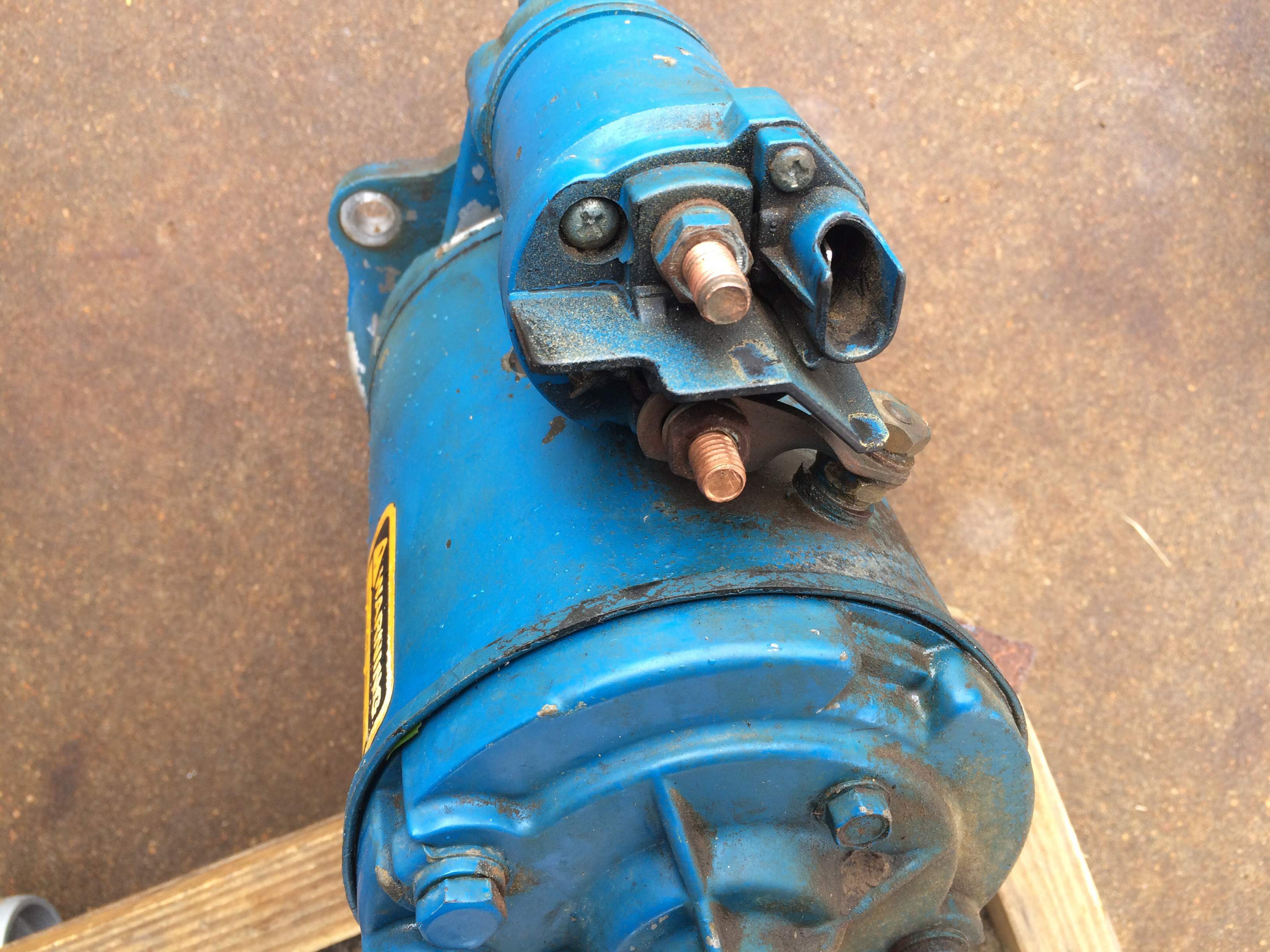

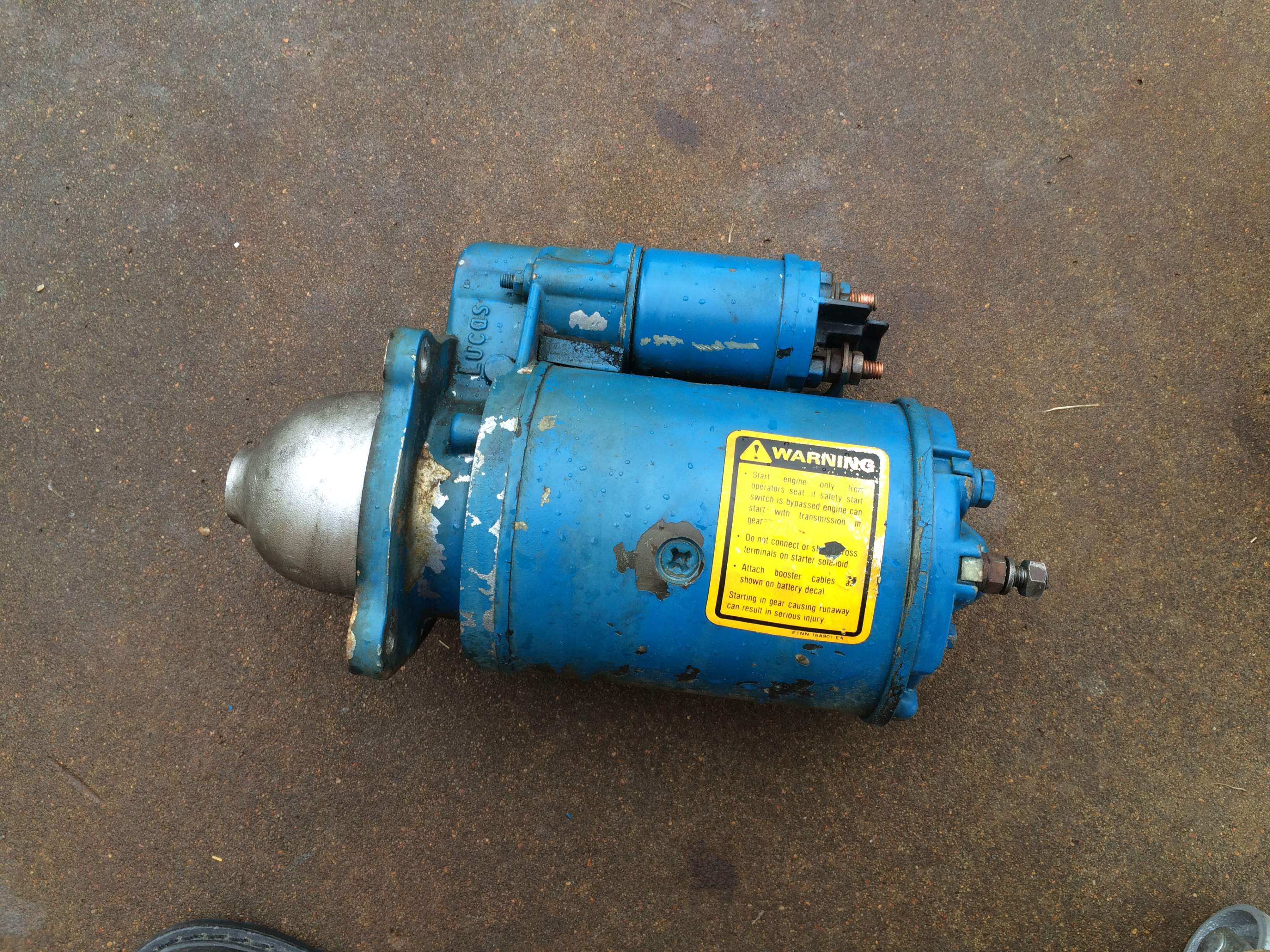

I've been having a starter problem for a while now. I get a nothing or a click then nothing while trying to start. This was intermittent as the problem would clear itself. Thursday it happened again and I decided to fix it for good. This time it did not clear itself. I tapped the starter solenoid n engine started. I then removed the FEL to have good work acess. All troubleshooting on tractor pointed to a bad solenoid. I removed the starter n bench checked it. Sure enough solenoid would work for a few times then hang up with a click or nothing at all.
This is a Lucas starter n I am not familiar with this starter. My question is are the parts for this starter/solenoid common n easily found? Or do I have to research n see if I can find parts? I am looking for the solenoid contacts n plunger. Or maybe a whole new solenoid, the motor is still good n strong. The part numbers are: starter motor 54257610 solenoid 77228A. If someone can post a parts breakdown I'd appreciate it and any source for parts. Thanks.

these starters are called m50 by lucas they were several application all depending on engine and how it fit on engine the number of your starter is 26211 the number you have that starts with 5425 is the drive end housing your starter has a lot of years on it probably better to get new one very low priced i see your in east texas if you are close to college station call billy sharpe phone number 979-775-9800 he will have it in stock he used to have a shop also in tyler will have to ask him

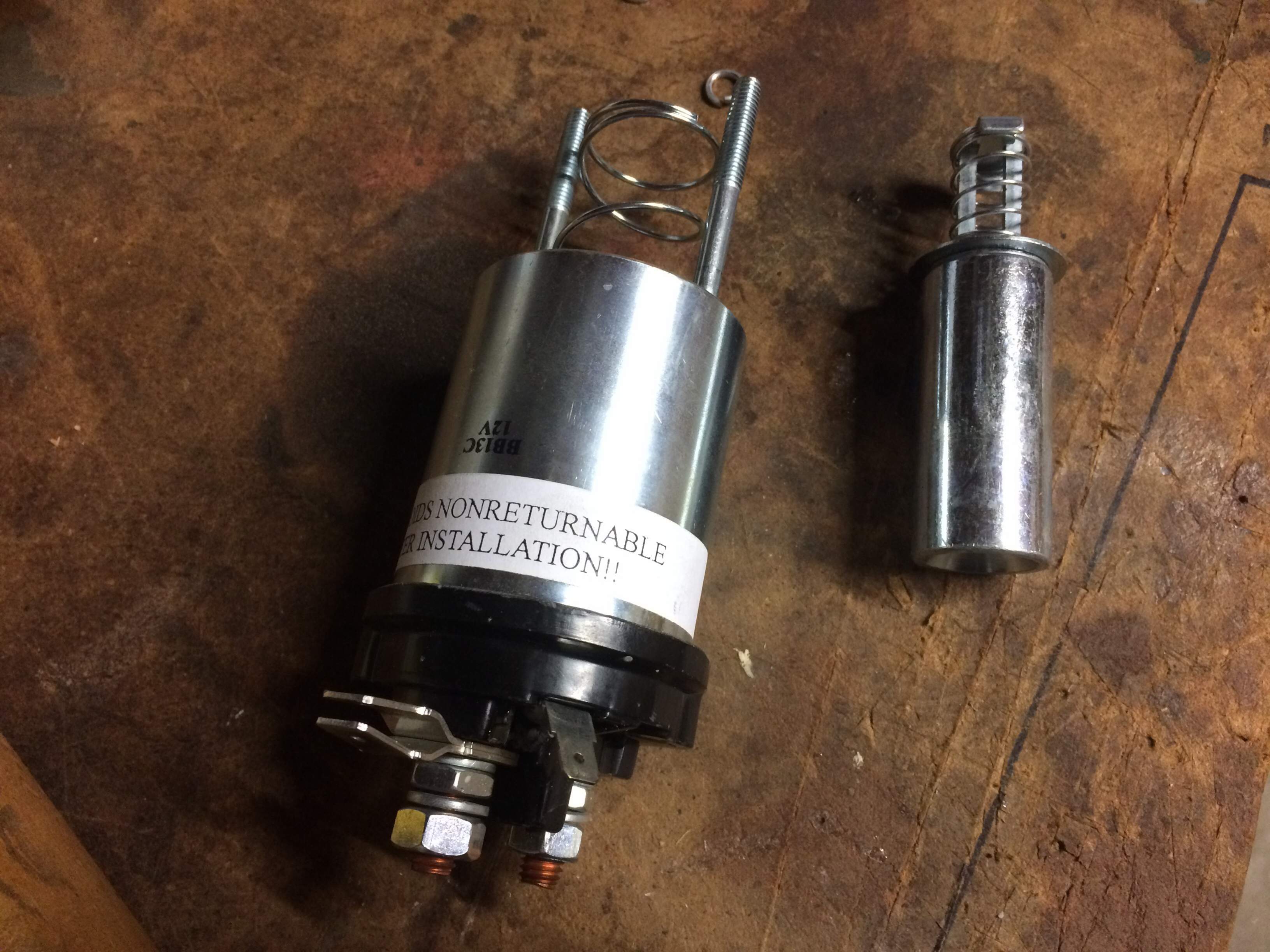

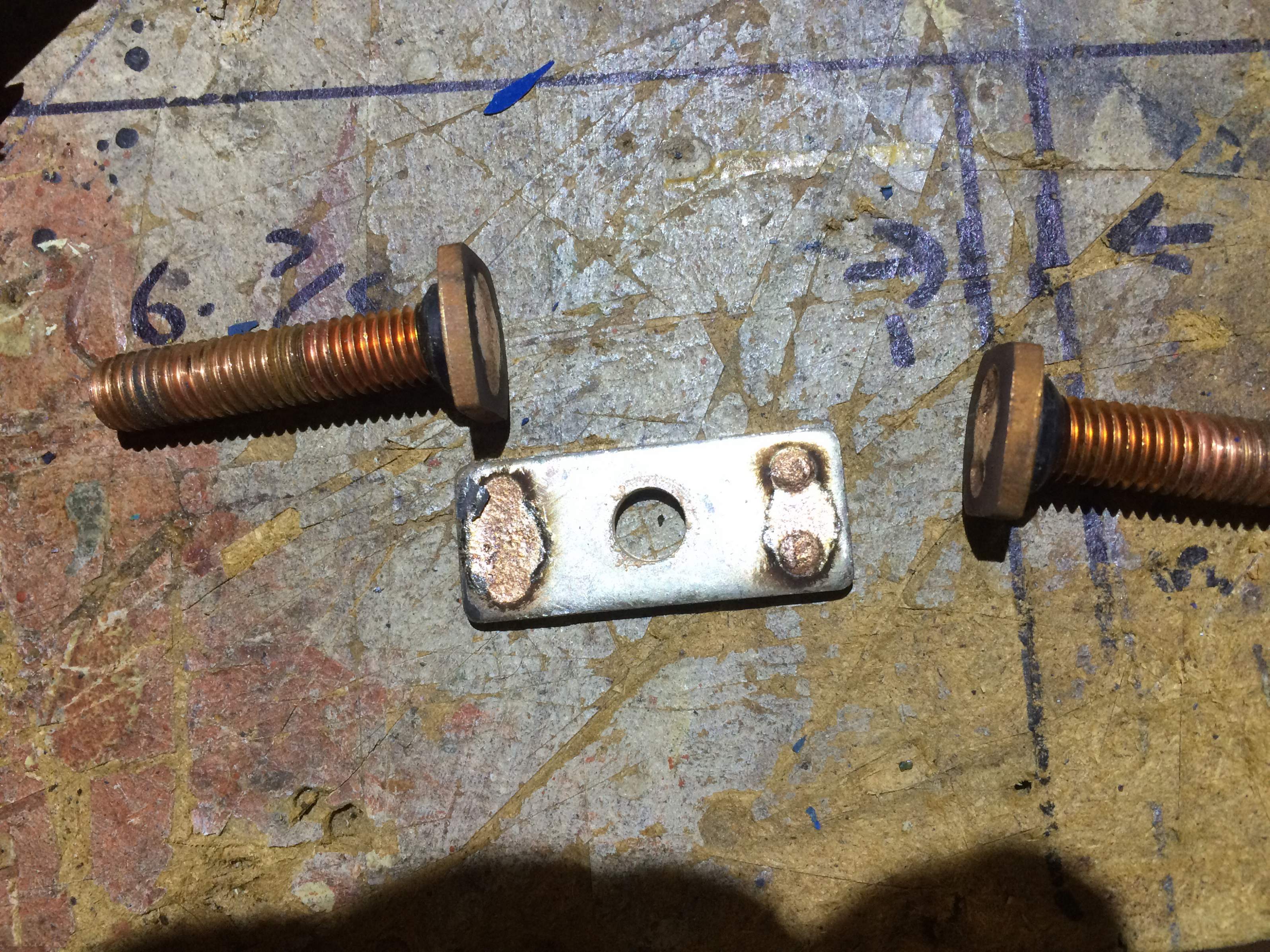

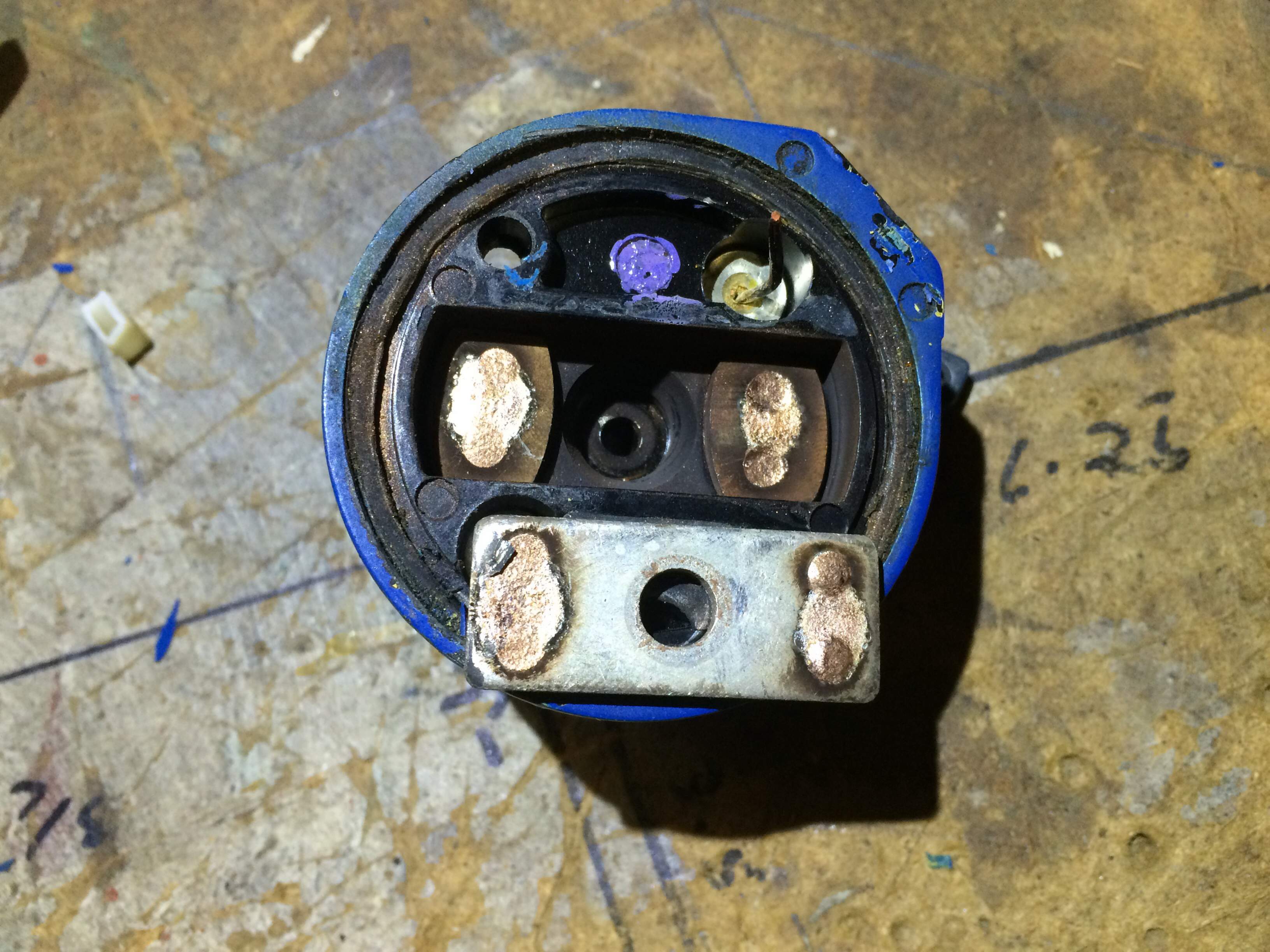

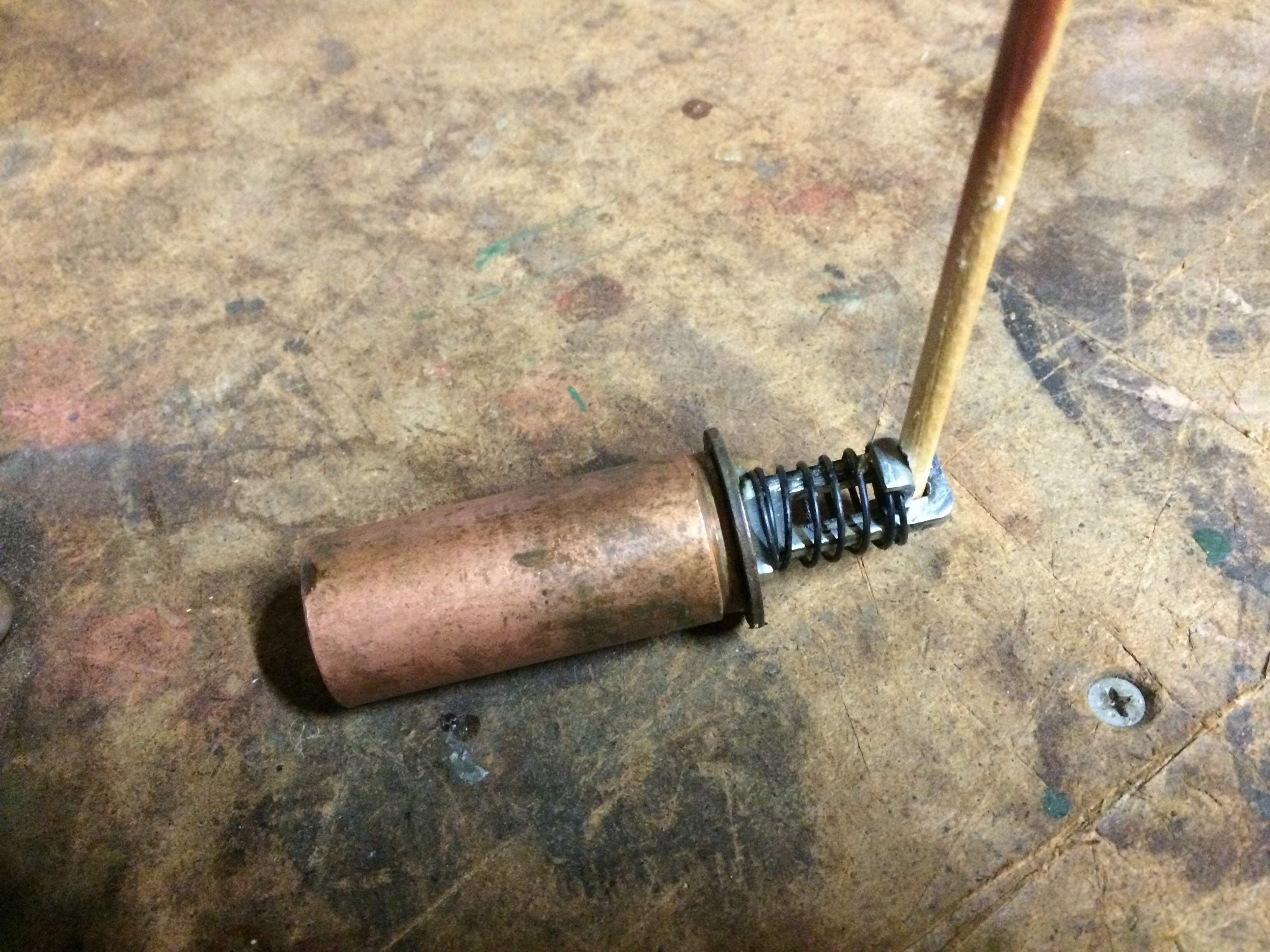

This is what I did re: starter. I found some info and good prices online but cannot wait for regular delivery. Fast delivery equals almost to local prices. Ford dealer, new solenoid $102 rebuilt starter $192. So I checked with Napa Auto Parts, new solenoid $72 so I went with Napa, local in town. Dealer is over an hour away plus weather was to get bad.
Solenoid is mounted to starter awaiting going back on tractor. These solenoids are not designed for contact replacement. The new one is sealed and the old one did not come apart. I think you have to desolder the wires to get it apart. Anyway, I tore it apart to look inside. See the pictures. The pictures may help others that are researching this problem. To connect the solenoid to the engagement lever, you have to push to depress the spring n clip while the rectangle arm is slid over the engagement arm. Took me 2 tries to get it on. The wooden dowel in picture represents the engagement arm. The old contacts are really worn. I was lucky to get it started to get the FEL off. Anyway, hope this helps someone else.
