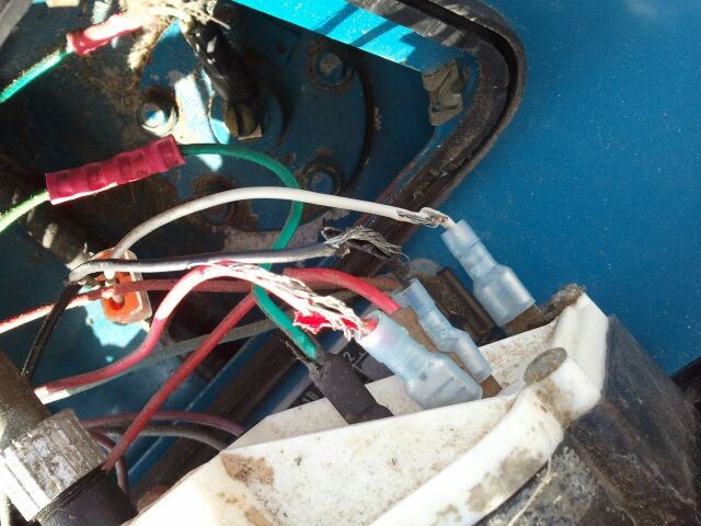

Well, now I believe it may be rodents. I have had a problem with rodents 2 times in the past. I have had to do some wiring repair. Today I was using the tractor and on the last start up, I noticed that my fuel gauge moved to full fuel. With power off it moves to half full. This is a new movement pattern and it may be rodents have chewed into the wiring. I will have to take the hood off and pull the instrument panel to check it all out.
   / Ford 4610 Electrical Issue
Well, the rodents got me again. I pulled the instrument panel and found chewed wires. Repaired and now fuel and temperature gauge work again. I am not sure if they chewed any of the more hidden wires. The tractor has been starting since the no-start problem. Time will tell. image.jpg
