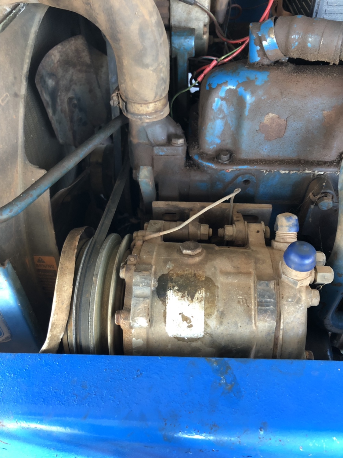

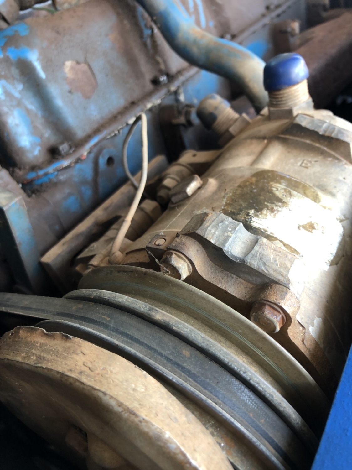

I have this old (new to me) 4610 I’m going through and not sure what I’m looking at here. Browsing parts diagrams online hasn’t helped either
I believe it to be an auxiliary belt driven hydraulic pump since there are 2 flares fittings but nothing is connected to it.
I also have the transmission driven pump for the 3pt and the engine driven going to the auxiliary valves.
The label is wore off so can’t get a model number but assuming it is a hydro pump I’d like to find the specs on it.
   / Ford 4610 belt driven pump #2
Looks like a AC compressor.
Really? This tractor had AC?! I’d never have guessed. Since the cab is gone I guess I’m safe to take off the belt.
   / Ford 4610 belt driven pump #5
Don't that it off set it up as a on board air (OBA), so that you have a air compressor where ever your tractor is located.
Google "belt driven OBA" the 4x4/Jeep forums are full of how to do it.
   / Ford 4610 belt driven pump #6
I have one on my IH Scout and it will run a framing nailer and I use it when installing fence rails.
