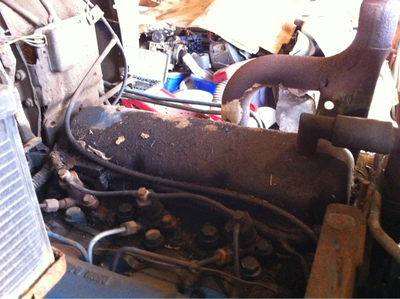

Mar 18, 2012 / Ford 4600 #1 F Ford4600 New member Joined Jan 8, 2012 Messages 10 Tractor Ford 4600 Stupid question but how do you add oil to a ford 4600 there's no oil cap on the valve cover Attachments image-1988734164.jpg 513.6 KB · Views: 882
Mar 18, 2012 / Ford 4600 #2 S Sawdustsmb Silver Member Joined Oct 28, 2011 Messages 179 Location Greene, NY Tractor TL80a, Ford 4000, Super H, F 12, F14 Right side of the engine - in front of the injection pump - in the front cover there is a knob - unscrew - pull out - looks like an old boat drain screw in plug.

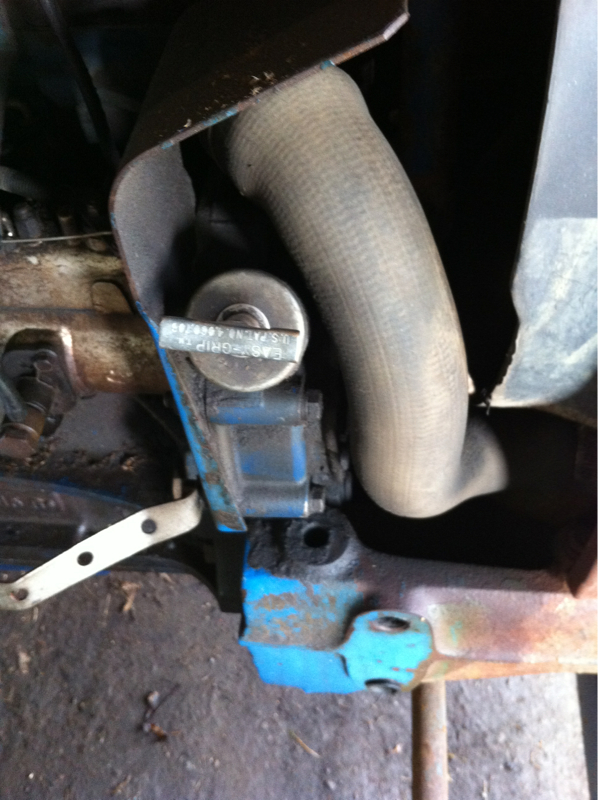

Mar 18, 2012 / Ford 4600 Thread Starter #3 OP F Ford4600 New member Joined Jan 8, 2012 Messages 10 Tractor Ford 4600 This spot Attachments image-2057573798.jpg 461.9 KB · Views: 986
Mar 18, 2012 / Ford 4600 #4 whodat526 Veteran Member Joined Apr 30, 2010 Messages 1,521 Location deridder louisiana Tractor fords Ford4600 said: This spot Click to expand... that is the spot
Mar 18, 2012 / Ford 4600 Thread Starter #5 OP F Ford4600 New member Joined Jan 8, 2012 Messages 10 Tractor Ford 4600 Thank you I was at but though it was for the pump
Mar 20, 2012 / Ford 4600 #6 Soundguy Old Timer Joined Mar 11, 2002 Messages 51,575 Location Central florida Tractor RK 55HC,ym1700, NH7610S, Ford 8N, 2N, NAA, 660, 850 x2, 541, 950, 941D, 951, 2000, 3000, 4000, 4600, 5000, 740, IH 'C' 'H', CUB, John Deere 'B', allis 'G', case VAC naa.. that's right at the front timing cover.. you are good.. wd and 4600 gave you good info.
