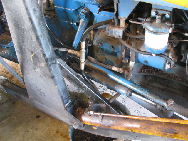

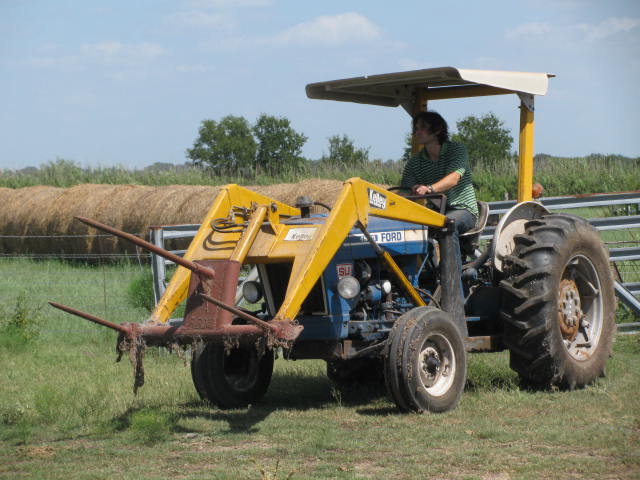

My family has a Ford 4600 with a Kelley front end loader and a rear three point hydraulic mounting system. My grandfather passed away in 2001, and the tractor hasn't moved an inch until yesterday. Fluids swapped out and levels checked (oil, diesel, and coolant), the tractor started without a hiccup. Unfortunately, I have never learned how to operate the hydraulic system. Not sure whether it is user error or age of the lines, I managed to blow a hydraulic line for the front-end loader. There seems to be an on-off switch below and to the right of the drivers seat (sorry, i didnt take a photo) which I assume controls the fluid flow between the rear three point and front end loader. Could someone please offer some insight as to how this system should work? If it did blow not because of old age, should a bypass valve prevented the eruption? Only lost about half a gallon of hydraulic fluid.
Hopefully the attached photos will work. I ordered an I&T service manual, but I dont believe this includes the aftermarket front-end loader.
Thank you!

Not sure about the plumbing on your tractor but if it has sat for that long I would say the age had more to do with the line blowing out than anything else. Tractors are just like everything else, it harder on them to sit than it is for them to be used daily.

Your hose probably died of old age. They don't last forever so just replace that.
I believe your tractor has a valve under the seat that ports pressure from the internal pump to the FEL conrtol valves. It's a two position valve that either allows the hydraulics to run the 3 point or the loader and is generally refered to as a selector valve. It's also possible that it allows either the 3 point to function or both the 3 pt and the loader to function. Since I'm not familiar with that specific model, I can't be more specific.
