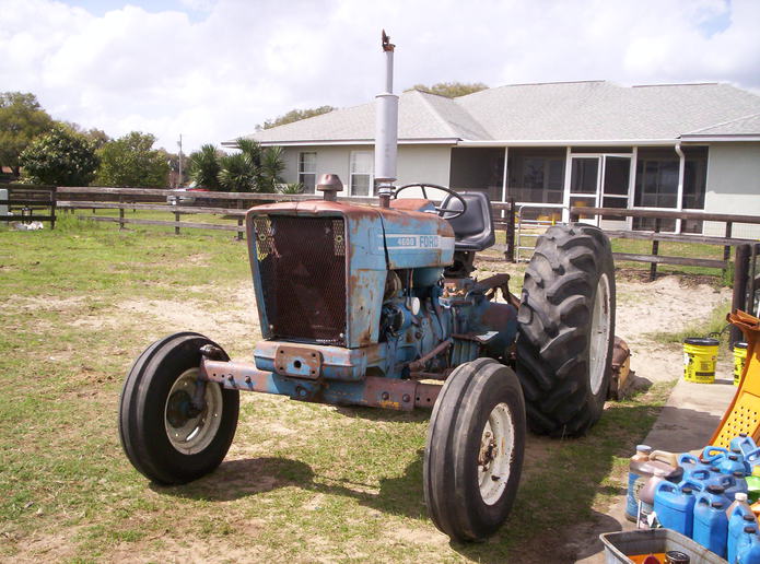

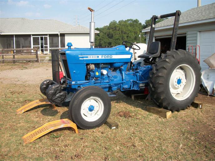

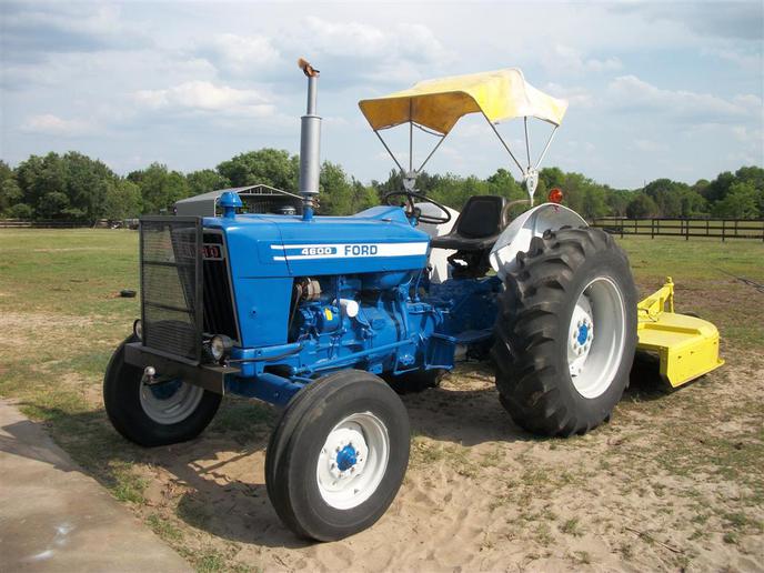

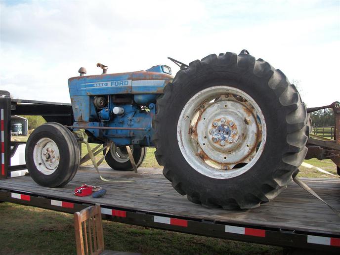

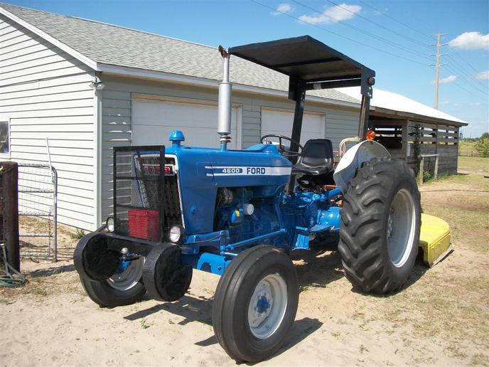

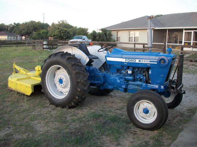

here's my 4600. bought it cheap-cheap and go the clapped out mower for free... had no muffler .. flap cap was right on the hood... 3pt position control was not working, no grill or gauges or working electrics.. .. shutoff cable was broke.. had to kill it at the pump
put in a few weeks of elbow grease and sweat.. got her beat into shape. casted some front weights.. made up a bumper and grill guard, finally added a canvas topper.. but then found a rops.. added the rops, then built a topper for the rops.
so mows like nobodies business.
