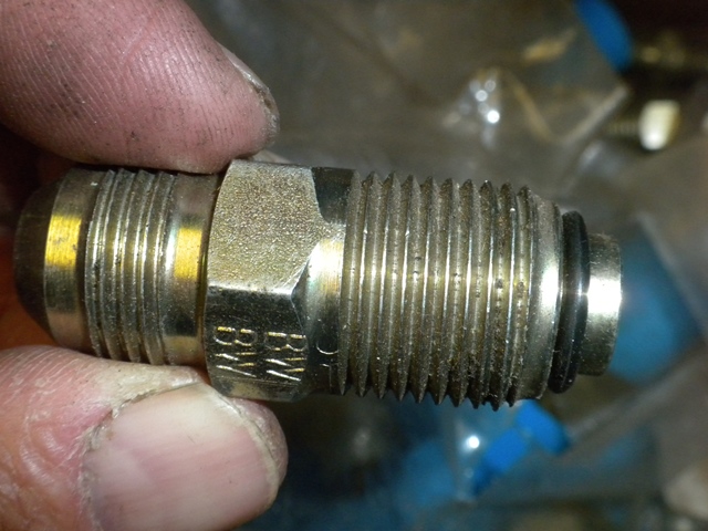

Bill W...is this maybe what you need to convert that end to JIC?.....that way a new hose in the future is a snap
the one shown is 3/4-16 on both sides......I stock them for old ford tractors
