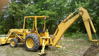

Dose your look like this?
   / Ford 420 Engine specs and parts ??
#9
I wish it was as pristine as the one in the pic but its not.Looks very close to mine.Mine has fenders over the tires and the top looks a little different.The back how attachment looks the same.
