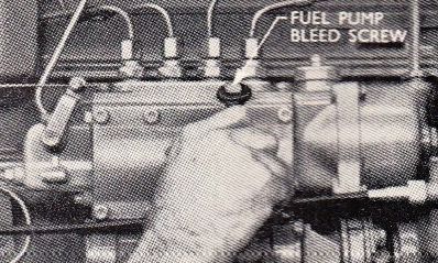

How do I bleed the injector pump.Is there a bleeder screw on pump. It's a 1963 4 cylinder model. :confused::confused
   / Ford 4000 injector pump #2
Is it a Simms pump on the right side of the engine?
Bleed your filter first, loosen the cap screw on the injector pump a little then use the hand toggle on the bottom of the fuel pump to pump fuel to the injector pump.

Thanks Whirly, I bleed new filter first, it's full with no air. The pump is on right side but it isn't a Simms, it's a Stanadyne.It does not have any type of pump on it. :confused:
   / Ford 4000 injector pump #4
Sorry that didn't help. You may just have to crack the lines at the injectors and then turn the engine over to bleed the air from the pump and lines. Turn the engine until you see fuel then tighten. It's messy but it might work.
