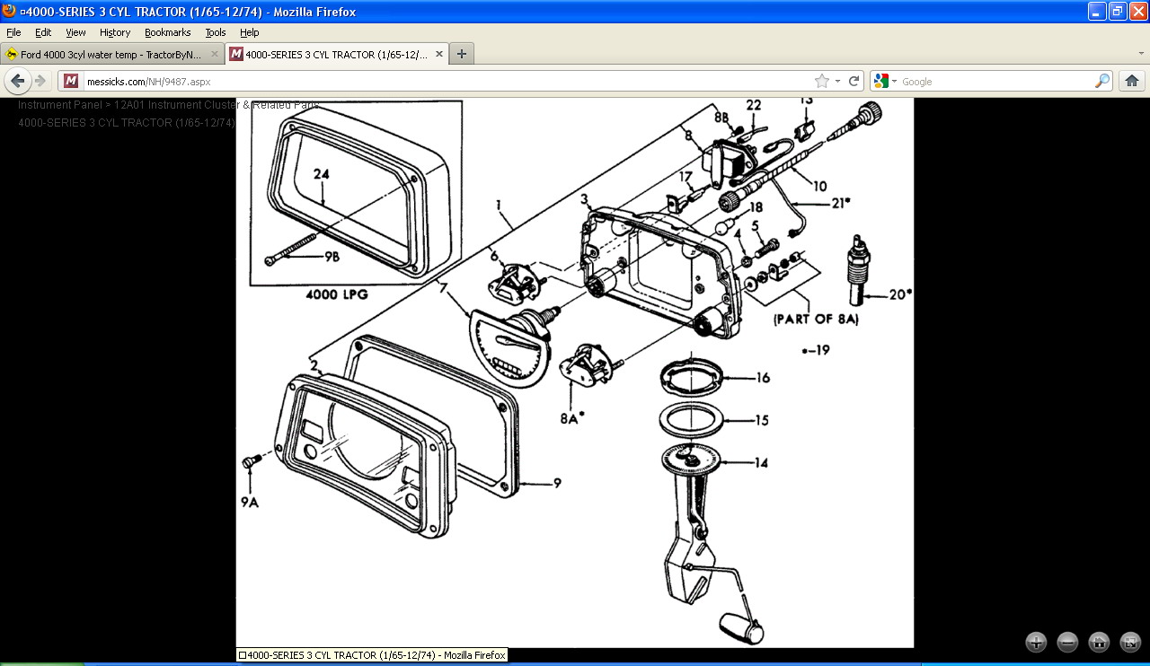

I just purchased a ford 4000, the temp gauge says its running hot. The radiator was leaking so I put a new oem radiator on. I replaced the thermostat and hoses. Temp gauge still says it's running hot, I bucket tested the radiator looking for a headgasket leak, no bubbles. I put a temp ga in the radiator while running, it read 165 degrees. I ordered a new sending unit for temp, any suggestions?

thanks Jinman, if it's not the sending unit, is the meter easly replaced or do you replace the whole panel?
   / Ford 4000 3cyl water temp #4
Is your inst pnl like the one below? If so, the gage is replaceable for around $75. You DON'T want to know what the whole panel would cost.:confused2:
Yes, thats it. I replaced the sending unit and tighten the fan belt. While I was waiting for the tractor to come up to temp, I noticed water dripping from the water pump. Maybe, that's been the problem. I've got to replace it first. Are after parts ok or should I stay with oem?

What I've done,

I checked the block while engine running, with infared thermometer it reads 160 degrees. I thinking temp gauge now or could it be the voltage going in?
   / Ford 4000 3cyl water temp #9
G'day IIRC those dashes have got a voltage regulator in them and the gauges actually work on about 6 volt but if they play up then usually your temp and fuel gauge go haywire
