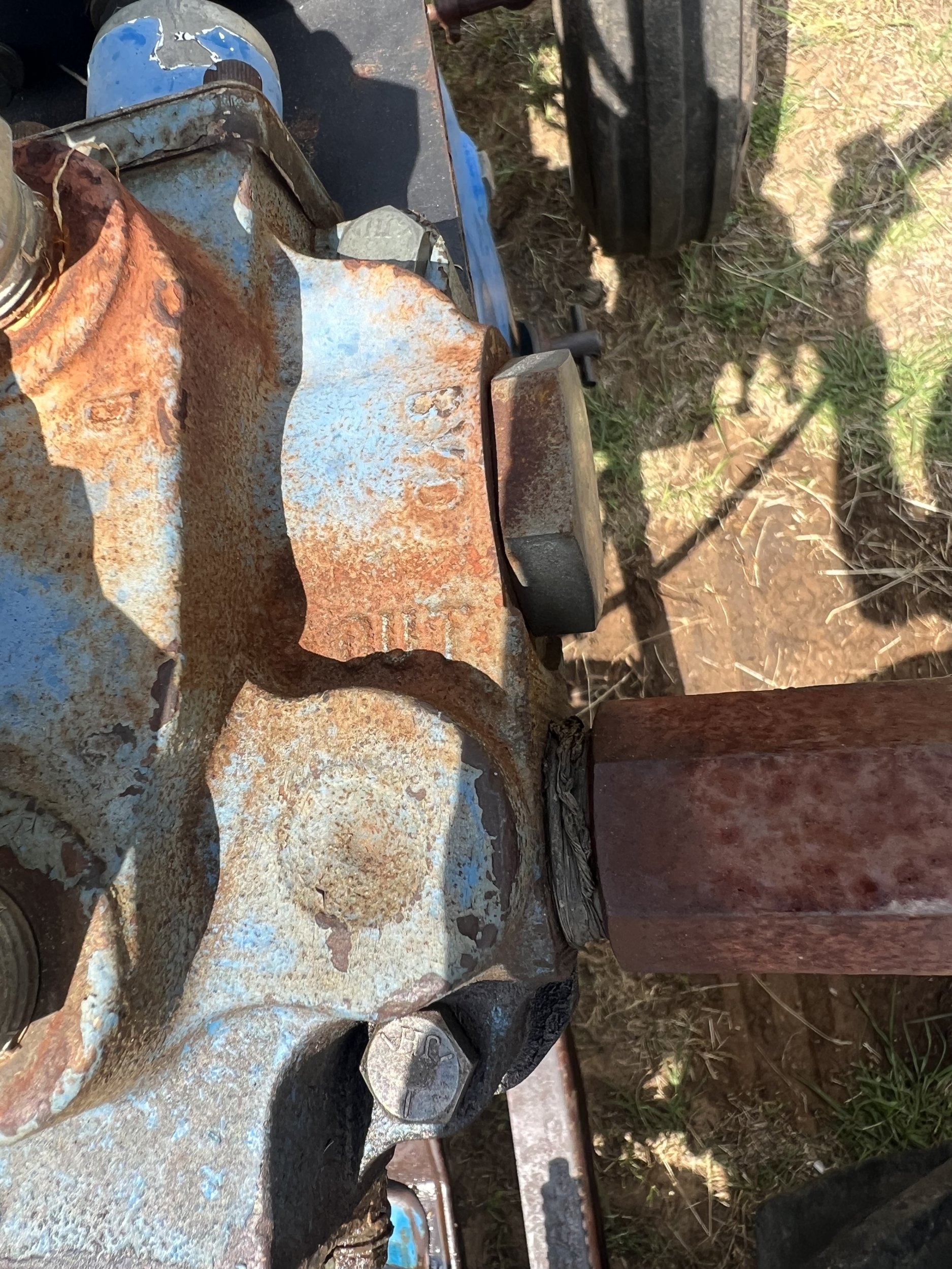

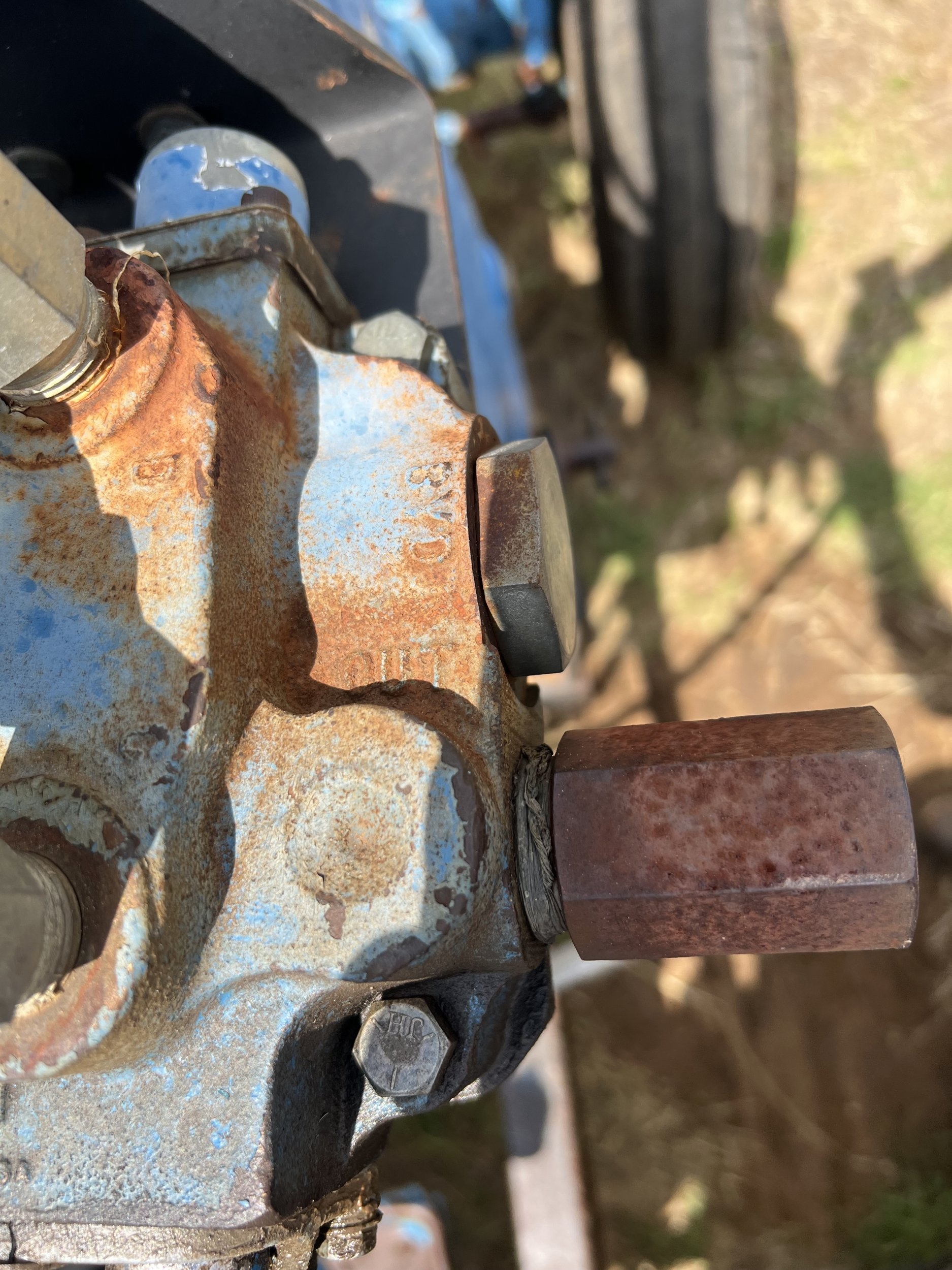

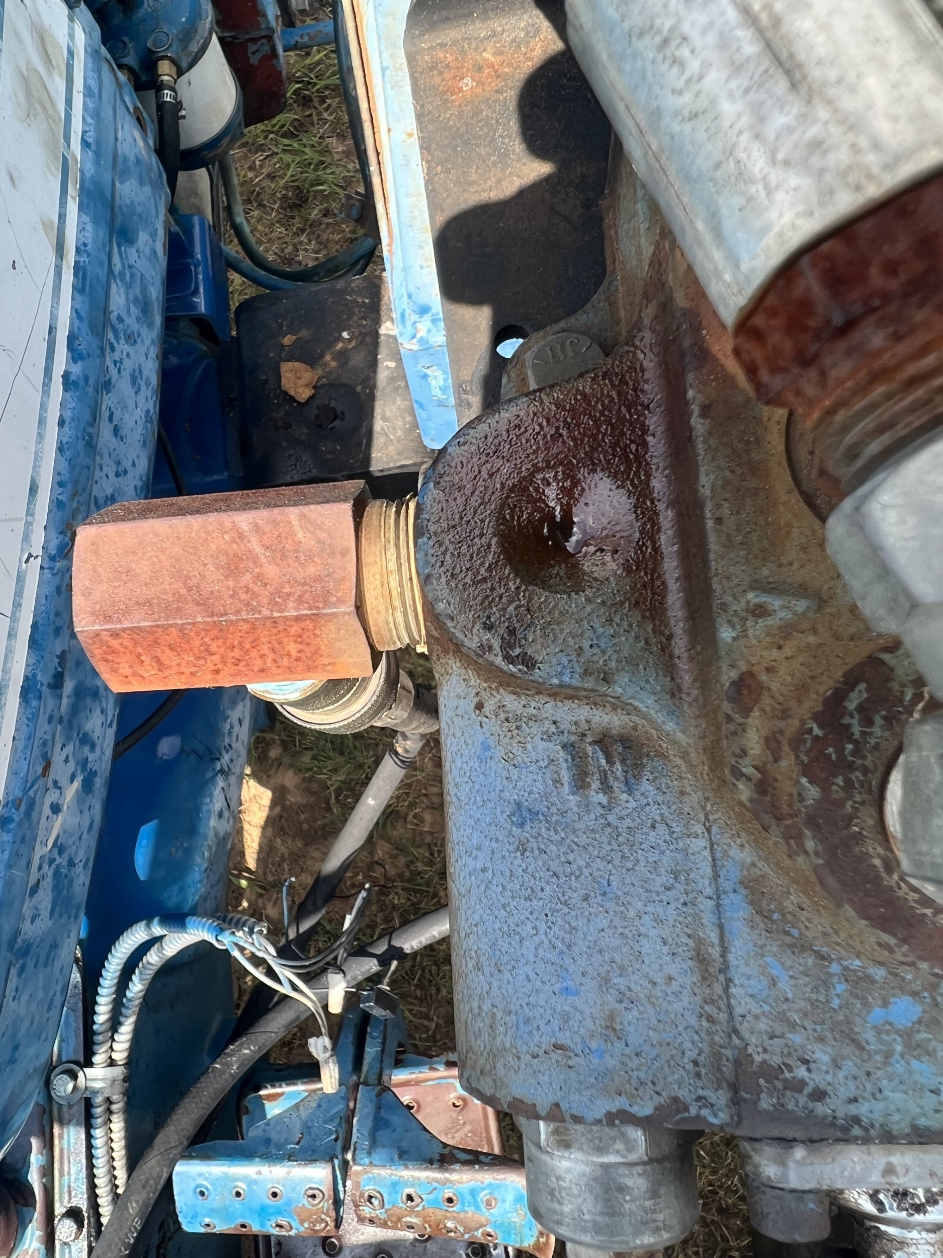

The aluminum block has 2 lines out to the loader, the third line is for a ? single action rear remote?, it currently just has a line with an open end on it because the existing one leaked and occasionally I would hit the detent valve and end up with hydraulic fluid all over me. The loader does have a BYD port which I guess is the Power Beyond but please educate me, is the loader configured properly? Is the single rear remote for a single-action cylinder? Is there a way to configure it for a dual-action cylinder?

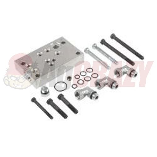

And mo, the loader valve is not properly plumbed. It may work the way it is now, but that doesn't make it right. It's obviously power beyond capable, it's even marked so. Two problems.
Problem one. You only have a pressure out and a pressure in port on the block under the remote valve. That's not the block I prefer to use. I like the one with three ports, one of which is a sump return. On the 4000 adding a sump return can be difficult. Those I'm aware of with that style block use the hydraulic fill port on the back for a sump dump. Makes it rather awkward when you need to add fluid you have to remove the return hose an fittings to get the port free in order to put oil in. With the right style block the sump port is right there.
I'm not saying you MUST do this, it's just another choice you get to make. If it's working today, it will probably still be working tomorrow, but there are down sides to operating it this way, In power beyond configuration, when using the loader the oil returning from the cylinder goes directly to sump through a relatively free flowing path. As it is now, that returning oil must go through the lift system first and then back into the sump. If you're carrying something on the lift, and operate the loader the oil in the system is performing double duty. If the lift settles just a bit the linkage directs oil flow to bring it back up to whatever position the levers are set for. When you use the loader and lift a load the return oil is also trying to raise the three point back to set point. Sometimes that works out okay, sometimes it doesn't. I've had to remedy that situation a few times before. You might take a few minutes to read through this, it may be easier for you to digest than my rambling.
Problem 2. The power beyond sleeve you need for your particular valve may or may not be easy to find, depending on what make and model valve it is/ The old Gresen valves (if that's what you have) were very common at one time, and many are still in use today. Now owned by Parker, the sleeve Parker supplies for some of them are outrageous in price.

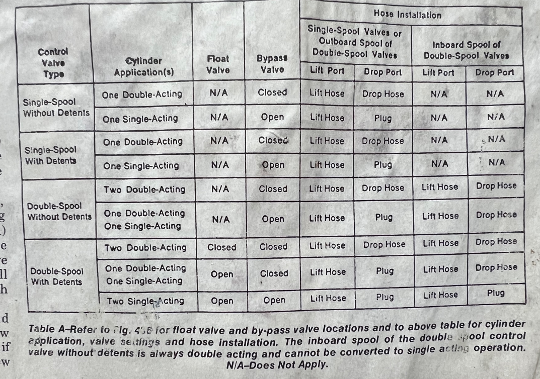

As for the single acting valve, I won't swear to this, but I think the knob on the front of it when backed out a few turns will allow the valve to operate in double acting mode. You would need to remove the plug on top and add a fitting and another hose. I THINK that may be the case. There were a number of different valves used on those tractors, not all were identical in operation.

I think you are referring to this part Tisco HV5902, which was neither hard to find nor expensive. I read your reference and I read your description and while I do not fully understand all of it, I know we want a clear path back to the sump which we do not have currently. The part I guess I am confused about is the power beyond the port and the sleeve. So what we need is a line that comes out of the PBYD port and would plug into the 3rd port on the block and/or the hydraulic fill port on the transmission case.
The issue is we would need a sleeve (adapter) that would allow us use a standard connection between these two areas instead of a plug which is what is currently in there.
Do I have this right? If not please try again.

"As for the single acting valve, I won't swear to this, but I think the knob on the front of it when backed out a few turns will allow the valve to operate in double acting mode. You would need to remove the plug on top and add a fitting and another hose. I THINK that may be the case. There were a number of different valves used on those tractors, not all were identical in operation." I found this reference in the service manual I have, I think you are correct so while not convenient. it looks like I could add a thumb and some long lines from the rear remote (I am not serious about this it looks to be a nightmare)

Yes, that is the valve block I use for this type of thing. It has all three ports, plus it has ORB ports, not pipe thread. (I literally hate pipe thread ports)
No, the power beyond port on the valve (with the proper sleeve) sends oil back into the lift system. The sump return port on the loader valve (the one now in use) goes to sump or the fill plug on the tractor. On the 5902 block I think the ports are marked. I think it's something like pressure out, pressure in, and tank. I won't swear to that.
