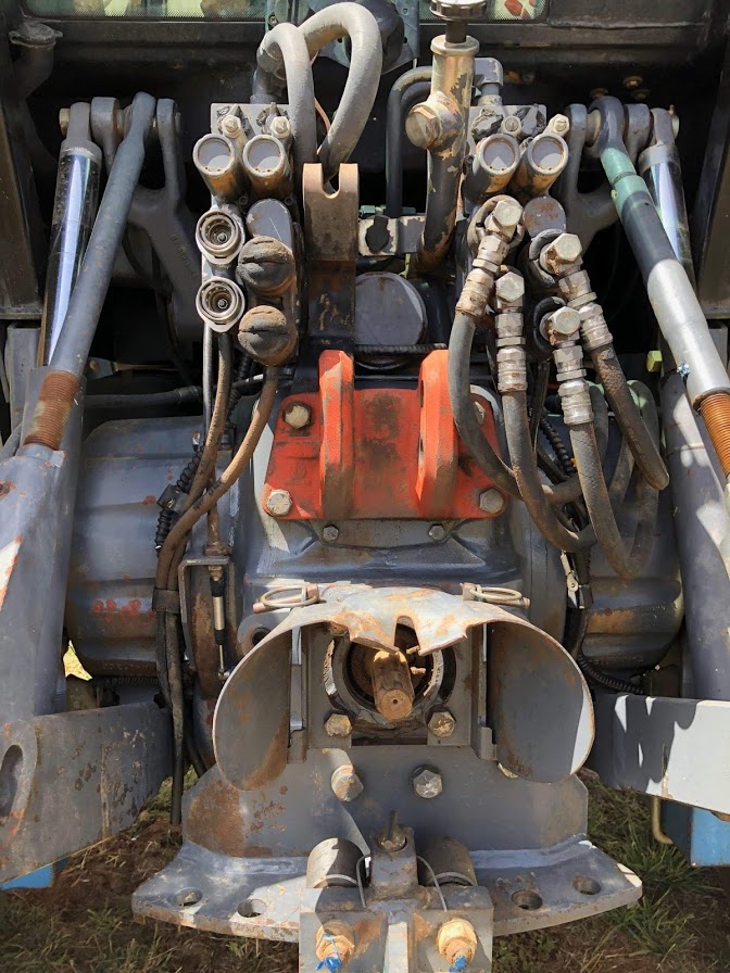

Can anyone tell me about this top link mount point on the rear of 40 series Ford? It looks to eliminate the draft control on the top link attachment? I've seen it on a few 40 series lately.
I have a 6640 and have an issue with the draft control oscillating when something heavy is on the hitch and I hit a bump or accidentally bounce it. I dont really need draft control on this tractor and am wondering if I can easily disable it as above?

You have Electronic Draft Control (EDC) sensed by the load cells in the anchor pins for the draft links. Set the EDC dial to the minimum response.
