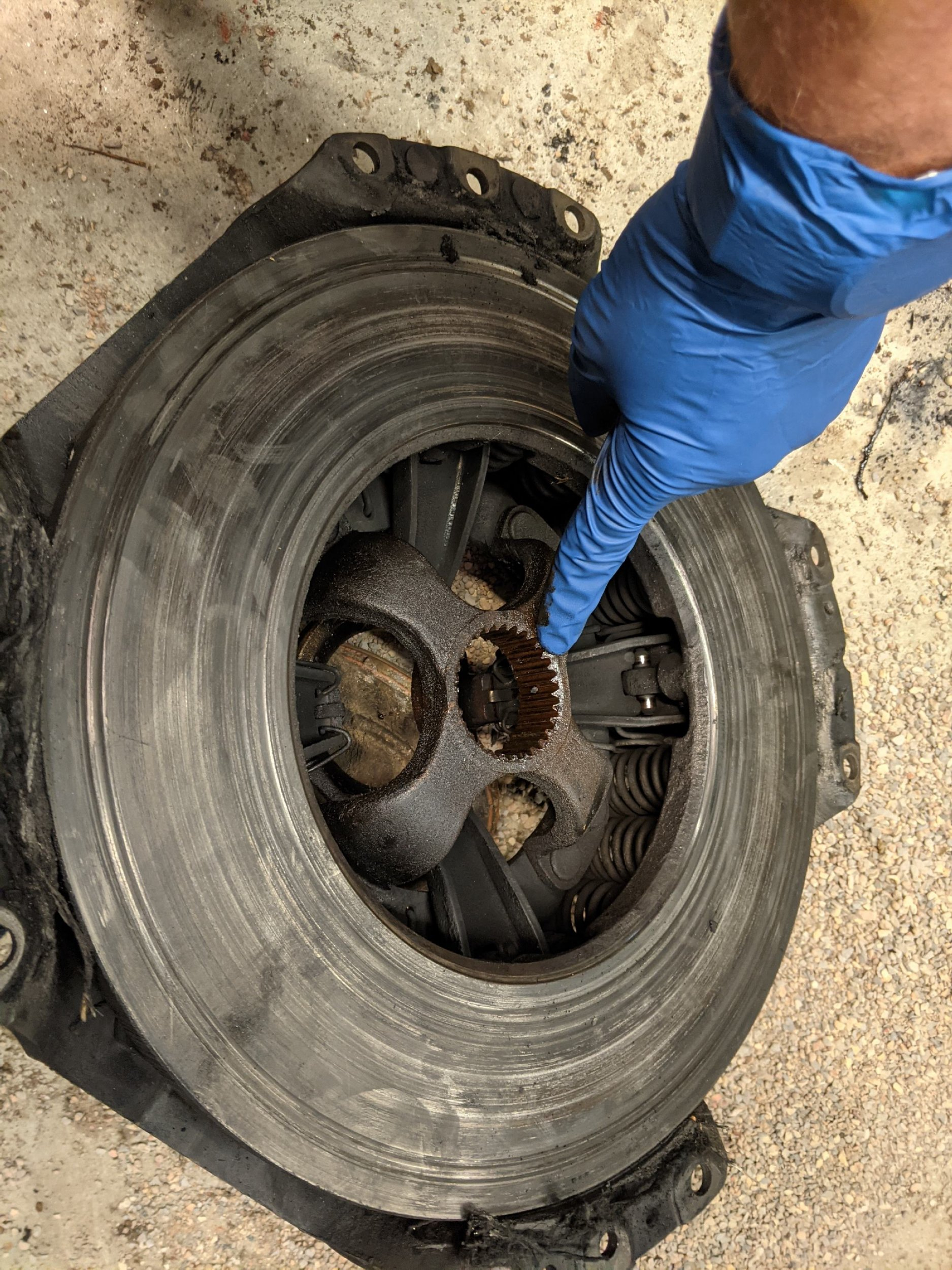

Well, the tractor is split.
I just took over maintenance for this tractor. My dad has been using it for the last 10+ years with nothing but oil changes and fluid top offs, and yes it has a loader... :eek: Thankfully, I convinced him it was time to get it into the shop.
The clutch pedal was very bad out of adjustment. Instead of ~1-2" of free play, it had around 6-8"! At that setting, the clutch would not fully disengage. Depressing the clutch pedal would stop the tractor, but the gears would keep spinning and would grind if you tried to shift. Adjusting the clutch to the correct amount of free play fixed the gear grinding issue.
The T/O bearing spins freely, but has a bit of click to it. Maybe a damaged race? It'll be replaced in any case along with the clutch and pressure plate. There does seem to be a bit of resistance spinning the outer (drive gear PTO shaft) from the bell housing end. I still wonder if there may be an issue with the input bearing. :(
Pictures for your viewing (dis)pleasure.

Excellent Pictures. I think what has happened is due to mis adjustment of free play (too far rather too close) when you clutch all the way it could not separate friction disk from surface of the flywheel and the pressure plate cleanly and as a result it kept spinning parts (flywheel and pressure plate) against stopped or slow spinning friction disk an wore it it that manner long strands of friction material (asbestos or non-asbestos) came ff. Out of abundance of caution you might consider those ACM (Asbestos Containing Material) and not breath it in and just wet wipe with brake cleaner and dispose the rag in a bag and then tied off. Those are nasty stuff for your lungs. I was saying you might have a bit of time but I guess it passed that by a long time. As they say, it is cost of doing business and clutch is a wear item. it appears that you have dual stage clutch,live PTO. is that correct? Well, I am glad you'll be back in business soon. Great pictures again.
   / Ford 3930 bad input shaft bearing?
Glad you liked the pictures. I figured if I'm getting good advice for free the least I can do is my part to be helpful.
Good call on the ACM. To the best of my knowledge this tractor was manufactured in '93, so those clutch filings are probably pretty nasty. I had planned on doing all appropriate ppe as soon as the tractor was split, but I couldn't resist getting the clutch off first. 👻Appropriate precautions will be taken when cleaning and refitting.
To answer your question, no this is not a dual clutch. The pto clutch is fully independent, hydraulically engaged. It's located rear of the trans and operated with a single external lever. Also, I was incorrect in my earlier post. The hollow shaft bonded to the flywheel through the clutch housing is the PTO. That's the one that seems a little rough when spun by hand. The inner drive shaft seems fine. Maybe an issue with the PTO clutch?
Either way I'll get the drive clutch replaced and tractor put back together. If the noise is still there I guess I'll split at the rear of the trans and try to see what's going on.
