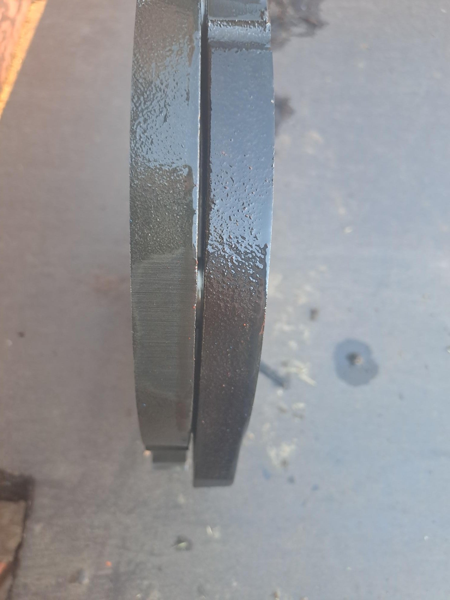

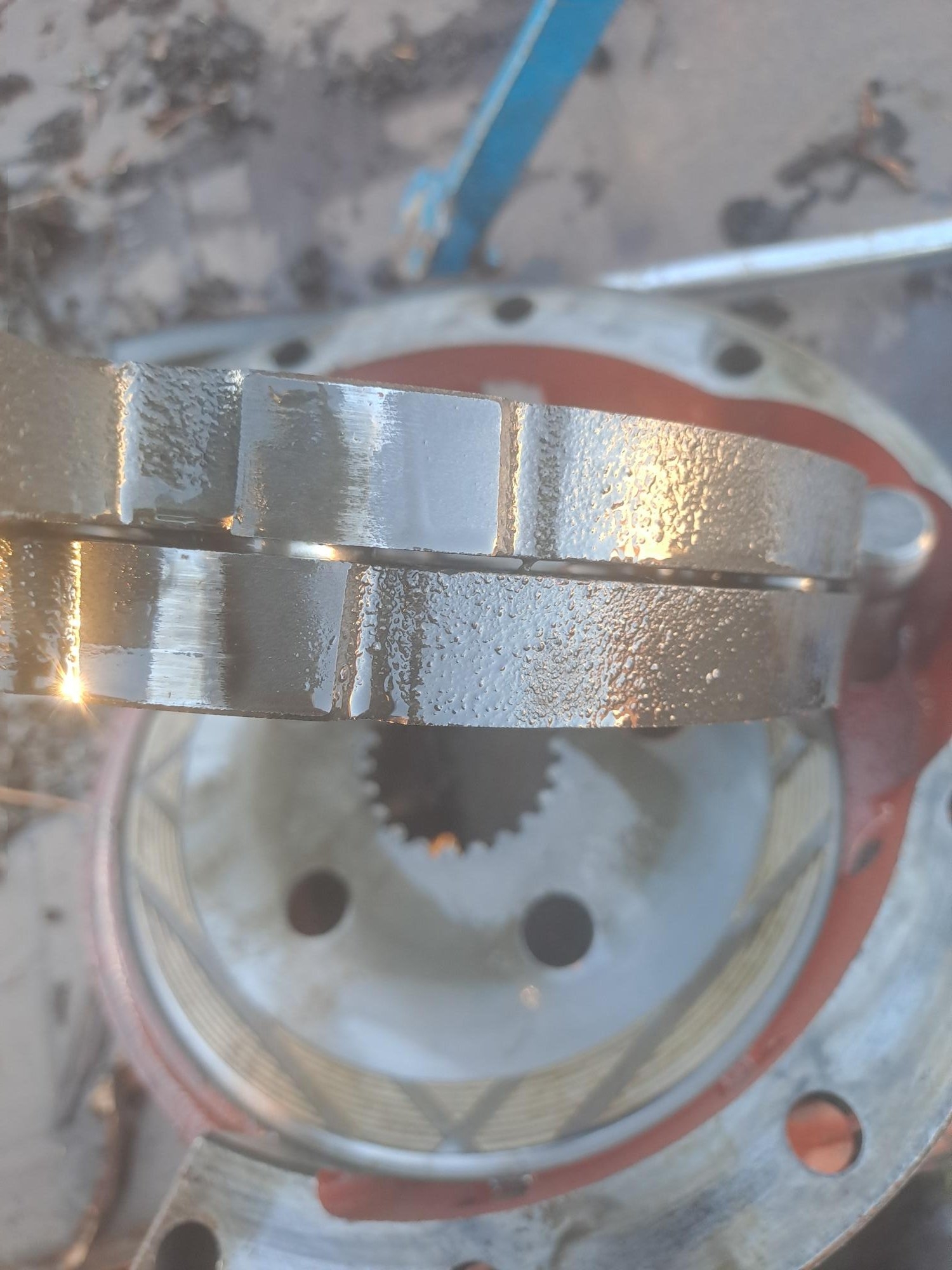

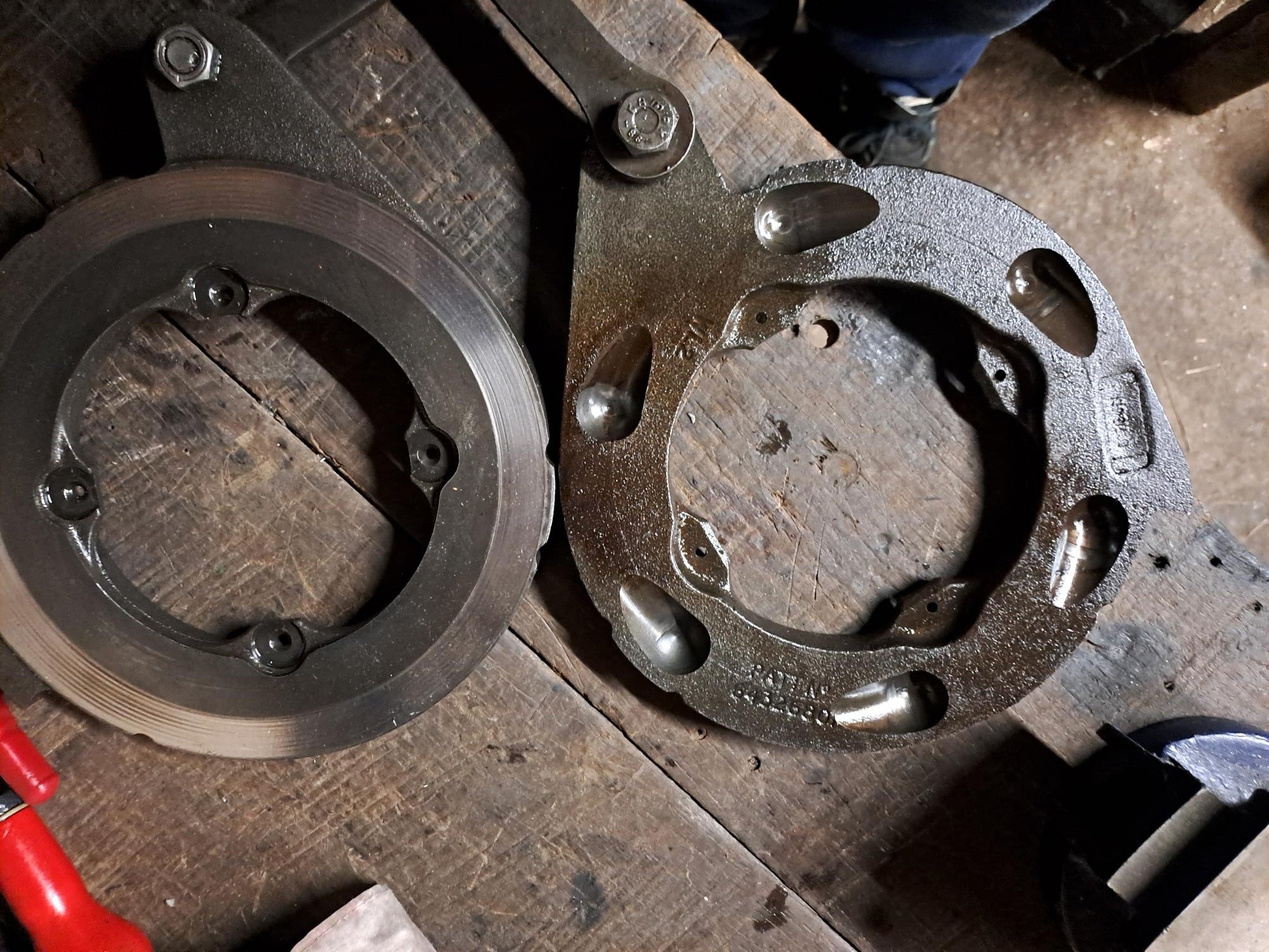

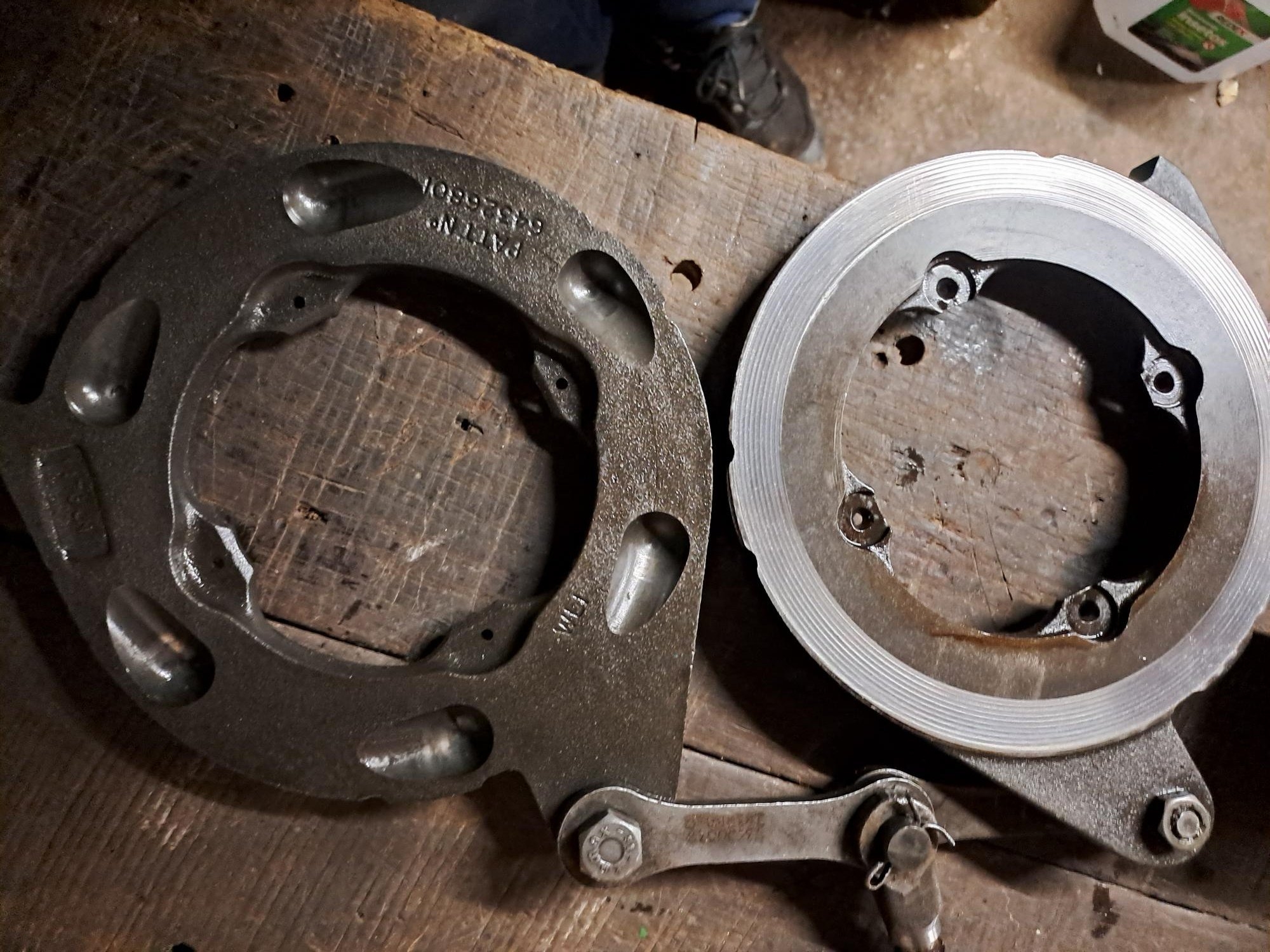

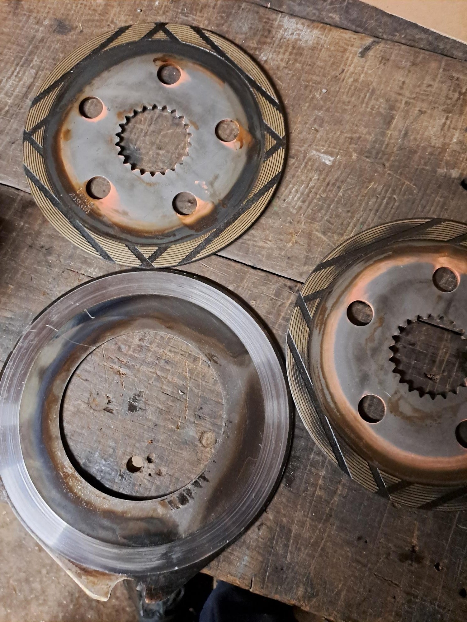

Hello,
I´ve already disassemble and it seems OK to me, could you give me your opinion?
I´ve also got a video, but don´t know how to upload it.

   / Ford 3910 wheel braking by itself #7
The picture of the steel discs shows overheating. The actuator ball ramps are cupped at the deepest point. I'm wondering if the brakes were adjusted too tight and the brakes were always just dragging on that side.

I´ve tested them assembled again without any adjustment and the failure does not happen anymore.
It seems to me that it could be that they were in fact were adjusted too tight, i didn´t take that into consideration when I disassembled them.
I also noticed some dirt, in two of the spheres wholes, it looked like some small metal chips in it, and that could also make the spheres not to return correctly into their place.
I will now add the missing oil and adjust the brakes again to see if everything is OK.
By the way, any hint on how to correctly adjust the brakes?
