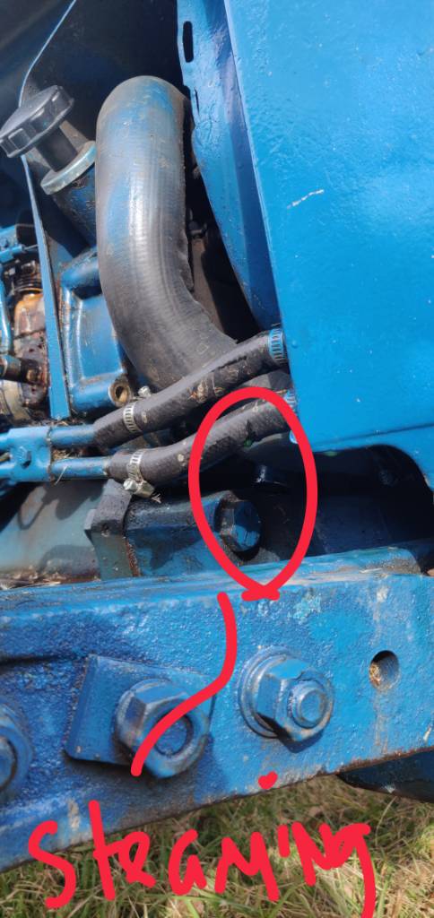

Hi everyone, I'm pretty new to tractor ownership and look forward to learning and contributing to these wonderful forums.
I recently purchased a Ford 3600 and think I may have been taken advantage of by a dishonest private seller, who claimed that the tractor was in perfect mechanical condition and that he routinely used it for farm work. I'm hoping this does not prove to be an expensive lesson for me.

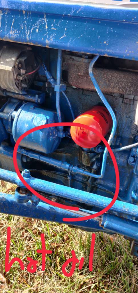

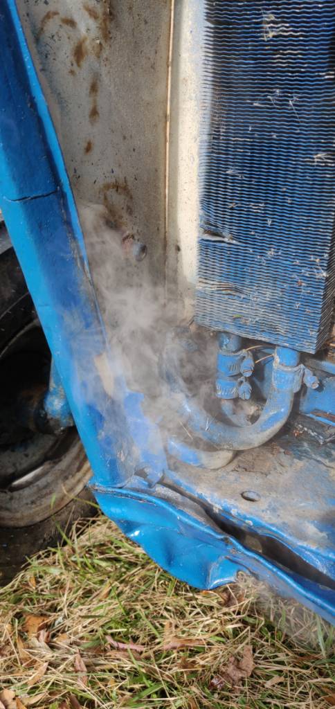

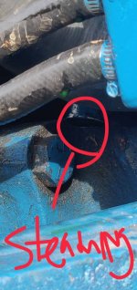

I used the tractor to bushhog my fields for a few hours on the first day I had the tractor. Had a couple of problems that I was able to diagnose and fix. However, after about an hour of work, the radiator fluid started steaming badly, hot oil started leaking, and white/light gray smoke started coming from the exhaust. None of the indicators or gauges work on the tractor so I didn't realize there was an issue until everything was pretty hot.
I turned off the tractor, let it cool down overnight, and then set about to diagnose the issue. I realized that the radiator grill and oil grill had been clogged fairly badly by bits of airborne debris from all of the stuff I had been bush hogging. I figured this was likely the cause of my issue and was probably my fault. Just for good measure, I cleaned out the radiator grill and oil grill, and then for good measure performed a bunch of other routine maintenance tasks...changed the oil and filter, changed the hydraulic oil and filter, changed the fuel filter, topped off the radiator fluid, etc. The radiator fluid and oil were both really low...even though they were fine when I checked them before starting work.
Cranked her back up the next day and she seemed OK. Took her out to finish bushhogging but within 30 minutes she started overheating again. This time the overheating symptoms occurred rather quickly. Again I shut her down to protect the engine, but I did manage to snap a few seconds of video showing the radiator fluid steaming. Hot oil also started leaking from somewhere on the right side of the tractor. Unfortunately, since cooling her down, I've been entirely unable to get her cranked back up. The engine will try to turn over but won't start. I've tried several times over the past week with no luck.
Trying to figure out my best plan of attack for diagnosing and repairing the issue. What do you think it might be? Radiator hoses and cap seem old but in operable condition. Is it the radiator itself? The water pump? Thermostat? Or did I blow a head gasket?
Very much regretting this purchase right now but hopefully I can salvage my investment without sinking too much money in.
I've posted pictures and look forward to your responses. Unfortunately as a new member I cannot yet upload or post a link to my videos but maybe someone has a suggestion for a workaround.
Thank you!
Matt

You are losing coolant and oil. Run it for diagnostic purposes ONLY! Don't take it to the field in that condition.
Fix one problem at a time. When a tractor overheats, steam will come out of the radiator cap, not from hoses. Replace the leaking hoses. Leaking coolant hoses will cause an overheat condition. Fix the hoses first.
Looks like the oil filter was not installed correctly. Check to be sure there is only ONE rubber seal on the oil filter. It's not uncommon for a seal to stick to the engine and be over looked. When the new filter is installed over that seal, the filter will leak.
It does appear that the oil may be leaking from the oil filter seal area.
Check for the double seal issue as suggested.

Thank you! I will double check the oil filter. I might have missed removing the old seal. I agree that it seems like the oil may be coming from the filter. It would be a relief if that is one of my problems.
The pipe that is steaming points down and is not connected to anything. Am I missing some sort of fitting?
   / Ford 3600 overheating #6
The pipe is a breather tube. It's connected to the valve cover by a short rubber hose. If you open the RH side cover, it should be visible at the front of the valve cover. It's normal for this to smoke if the engine is hot. The tube keeps pressure from building up in the engine crankcase. It must remain open.
