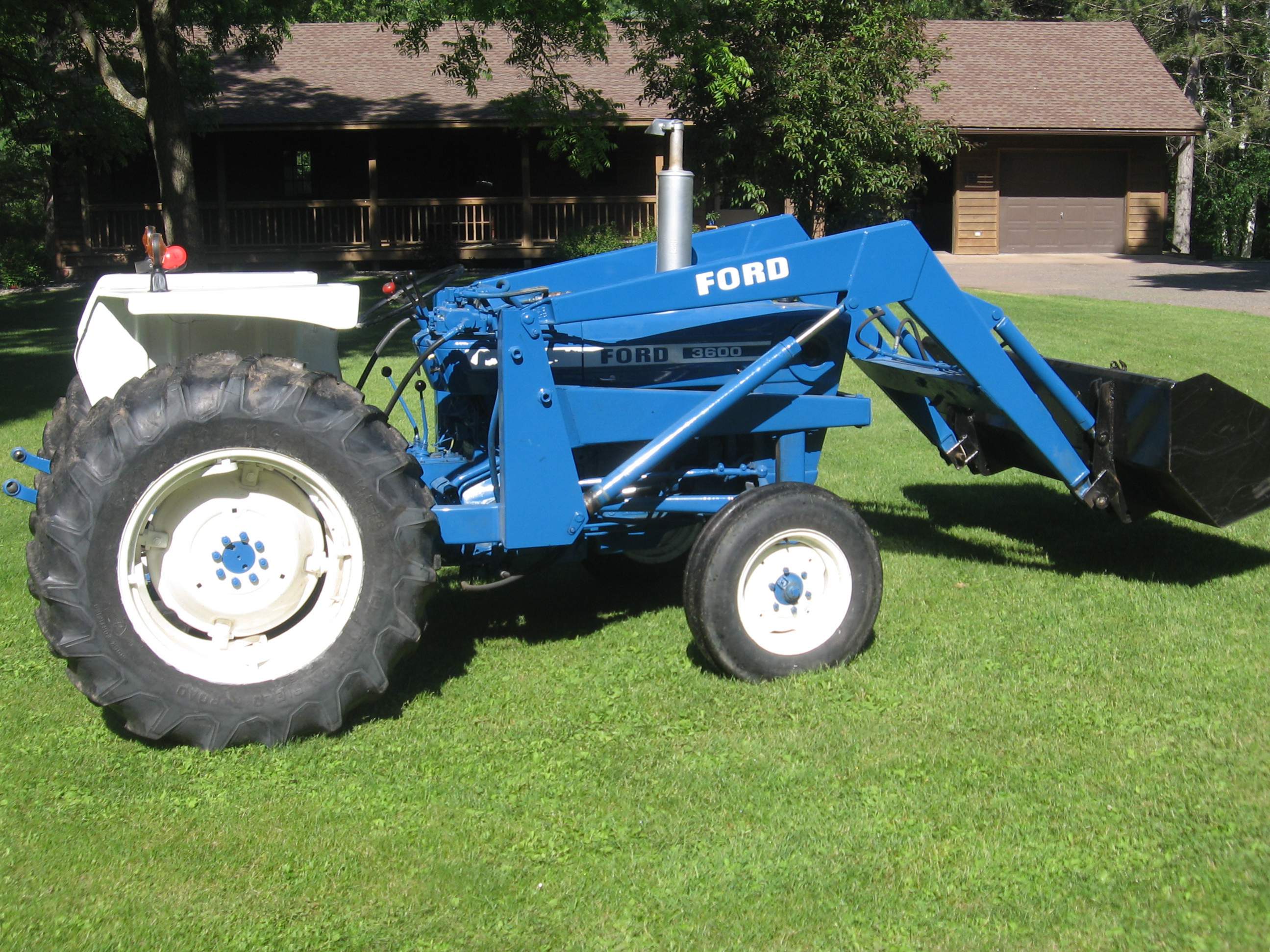

All in all I'm very happy I have a FEL on my 3600. I use it all the time in ways I hadn't thought of before I had it. See pictures. IMG_2296.jpgIMG_2295.jpg

Is that a factory loader you posted in those pictures, lorandroehl? Anyone have any suggestions for an aftermarket model?

I believe this is a factory loader, but am not sure as it was on the tractor when I bought it. It had been freshly repainted with new decals prior to my ever seeing it. Others may tell you different and they could be right as I am not that well informed about the looks of different loader models.
Also would rely on others for an aftermarket FEL model suggestion. Just make sure it is well compatable with your tractor.

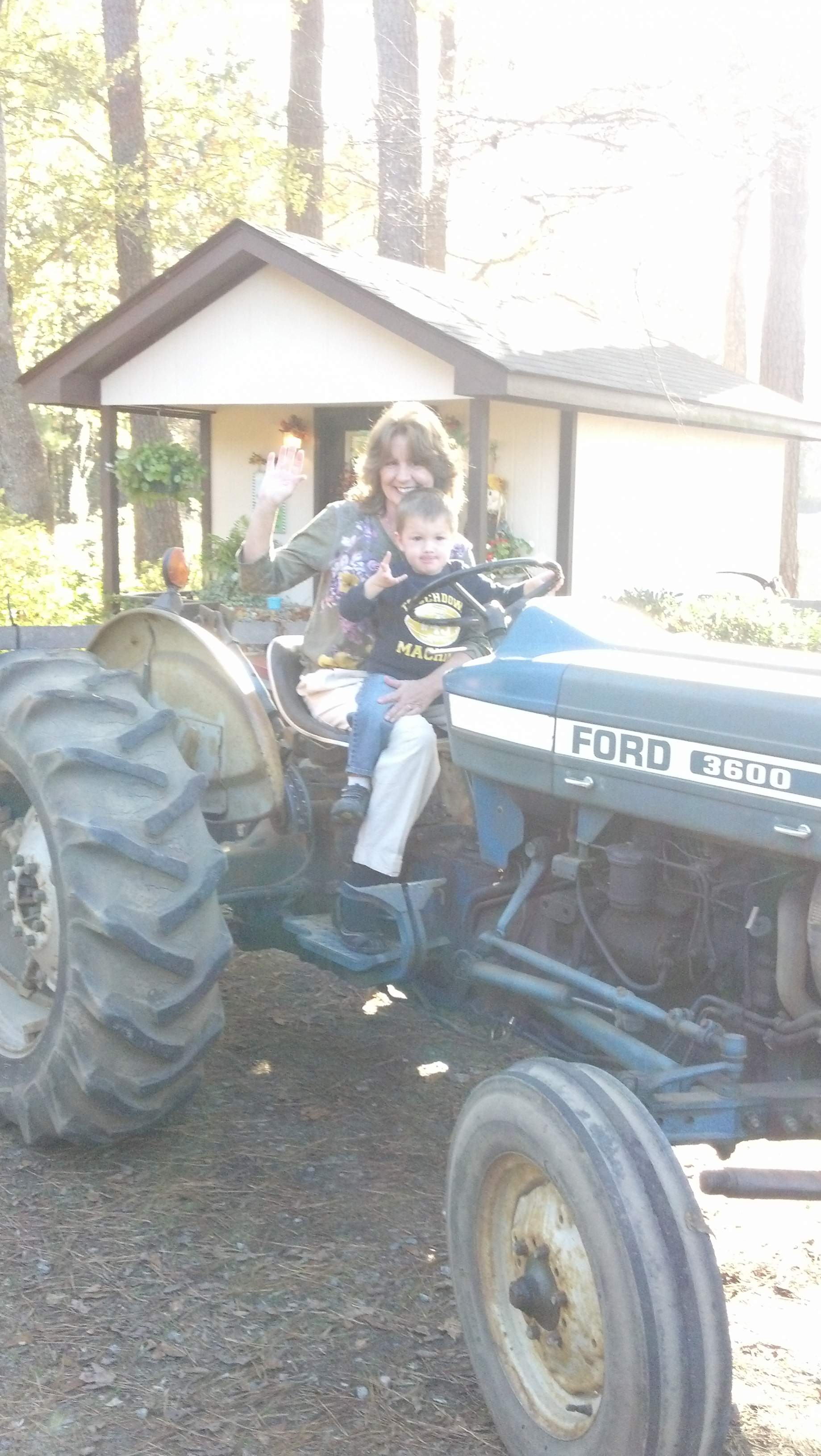

Here is a quick photo of the tractor, from our last trip to GA. I'm unofficially inheriting the 3600, but will be next summer before picking it up...I know ya'll were dying to see it!..haha. I think it will clean up nicely. After a little research, the Allied 295 may be a good aftermarket loader purchase. I couldn't seem to find a new bush hog that is made specifically for the 3600, but haven't yet talked to a dealer either. Thanks for the info and sharing the pictures - this is a good forum.
