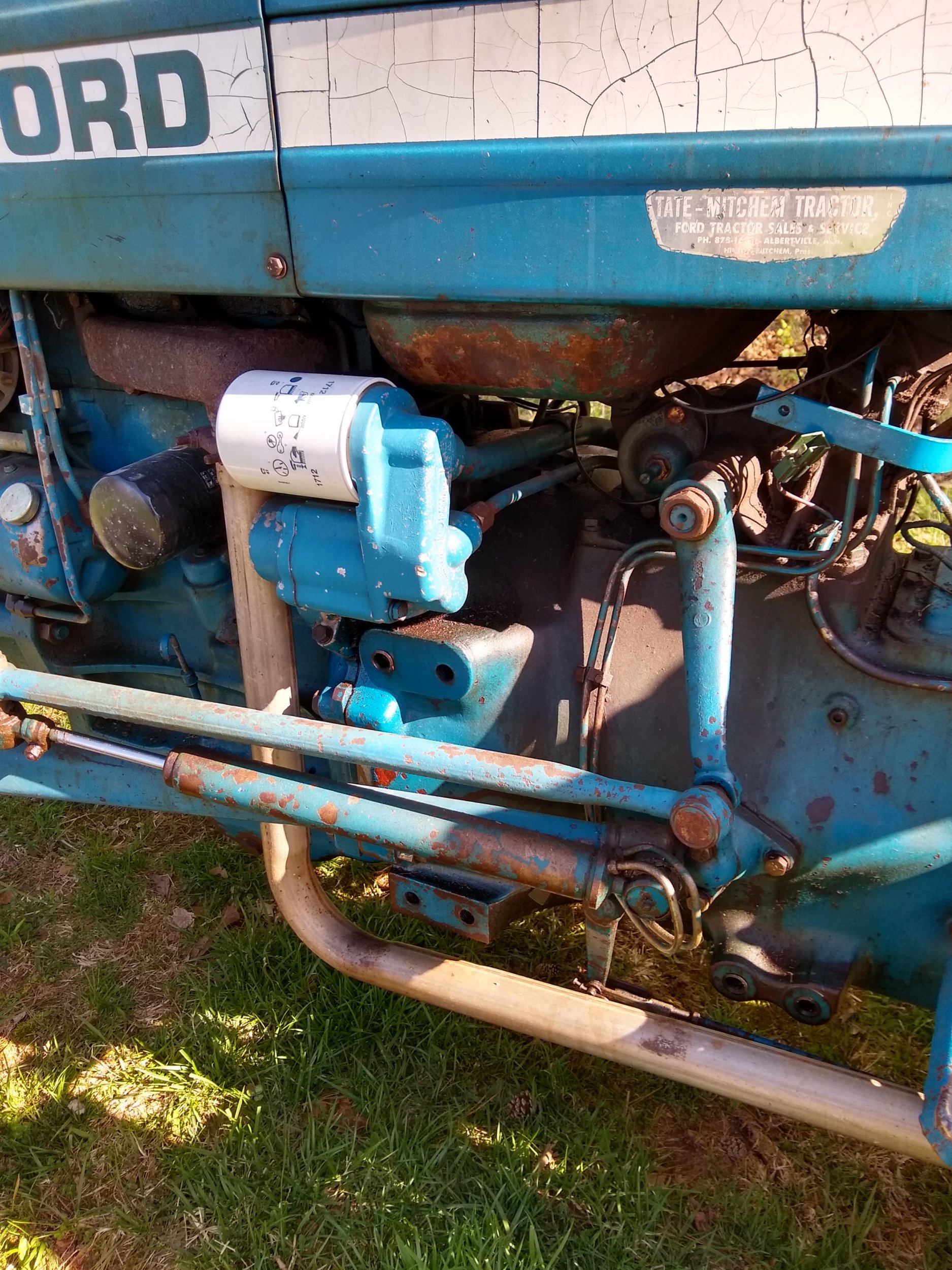

Took the tractor out this morning, noticed a significant coolant stream leaking from the right side under the starter. It was in the garage with antifreeze in the coolant. I suspect a corroded or displaced engine casting plug or a crack in the block. It is not the top one.(too easy) Did not see any evidence of water in oil. I need to split the tractor to find out what happened. Steering linkage ect, exhaust, tacho cable, wiring, stays with back.
What to do with hyd pump? it has two lines. The small line has a fitting so no problem. The big line does not have a fitting and it goes across the tractor to the right side, then down...and along the bottom to the rear diff. Is there some way to split the pump? Am I missing something easier?
   / Ford 3600 coolant leak near starter - how to split #2
The suction line is a slip fit into the pump housing and sealed with an o-ring. Disconnect the pressure line then unbolt the pump from the block and pull it free of the suction tube. Leave the tube more or less in place. Replace the suction tube o-ring and pump mount gasket.
