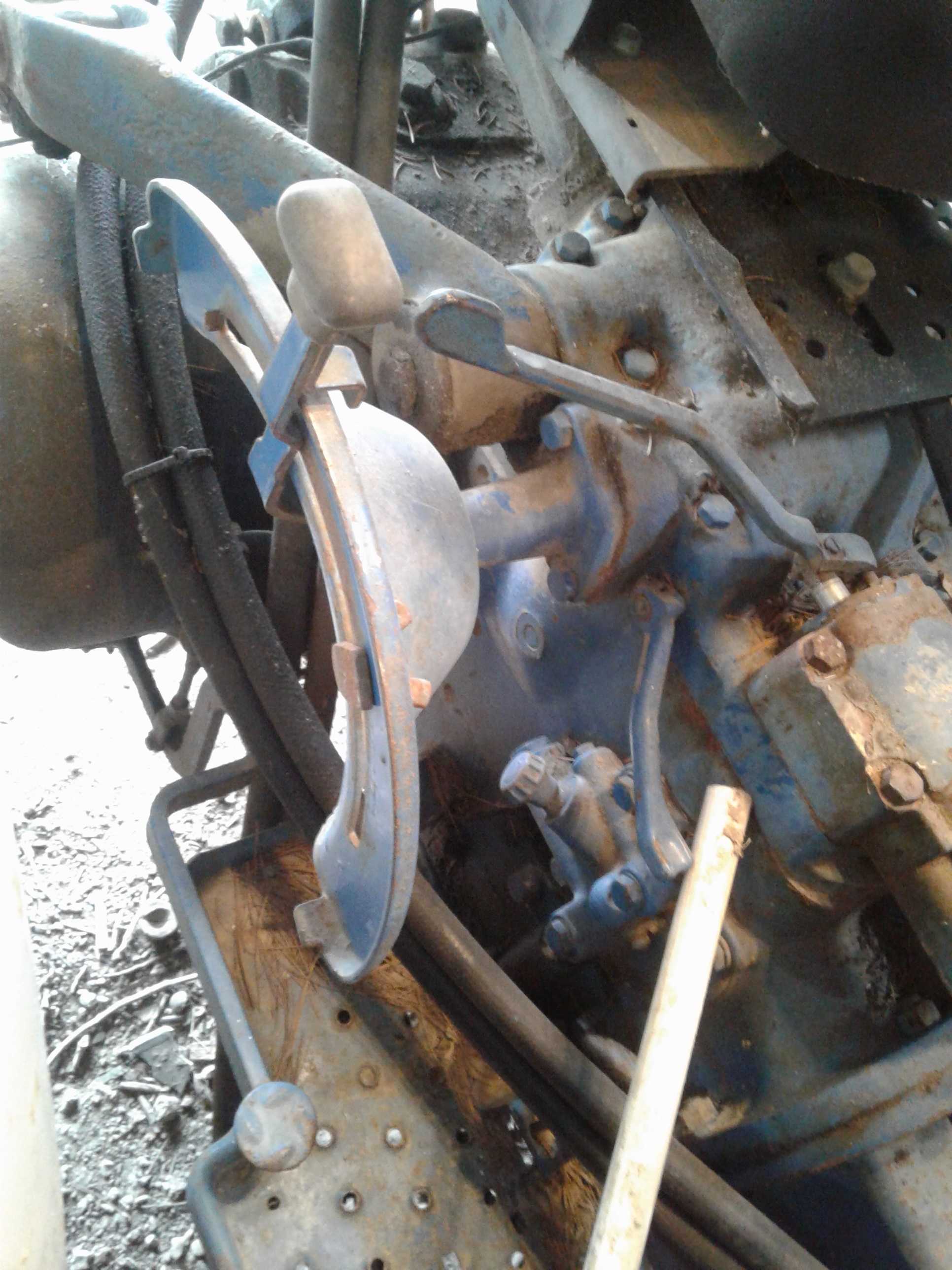

   / Ford 3000 #6
I did notice that the lever that switches hydraulics from lift arms to auxiliary hydraulic lines does not work properly. On other tractors when you move the lever it normally springs back, on this tractor it feels like it is partially stuck?
Om my F4000, I have a lever that switches between positional control and draft control of 3pt (next to pvc pipe). Above that is a flow diverter to select FEL or 3pt. Diverter is my biggest complaint when scooping up rock to rebuild drive (3pt won't drop or bucket won't curl - diverter in wrong position) Nether of these controls "return to center" never intended to.

   / Ford 3000 #7
Ditto on #7's reply. I see that your remote lever is in the remote position.....part of the shiny shaft is showing....this needs to be pushed forward.
Just to the left of the tip of the pvc pipe is a round knob. This is the flow volume control. It has to some number of turns CCW for fluid to work...opens allowing variable flow. The other thing is the lever adjacent to the end of the PVC pipe. Different from mine but see if it will pull up to a vertical position. If so, with what I already said, after what you did, the 3 pt lever should raise. Come back if it doesn't.

   / Ford 3000 #10
Funny, my mom called me today about her Ford 3000 3 point not working.
I went over this evening and it was in draft control.
Anyone know why it has to be in draft control mode to be able to move the remote hydraulics lever?
I find you terminology confusing 3pt hydraulics and remote hydraulics are different things to me. My picture in post #6 the 3pt mode selector is in positional control, flipping lever up the 3pt is either up or down no in between (lever selecting amount of draft). Lever on top is a flow diverter and selects sending oil to 3pt or remote devices (FEL for me)
If the large 3pt lever isn't working in positional control, it may have internal issues. Being a popular tractor, I'm sure youtube videos exist on 3pt repair and adjustment.
