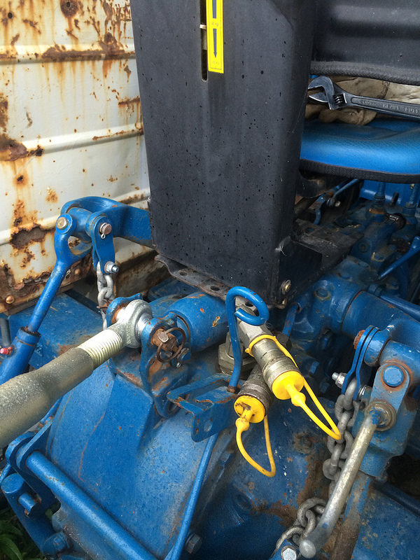

Hi again guys!
I have checked the hydraulic fluid level by removing my check plug which is shown in the attached photo. It looks slightly different to the example above. Maybe because it is UK built? When I remove the check bolt, nothing comes out therefore I assume there isnt enough hyraulics fluid in the system?
I have looked for where the filling bolt is but I cant find it. I am wondering whether I need to remove the open return hydraulic port which looks like it might have been added as an aftermarket addition? Maybe I need to remove the whole seat and it is somewhere not obvious?
Thanks for your help. Its working great at the moment pulling out trees in a norwegian forest.
   / Ford 3000 Weak 3 point Hydraulics with Shudder #7
In the last photo -on the right side the upper line with the elbow is threaded in to where the fill plug would be. It holds about six gallons to be full.
of course depends how low you really are. If real low should add a can or two of Trans Tune to it as well. Check if drain plug on the bottom center of rear axle is tight or could be leaking. Just forward of the drawbar on the center carrier. hope this helps.
