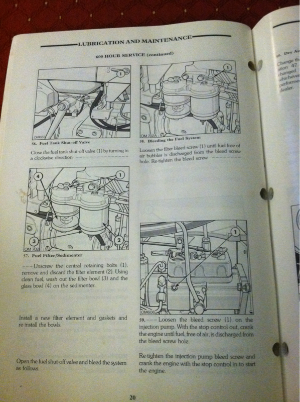

It's the rotary CAV/Lucas pump. Looks like the one below.

hmm.. the cav are pretty good pumps.. and fuel lubed.. so no cambox to run out of oil.
return is not blocked is it?

It could be. I really didn't know what to check except for fuel squirting from the bleed screw.
It's covered in oil and grease so I'll have to look for the return.

Oh, I also loosened one of the injector lines and checked for fuel flow there when turning engine over. Again, it came out but I don't know how much pressure is required.
   / Ford 3000 driving me insane! #10
pressure is a combination of flow and resistance.. with an injector line cracked open.. you will have very little flow and no resistance.. thus no appreciable pressure.
