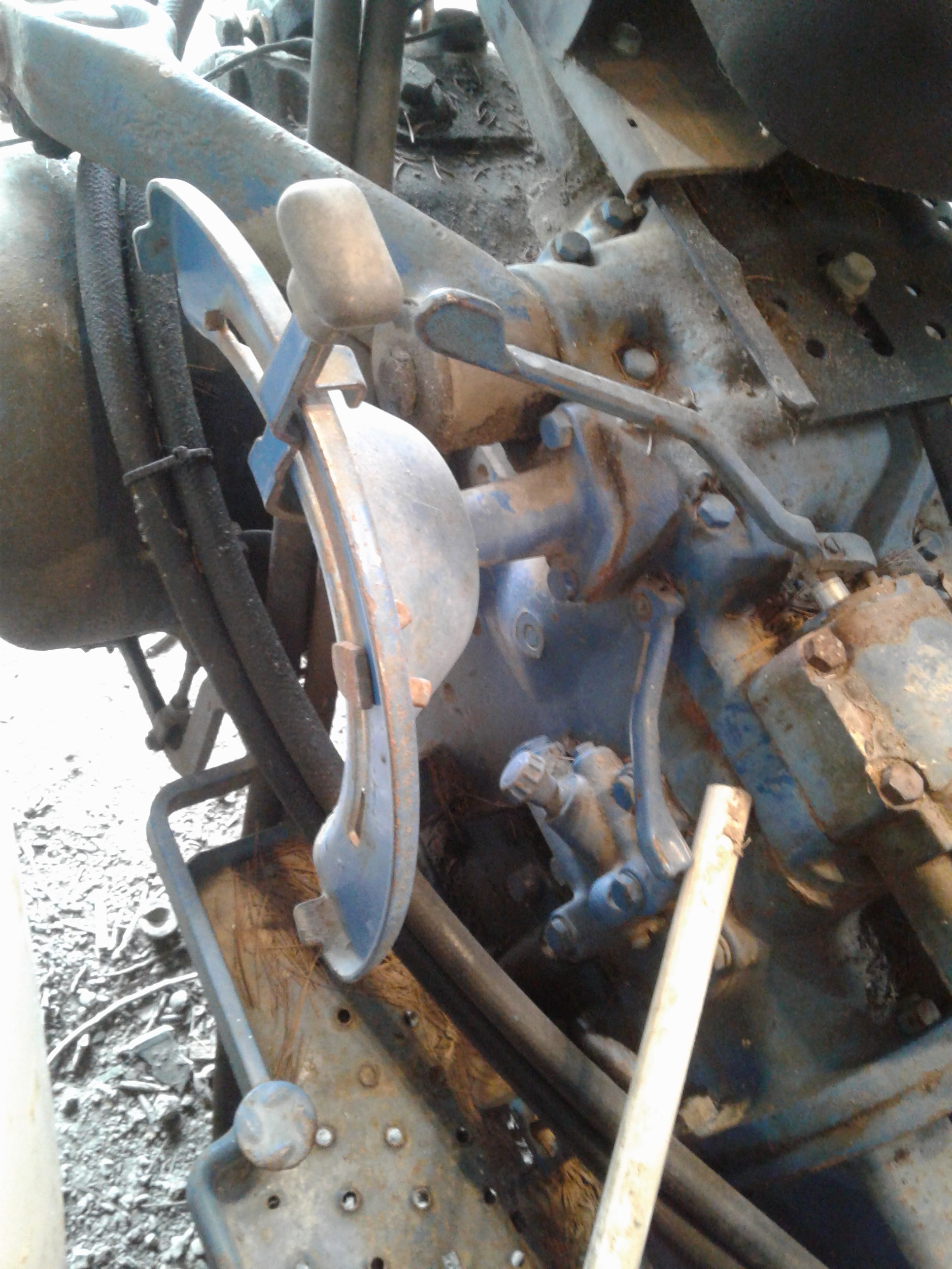

Draft control doesn稚 seem to work. Lever moves freely and doesn稚 seem to be engaging any other mechanisms.
   / Ford 3000 Draft control #2
This is an F4000. The lever by the pvc pipe is a draft/positional mode selector. It in positional now, raise it for draft. The large lever raises/lowers 3ph. Lever on top, a flow diverter to operate the FEL. The top link on the tractor is spring loaded. is a pin inserted in an extra hole to make it a fixed attachment point? There is a nut or knob to adjust tension on the spring. Don't know how adjustment works so I leave it alone.
