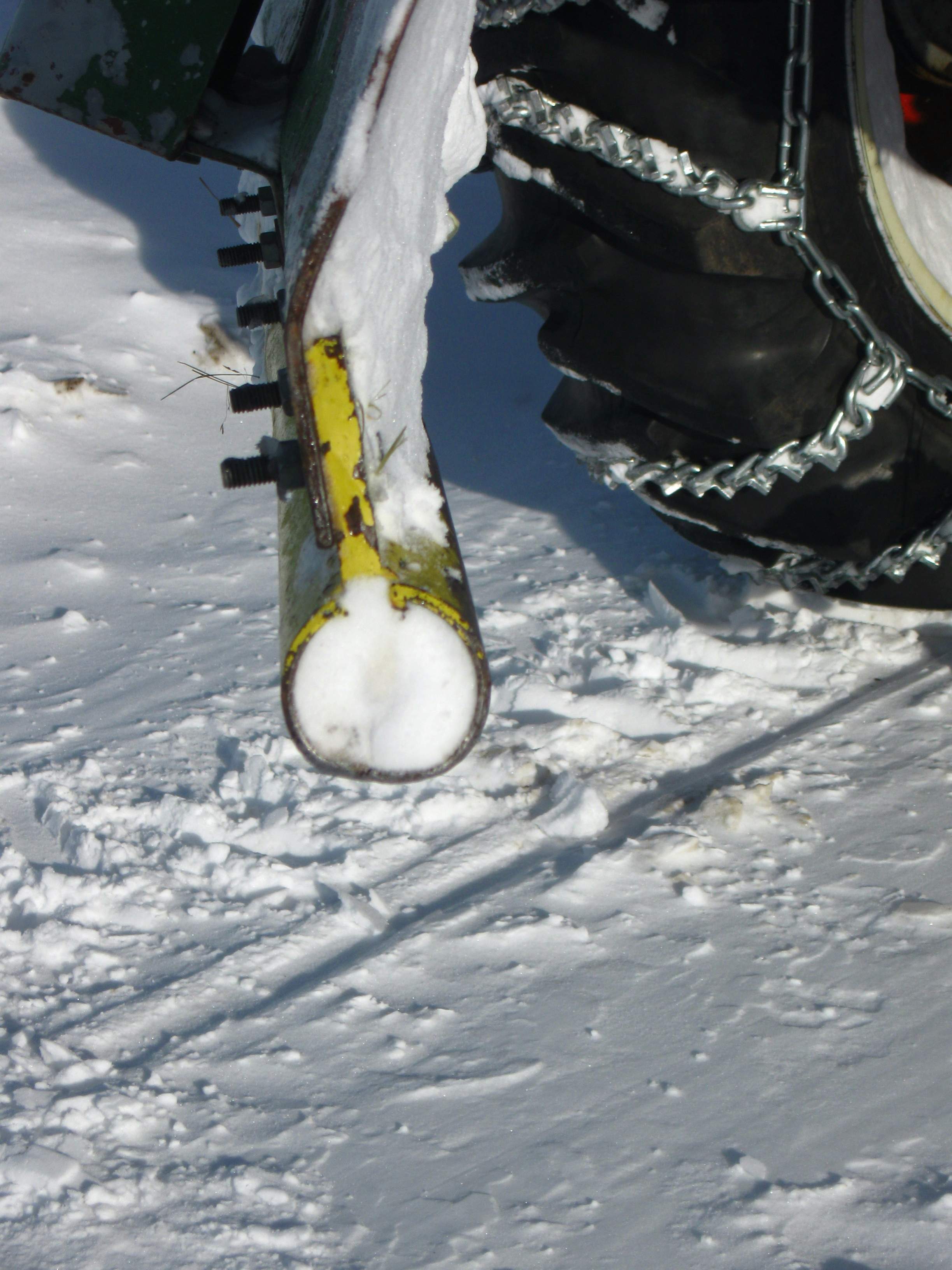

I made the attachment to my back blade back in 1988 and use it to move snow off my gravel driveways. I used a 2 inch schedule 40 pipe and a 3/8" x 6" plate the width of the back blade in length. I slit the pipe and slipped it over the blade and welded the whole works up. I drilled holes in the plate to match the back blade. In the summer I mount the grader blade on the blade and in the winter I put my homemade snow edge on. The large radius of the pipe minimizes the moving gravel. You can do this with a front blade or a rear blade. The key item is the large radius of the pipe.
You are going to have to weight your back tires and get some good duo-grip chains to do what you want to do (see www.tirechains.com).
