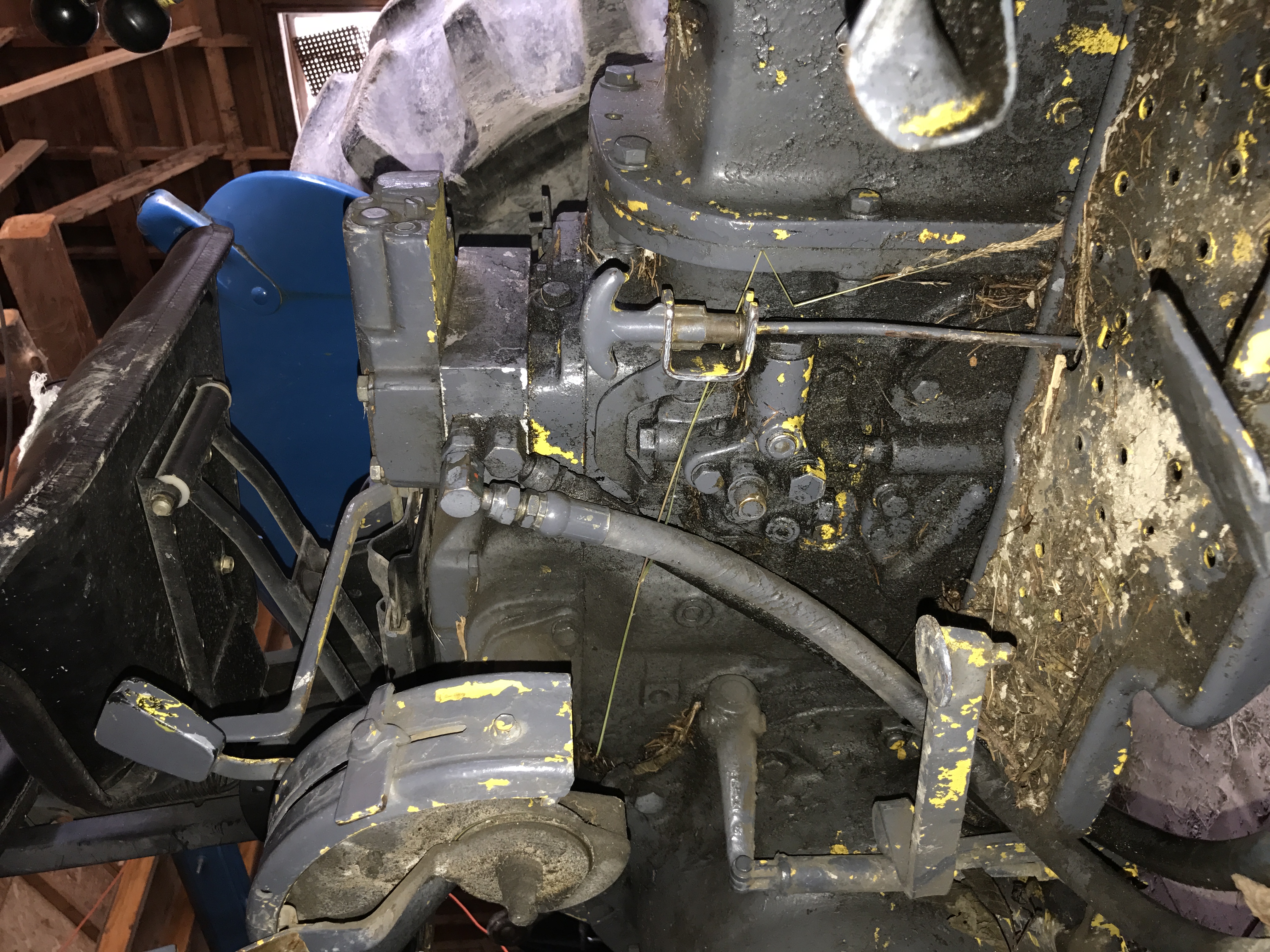

Hi all
yesterday morning i have move a big ciment block with the bucket i seen one of my tilt cylinder leaking a little by but its long time his leaking . I park the tractor after the move but at the end of the day i bring back the tractor to the barn but the 3 point lift by it self and jam in up position i also feel the joystick stiffer and i have hard time to drop my bucket . If i put the float fonction the bucket lift ???? before yesterday all was ok .Do you thing my cylinder can give me all these issue .Or my joystick?

how do you have your loader hyds plumbed? from an under seat add on spool valve that sets on the hyds cover Blank off area? ASC valve or?
post back then we can help more.

I put some picture to answer to your question but its look like the hydraulic bypass I have disconnect the front end putting a union between pressure line and the return line of my joystick and my 3 point still do the same (3 point lift alone and stock in up position) , I also try to just cap the to line for my joystick feed and return and I have no more hyd pressure to operate the 3 point so now I'm think the problem is related to the 3 point hydraulic system but I'm not sure what I should start to inspect ? the sandwich plate for a busted o ring or find a defective check valve? IMG_0590.JPGIMG_0598.JPG
   / ford 3000 3 point jam in up position #4
Ok, so are you using a power beyond plate and pb capable valve?
If yes, and its plumbed correctly, its possible that your unloading valve is stuck in the lift position.
   / ford 3000 3 point jam in up position #6
it's located on/in the monolithic cyl that is bolted under the hydraulic cover. You actually will need to make a puller to get to it, if it is what is sticking ( in the unload position ).
If your loader hyds work, but not the 3pt, that's where I would investigate.
