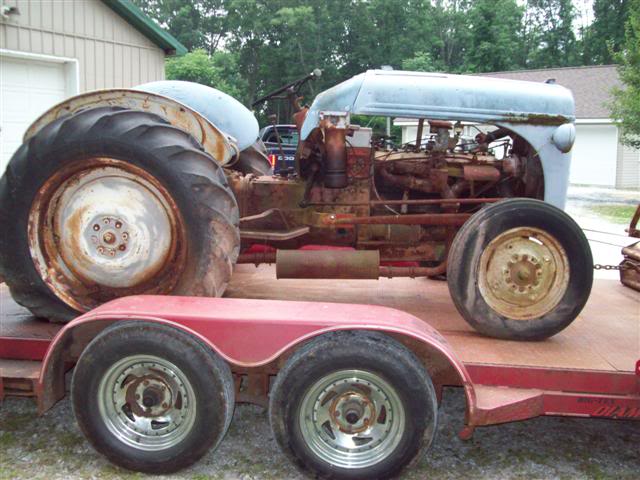

The sherman funk six cyl was an industrial or ford truck engine. parts are still around but higher price than 9n/2n/8n parts. Here a shot of my 8n 100_1686Small[1].jpgfunk when I bought it home.
