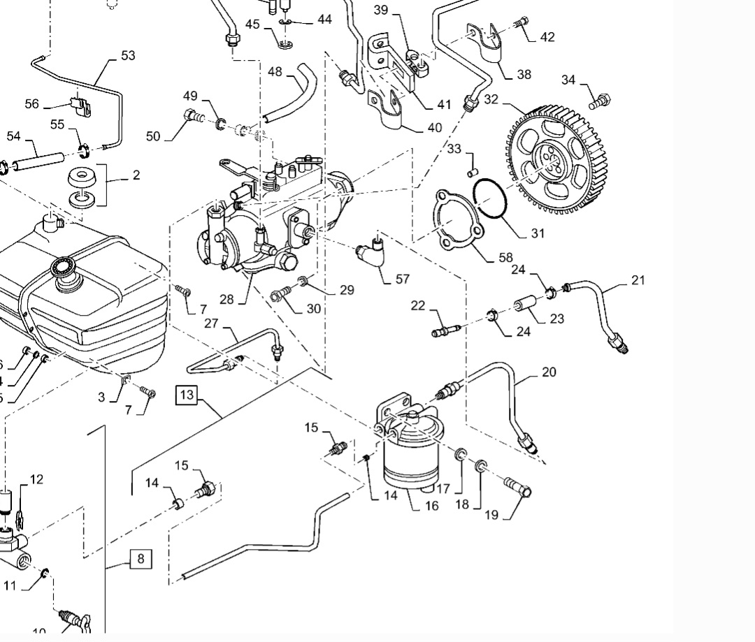

I trying to confirm this is serial # and determine year of tractor 2600
D5NN 6015 F I’m trying to order the return fuel line from fuel filter to fuel pump
Thanks Hal Woodville Tx 9-1-6 and 747- and 9818

Hal, the numbers are stamped into the bell housing RH flat behind the starter. The number you showed is just the engine casting number.
All you really need to know for the line, if it is diesel, is whether you have a single or dual fuel filter setup.
Attached is the parts illustration showing #20, I think you are asking about.

After looking at the price NH wants for that line, might we ask why you are needing/replacing it? A lot can be done with fuel line, hose clamps and the old fittings
/ Ford 2600 decipher s/n number #6
Your talking about a return line... nothing special about it. Get some copper or steel brake line and make it yourself. You could use rubber hose but that would not be my preference.
